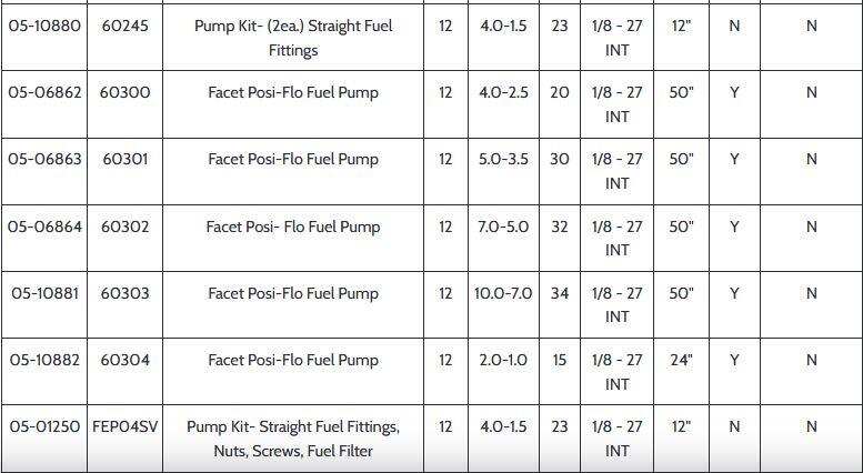

pfrederi 20,892 #2 Posted November 22, 2020 (edited) I run 1.5 -4 on several Kohlers. Some people would prefer a lower PSI there is 1-2 psi version of the Facet posiflo made in USA i have had good service from all of them. I did not have good luck with Chicom versions.... Edited November 22, 2020 by pfrederi 1 Share this post Link to post Share on other sites
