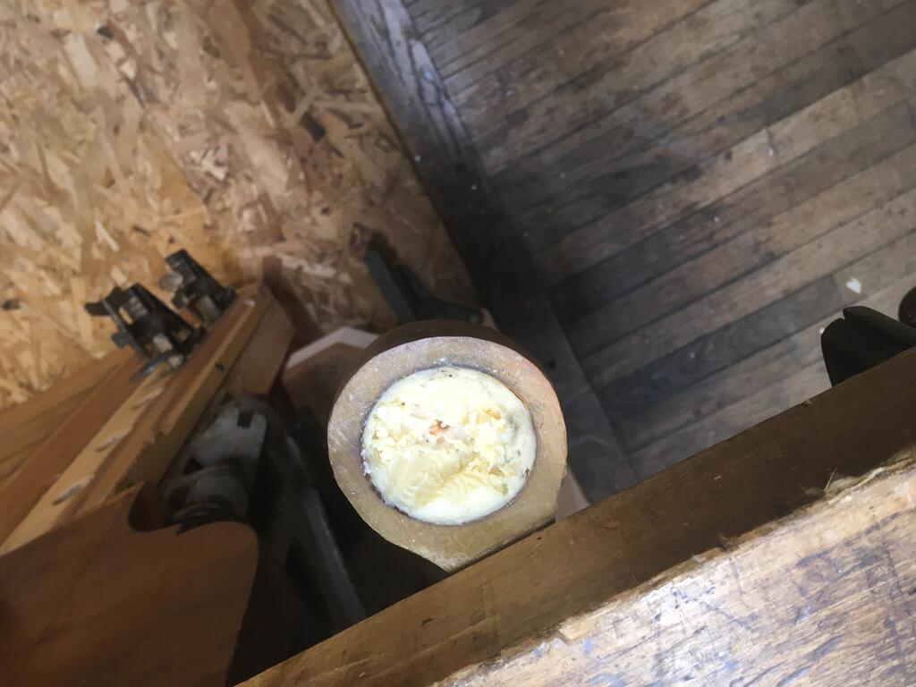

ebinmaine 63,081 #1 Posted November 22, 2020 I have a drill press (no name) that was bought by my Grampa (new?) Sometime in the 60s or 70s, I think. I'll be moving it from the outdoor workshop to the basement workshop so it's more handy and a better temperate environment being heat and humidity controlled. Also, no @#$_&-+/!!! Mice in the basement. The main vertical shaft that holds the work table has a thin coating of rust. Just 3 or 4 years ago I removed all the rust and sprayed it with WD-40. Clearly that was not the correct thing to do. What should I use to coat that shaft that won't attract much dust and be a decent lubricant? Share this post Link to post Share on other sites

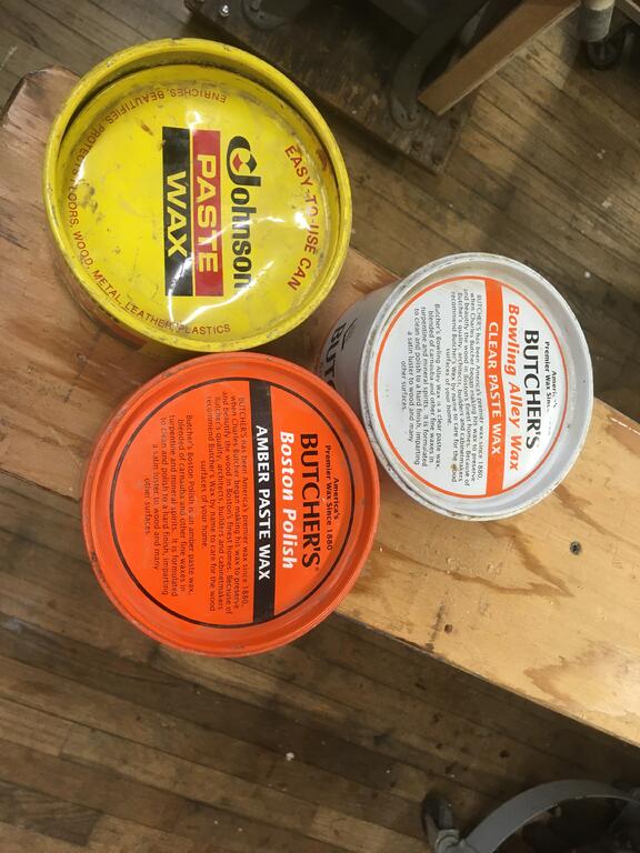

formariz 11,849 #2 Posted November 22, 2020 (edited) You can do the same thing I do on table saw top. After cleaning it I use paste wax. Let dry and buff it throughly. Material slides nicely through it, will not rust if something spills on it ( biggest problem here are coffee cups). I re wax it usually every month. All tool metal surfaces are treated like that. Edited November 22, 2020 by formariz 3 1 Share this post Link to post Share on other sites
Kenneth R Cluley 480 #3 Posted November 22, 2020 Good old paste wax, use it on all tool surfaces, table saw , etc. works even in FL with high humidity. 1 Share this post Link to post Share on other sites
JAinVA 4,619 #4 Posted November 22, 2020 Paste wax for wood working machines is a must. Car wax has silicones that may cause issues if picked up by wood. A good car wax would do fine for protecting the column of floor mounted drill press. 1 Share this post Link to post Share on other sites
roadapples 6,981 #5 Posted November 22, 2020 Had a friend who used paste wax on his guns instead of oil. Didn't have to whipe them down after every handling.. 2 Share this post Link to post Share on other sites
formariz 11,849 #6 Posted November 22, 2020 (edited) Paste wax is a much forgotten finish also extremely useful as a lubricant and for metal protection. It’s used here on a daily basis. From tool tops table saw blades, screw lubricant, plane sole lubricant,hand saw lubricant ,end grain sealant , you name it . I go through dozens of containers every year. Edited November 22, 2020 by formariz 2 1 Share this post Link to post Share on other sites
