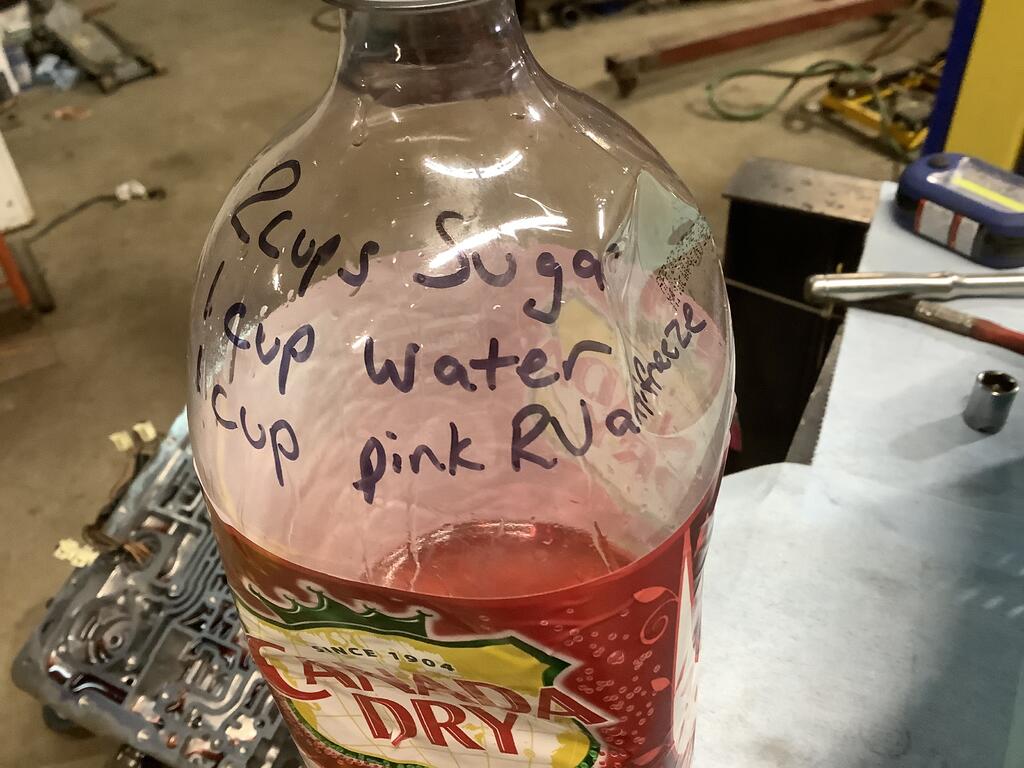

Pullstart 69,875 #34 Posted November 29, 2020 4 minutes ago, ebinmaine said: I've heard or read somewhere about putting the tire and wheel being filled on top of a rim of similar size. This lets the tire sag a little if it can thereby getting more fluid in. Please keep us posted as to how much fluid you're able to put in. I'd be curious to see if it's more than the Rimguard charts. My 6.70-15 rears charted at 7 gallons each so that's what I was billed for but the guy said it was "all o' that". because I can cheat and have the tire machine, I’ll bead seal the one side, seat the tire and wheel, then break down just the unsealed side. It’ll be a process, but I feel like it’ll be well worth it. Having 2 spare cases of RV antifreeze after winterizing the pool and camper, I have enough to play around with. I still intend to do some water/sugar playing around and also RV antifreeze/sugar too. My 27x7.50-12 tires took close to 9 gallons each. As you mentioned, each gallon might have the ability to dissolve 8 more lbs of sugar within. I will try with the antifreeze too. Imagine about 18 lbs / gallon, and the possibility of fitting over 10 gallons per tire in. That’s 360 lbs of traction adder. With that said, I probably don’t need to worry about a limited slip differential in that machine, I’ll want to have some slip if the need arises. 1 Share this post Link to post Share on other sites

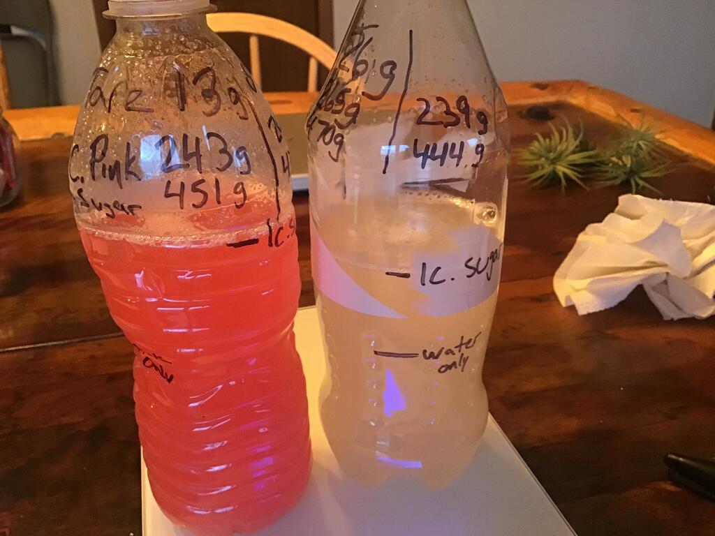

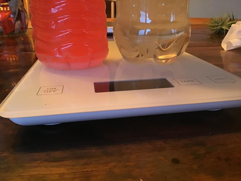

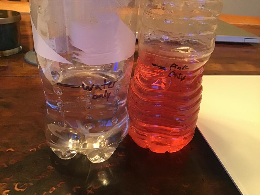

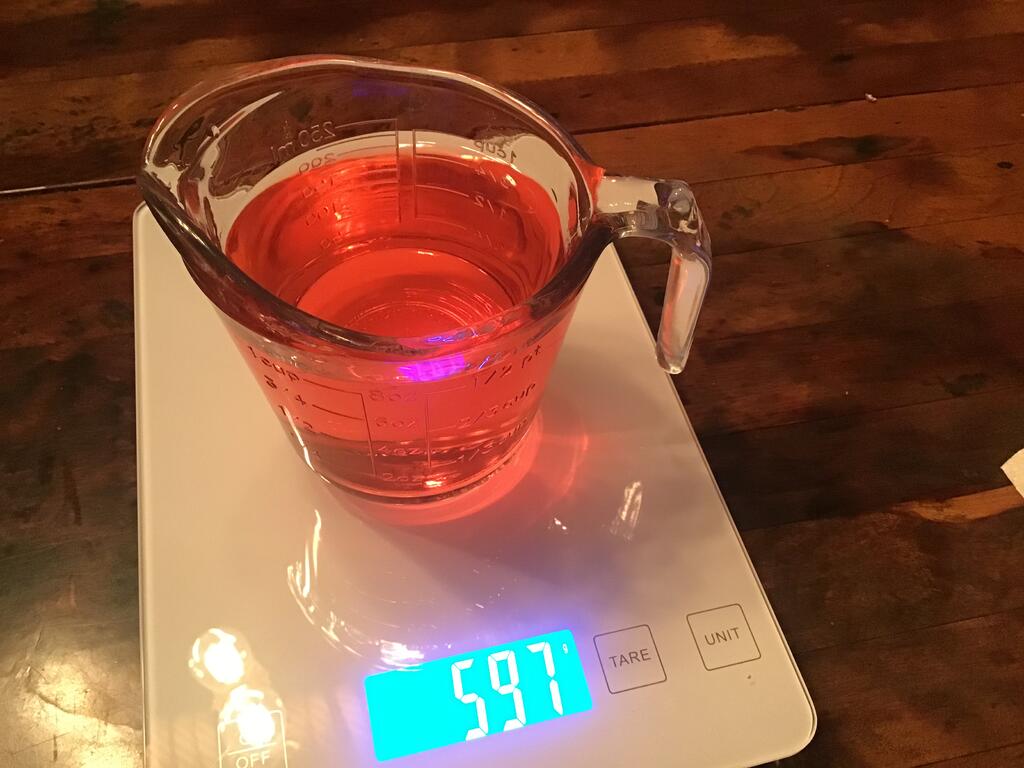

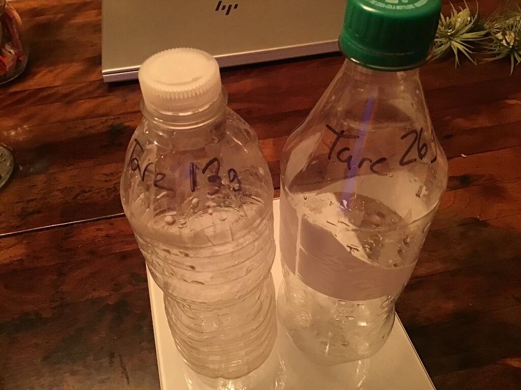

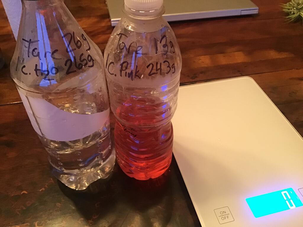

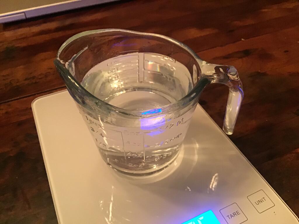

Pullstart 69,875 #40 Posted December 1, 2020 So... sugar does take up some room. RV antifreeze pretty much weighs as much as water. It cannot saturate as much sugar. 1 cup water saturates ALMOST all of 1 cup sugar. RV antifreeze does not. I’ll stick these both in the freezer for a few days and see what happens. 3 Share this post Link to post Share on other sites
ebinmaine 78,551 #41 Posted December 1, 2020 49 minutes ago, pullstart said: So... sugar does take up some room. RV antifreeze pretty much weighs as much as water. It cannot saturate as much sugar. 1 cup water saturates ALMOST all of 1 cup sugar. RV antifreeze does not. I’ll stick these both in the freezer for a few days and see what happens. Kevin if you haven't already got that stuff in the freezer it might not be a bad idea to put the sugar water in a blender or food processor type machine for about a minute and see if it shrinks. I say that because I know from past experience if you add SALT to water it isn't thoroughly mixed until the water goes back to CLEAR. I do NOT know if sugar does the same thing . I do know that they are bonded in different chemical ways and that's why the salt water temperature freezing point is so much lower. The sugar according to what I was reading, should prevent the water from freezing until something in the area of 10° F above zero. Thanks for taking the time to do this experiment. Hopefully your kids are getting science credit for it. 1 1 Share this post Link to post Share on other sites
Pullstart 69,875 #42 Posted December 1, 2020 4 minutes ago, ebinmaine said: Kevin if you haven't already got that stuff in the freezer it might not be a bad idea to put the sugar water in a blender or food processor type machine for about a minute and see if it shrinks. I say that because I know from past experience if you add SALT to water it isn't thoroughly mixed until the water goes back to CLEAR. I do NOT know if sugar does the same thing . I do know that they are bonded in different chemical ways and that's why the salt water temperature freezing point is so much lower. The sugar according to what I was reading, should prevent the water from freezing until something in the area of 10° F above zero. Thanks for taking the time to do this experiment. Hopefully your kids are getting science credit for it. I actually did this one myself, before the sleeping beauties arose from their beds... thank you very much! Great idea to better mix it! For now, I am going to try to do this as back yard shade tree as I can. In large scale, I’d like to do this in the shop, plus I’m sure Mrs. P would appreciate me NOT sticking RV pink in the Ninja blender 1 Share this post Link to post Share on other sites

Pullstart 69,875 #44 Posted January 5, 2021 On 12/1/2020 at 8:12 AM, pullstart said: So... sugar does take up some room. RV antifreeze pretty much weighs as much as water. It cannot saturate as much sugar. 1 cup water saturates ALMOST all of 1 cup sugar. RV antifreeze does not. I’ll stick these both in the freezer for a few days and see what happens. As the world turns.... these are the days of our lives! I pulled these out of the freezer the other day. I have since thawed the slushy sugar water, mixed the two solutions and today put them back in the freezer. The digital display in the freezer says -4. I’ll check it again soon. 1 Share this post Link to post Share on other sites
ebinmaine 78,551 #45 Posted January 6, 2021 Combining a gallon of RV antifreeze with a gallon of sugar gives a total weight of 15.45 lbs. I do realize the SIZE is no longer a gallon because the sugar adds volume to the RV antifreeze. I don't know how much. According to online sources it should be somewhere around 1.6 to 1.7 times the initial volume of the RV antifreeze. So 1 gallon AF plus 1 gallon sugar = approximately 1.7 gallons of solution. Which weighs the above 15.45 lbs. Again ... All approximate numbers. That figures to a little over 9 lbs per gallon of solution weight. For those of us not near a distributor of Rimguard it's a good alternative. 1 1 Share this post Link to post Share on other sites
