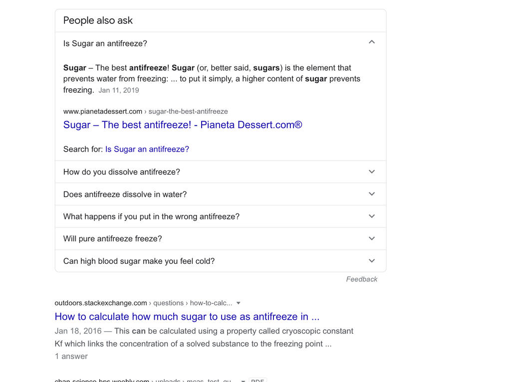

ebinmaine 81,275 #1 Posted November 22, 2020 I've searched online for information about adding sugar to water instead of salt. A chemical solution can be easily made weighing up to 13 to 15 lbs per gallon BUT it doesn't stay fluid anywhere near as cold as the Rimguard brand mix. Is there a way to figure a solution to make one's own beet juice or sugar based fluid fill and have it usable as FLUID as cold as say minus 20 or 30? What sat you Redsquare scientists?? @ecsi635j Share this post Link to post Share on other sites

ebinmaine 81,275 #9 Posted November 22, 2020 21 minutes ago, pullstart said: Ok, so how much volume does sugar take up when it dissolves? Could you add 15 lbs of sugar for each rear tire to an already stable solution, such as RV antifreeze, rimguard or otherwise? More? I found on beekeeping websites that you can add EIGHT POUNDS of sugar per gallon of water. The sugar bonds directly to the molecules of the water but it's in a slightly different manner than what salt does. The size volume does NOT increase. Not at all sure what you could do to something like RV antifreeze or washer fluid. What I am looking to do though is to do a homemade version without having to buy any fluids. Knowing I have the beet juice available in reasonably close proximity it's going to be tough for me to better that situation but sometimes curiosity just plain gets the better of me.... 1 Share this post Link to post Share on other sites

ebinmaine 81,275 #14 Posted November 22, 2020 6 minutes ago, pullstart said: Remember asking Jeeves everything? I wonder if he learned it from Google... or if Google is his prodigy? Depending on the ratio of water to sugar you can get it down to about 12 or 15 degrees ABOVE zero but nowhere near below zero as its lowest freezing point, from what I've been able to find. Share this post Link to post Share on other sites
