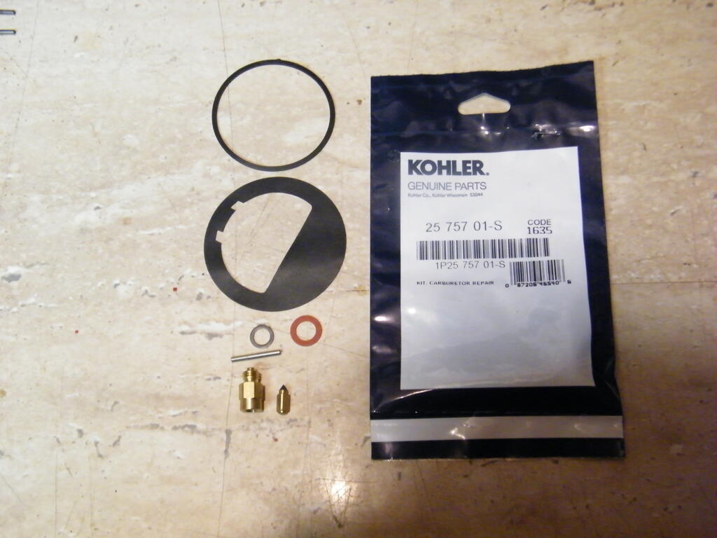

stevasaurus 23,705 #4 Posted November 21, 2020 carter "n" rebuild kit...you can see the washer. 1 Share this post Link to post Share on other sites
sqrlgtr 3,018 #5 Posted November 21, 2020 Yup took bowl off again to day no fiber washer just metal washer,found one in an extra kit I had....appreciate it fellers. 1 Share this post Link to post Share on other sites
