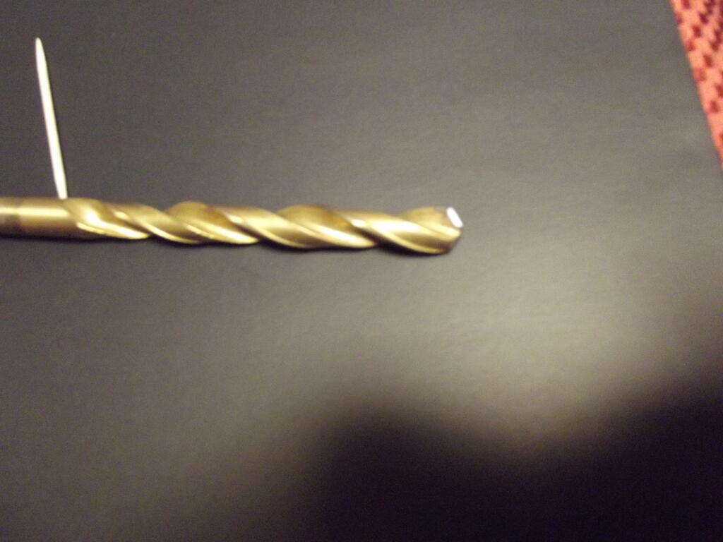

JAinVA 4,638 #1 Posted November 19, 2020 (edited) While working on a weight rack for the crane tractor I found that I needed to open up 3/8" holes to 25/64" or larger. If you ever had to drill a hole by the next size up or 2 in thin metal then you know the twist drill will grab and spin in the chuck or worse snap off the cutting edge. If you have access to a bench grinder this trick will solve that problem. Grind a flat at the cutting edges so that the drill resembles a spade drill. It will still drill and not grab. Edited November 19, 2020 by JAinVA 11 Share this post Link to post Share on other sites

JAinVA 4,638 #3 Posted November 20, 2020 (edited) Right Ed. We routinely did this to drills when working with brass or copper. Edited November 20, 2020 by JAinVA 2 Share this post Link to post Share on other sites

JAinVA 4,638 #5 Posted November 20, 2020 (edited) In steel ,pilot holes should be drilled first. Depending on the angle ground on the cutting edge by this method,,drilling in steel can be difficult This works best in steels if you need to drill a larger hole. Edited November 20, 2020 by JAinVA 1 Share this post Link to post Share on other sites
