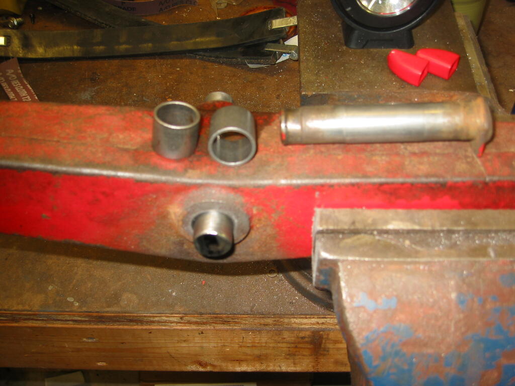

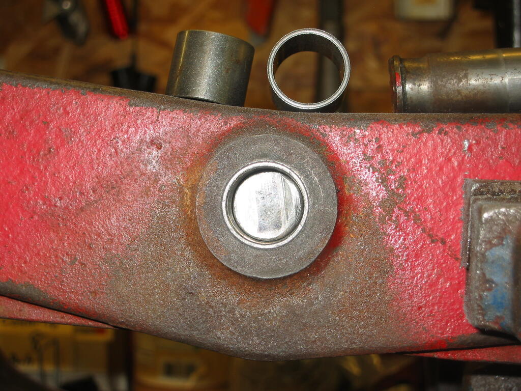

pfrederi 21,312 #2 Posted November 18, 2020 She is worn. pull the pivot pin and see if it is worn. If the pin is worn you can make a new one from 3/4" stock. The hole in the axle may also be wallowed out. You can drill it out to 7/8" and press in a couple of sleeve bearing to tighten things up. 2 8 1 Share this post Link to post Share on other sites
peter lena 10,109 #3 Posted November 18, 2020 those steel sleeves and a regular lubrication , will make it better than new , what a concept , pete 1 Share this post Link to post Share on other sites
pfrederi 21,312 #4 Posted November 18, 2020 Actually i use these sleeves. They provide additional lube. Also If anything wears over time it will be them not the axle or the pivot pin and they are cheap and easy to replace. 1 2 Share this post Link to post Share on other sites

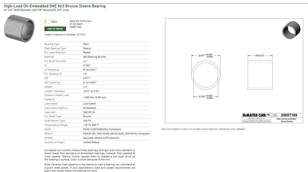

Tractorhead 9,218 #5 Posted November 18, 2020 6 hours ago, pfrederi said: Actually i use these sleeves. They provide additional lube. Also If anything wears over time it will be them not the axle or the pivot pin and they are cheap and easy to replace. Do you have any source where i can buy them. i have the same issue and thinkering about a brass or bronze adaptor ring. but this seems maybe the better solution as long as the Pin is good. Share this post Link to post Share on other sites
Crmaverick 91 #6 Posted November 18, 2020 Looks like the way to go thanks for the help. Where did you order those sleeves? Share this post Link to post Share on other sites
Crmaverick 91 #7 Posted November 18, 2020 Also is it usually the pin surface that wears out first or the axle hole surface? Share this post Link to post Share on other sites
rmaynard 17,644 #8 Posted November 18, 2020 22 minutes ago, Crmaverick said: Looks like the way to go thanks for the help. Where did you order those sleeves? Looks like McMaster-Carr http://www.mcmaster.com 1 Share this post Link to post Share on other sites
