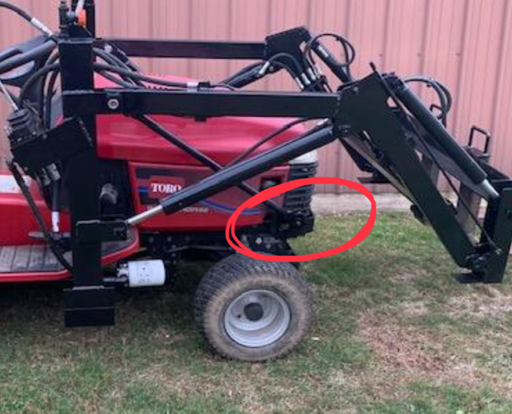

JoeM 10,317 #1 Posted November 17, 2020 Finally got around to the XI FEL build. Opted for an combination, old school D type / xi style build. I Cabbaged materials this spring and summer, with a little reverse engineering, and got the build together. For now it is about 85%, I need to finish the bucket and some paint. The bucket is going to be an easy mount, not necessarily a quick mount. I have a set of forks to swap out with the bucket. I actually use the forks on my 520 way more then the bucket and wanted the forks mounted to the loader frame rather then the bucket clip on ones I have now. Keeps the load closer. Notes, I found a pretty nice 25 micron suction filter at the surplus center and picked up most of the hydraulic parts there. Steel tubing looks nice but is not any cheaper than hose by comparison. Here is a few pics I will post the completed pics in a couple weeks. 4 14 Share this post Link to post Share on other sites

DET 113 #4 Posted November 17, 2020 Looks real good, is the hyd. pump a direct drive? Share this post Link to post Share on other sites
Pullstart 71,367 #6 Posted November 17, 2020 28 minutes ago, DET said: Looks real good, is the hyd. pump a direct drive? the PTO on the XI series is on the front of the engine. This looks to be right underneath, so the PTO can still be utilized. @JoeM You’ve done real well on this build! 1 Share this post Link to post Share on other sites
ebinmaine 80,951 #7 Posted November 17, 2020 Wicked Awesomeness 1 1 Share this post Link to post Share on other sites
shallowwatersailor 3,222 #8 Posted November 17, 2020 2 hours ago, pullstart said: the PTO on the XI series is on the front of the engine. This looks to be right underneath, so the PTO can still be utilized. @JoeM You’ve done real well on this build! It appears to be a mule drive from the PTO to drive the hydraulic pump. That is how the manufactured FELs for the 5xi were designed. 1 1 Share this post Link to post Share on other sites
JoeM 10,317 #9 Posted November 17, 2020 3 hours ago, pullstart said: PTO I used a belt to drive the pump, Thanks! Share this post Link to post Share on other sites

JoeM 10,317 #13 Posted November 19, 2020 On 11/17/2020 at 7:27 PM, DET said: I mounted mine in a pulley box. I didn’t realize there was a bracket for the pump. @top_cat had this bracket posted and knowing i was going to build was able to snag it. It is an odd set up. The engine in the xi's set at an angle with the front higher then the back. Figure it is to align the drive shaft. the original plan was to fabricate some kind of pump bracket. The pic's are when I was figuring the pulley size, alignment and belt needed. 2 Share this post Link to post Share on other sites

JoeM 10,317 #20 Posted April 1, 2021 I used the existing bumper bolts and bolted a piece of angle iron on and welded a vertical piece to accept the tubes. You can't see it but there is a gusset underneath welded to the angle. 2 1 Share this post Link to post Share on other sites
Pullstart 71,367 #21 Posted April 1, 2021 Nice! I think I have enough 2x4x1/4” tubing, I might get crafty and see about building a bumper. 2 Share this post Link to post Share on other sites
