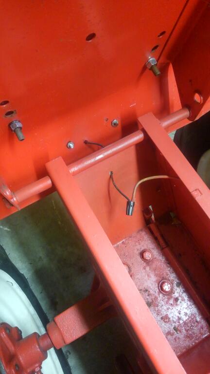

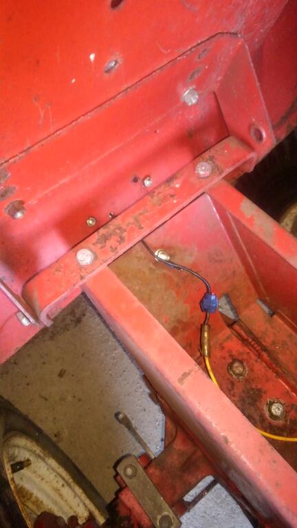

Rusty Tinsnips 477 #1 Posted November 16, 2020 First pic is from a 1971 Raider 10 and has the rod across that the seat bolts onto and is the hinge point. Second pic is a 1972 Raider 14 that does not have the rod, the seat hinges on the bolts going through that flat bar and wobbles around like crazy. The question is, do I need some kind of bushing around the bolts? Or bigger bolts or is there some part missing? Share this post Link to post Share on other sites
roadapples 6,987 #2 Posted November 16, 2020 Bottom pic should have bushings on bolts... 2 Share this post Link to post Share on other sites
Rusty Tinsnips 477 #3 Posted November 16, 2020 (edited) 2 hours ago, roadapples said: Bottom pic should have bushings on bolts... I thought so, do you happen to know what size they are? Just ordered some from Wheel Horse Stables along with some other goodies. Edited November 17, 2020 by Rusty Tinsnips Share this post Link to post Share on other sites
Rusty Tinsnips 477 #4 Posted November 17, 2020 Still need the spacers part # 4937. Can't find them anywhere , they are discontinued. I can't find an image of them. Can anyone tell me what they look like? Wait, A to Z had 3 (used) left in stock for $1.00 each, but no picture. Share this post Link to post Share on other sites
oliver2-44 11,825 #5 Posted November 17, 2020 Check you hardware store with all the little speciality drawers. On my C-160 I think I used 3/8 inside by 1/2” outside by 3/8 long Brass bushings 2 1 Share this post Link to post Share on other sites
