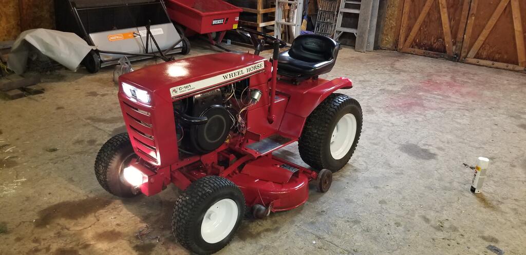

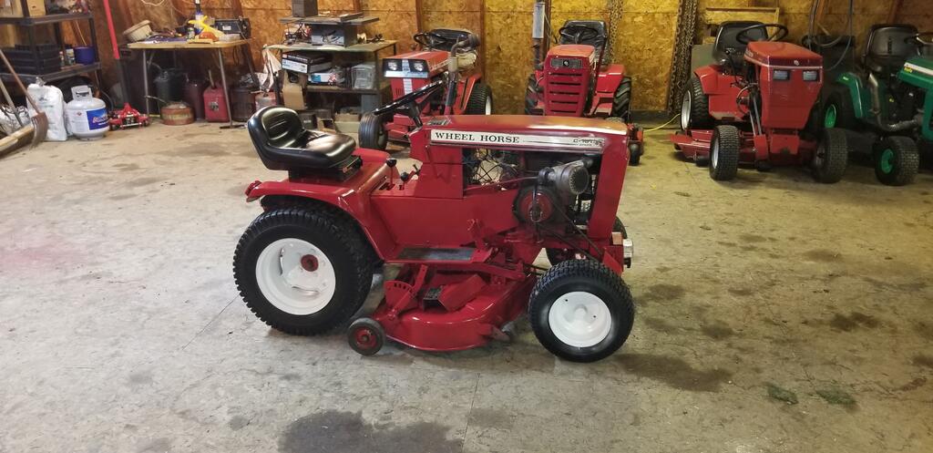

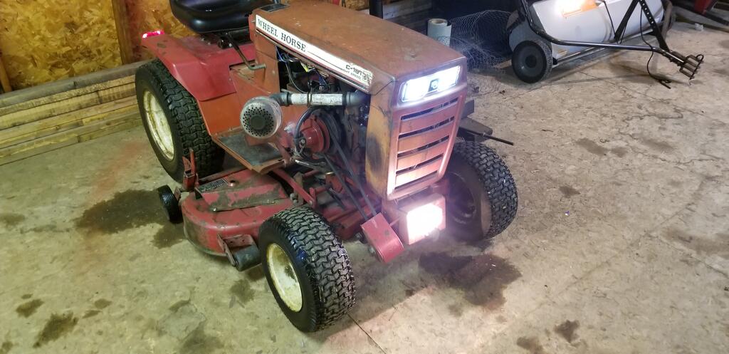

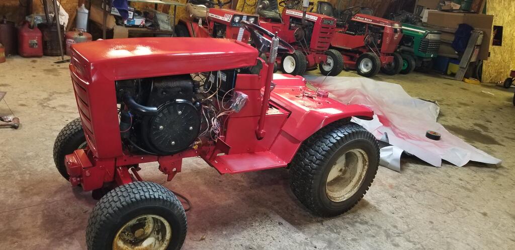

BrianX128 115 #1 Posted November 15, 2020 So this weekend I decided to restore the "Ugly Duckling" as my wife named one of our riding mowers. Given that our other mowers are all "nice" looking with the exception of the Lawn Rov'r having a seat that is made primarily of duct tape I wasn't super concerned with having this one be "show quality" since it's the mower that is going to be doing the snow blowing, and tilling in spring. It's already 3 different pieces of horses I got from craigslist / fb that were "spare parts" I got in the deals for engines and attachments that I got told by the wife to get rid of and instead spent more money and made an extra mower out of. It's at least nice having said mower because I hate getting the good riding mowers in the mud and snow, but anyways like anything you go to restore the moment I started sanding I couldn't stop and the paint job actually came out really nice. I even lazily sprayed carb cleaner on the axles and got all the grease off and hand sanded them a bit and got everything nice and international harvester rattle can red except under the battery where my horrid nest of wires to make gauges, fuel pumps, lights, voltage regulators, and other stuff happy currently lives. I need to zip tie it all back together you'll get the idea.. From this.. To this.. I don't have a picture of the rear discharge deck or the mower with all the tape removed for the decals, and I need new decals as it's not a C161 anymore, but now I'm disgusted with how ugly these rims are after I saw the mower outside with paint and so.. I tried to sand those by hand and paint them while on the tractor, I got duct tape around the edge of the rim and hit them with some rusty metal primer first and it's so bad I don't even want to post the picture on here. I tried to do 3 light coats but the paint just doesn't want to stick to anything and streaks. I'm not sure if there is a better paint to try and use for rims or if I should have skipped the primer but I'm thinking I'm going to have to put the mower on jack stands and take the wheels off and figure out some sort of better way to sand them than hand sanding. I wouldn't even care but I'm not trying to leave the wheels look this horrid. I was only trying to hit the visible side of the rims as this thing is going to get dirty often, I need new rear tires on it anyways as these are dry rotted so I may take them off and try a re-do but if anyone has any tips for how to do rims short of sand blasting them I'm all ears. 3 Share this post Link to post Share on other sites

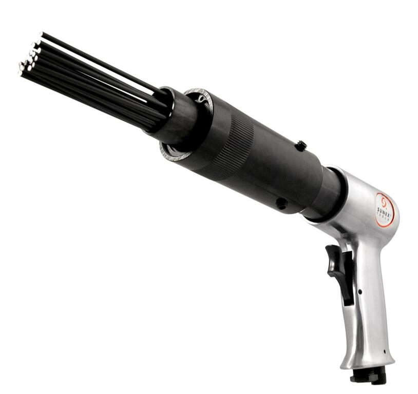

AMC RULES 37,259 #5 Posted November 15, 2020 Being that you have air capabilities, one of these needle scalers may be a better option than sticking your hand into a rotating rim at max rpm. They do a pretty thorough job and can be had quite cheaply on many of most all of the online sites. 6 Share this post Link to post Share on other sites

BrianX128 115 #7 Posted November 15, 2020 4 minutes ago, AMC RULES said: Being that you have air capabilities, one of these needle scalers may be a better option than sticking your hand into a rotating rim at max rpm. They do a pretty thorough job and can be had quite cheaply on many of most all of the online sites. I'm embarrassed to say I have one of those amongst all my grandfathers old tools and had no idea what it was for. Always assumed it was a half broken old tool he kept for spare parts. No idea if it still works but 99% of the old tools he had are still kicking so I'm guessing it does. This would definitely help me on the rear wheels in the center. 3 1 Share this post Link to post Share on other sites
AMC RULES 37,259 #8 Posted November 15, 2020 Put 15 minutes with this tool into each rim, then a little bit of hand sanding after, and you'll be all set. Same process that produced these restored wheels you see here. 2 2 Share this post Link to post Share on other sites
ebinmaine 79,740 #9 Posted November 15, 2020 34 minutes ago, BrianX128 said: rear wheels in the center Definitely. 2 minutes ago, AMC RULES said: Put 15 minutes with this tool into each rim, then a little bit of hand sanding after, and you'll be all set. Same process that produced these restored wheels you see here. The rears on Colossus are off a camper. They were really rough. The tool I have is slow and smaller and also not quite enough air flow and even with all that I had about an hour in each wheel and had decent results. Needle scalers are certainly handy. Just be patient. Share this post Link to post Share on other sites

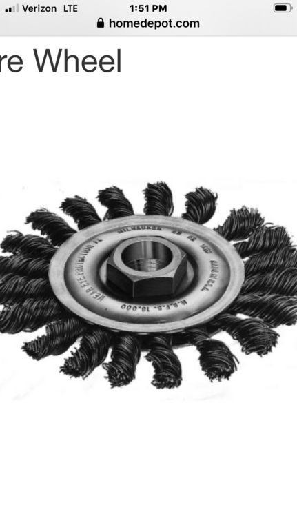

The Tuul Crib 7,354 #12 Posted November 15, 2020 I have been using what I called the wheel of death. You don't want to look straight into it only stand back! It stripped it down quick with a 4 inch grinder 3 Share this post Link to post Share on other sites
8ntruck 9,070 #13 Posted November 15, 2020 Notice, the max rated RPM on that wheel looks to be 10,000 RPM. It is likely to come apart if used in a grinder that runs faster. Assuming a 4 1/2" diameter, the broken pieces would be moving about 200 feet per second when they come off. 2 Share this post Link to post Share on other sites

BrianX128 115 #15 Posted November 15, 2020 (edited) So I fired up the big compressor and used my "new" tool and put a wire brush attachment on a air based drill chuck and spun the wheels by hand while moving the wire drill in and out. I only did one side of the rims because I'm horribly impatient and wanted to see what it looked like being "done". I'm gonna pop the wheels off this week one at a time and do the other sides but I think it looks great. Edited November 15, 2020 by BrianX128 2 8 Share this post Link to post Share on other sites
