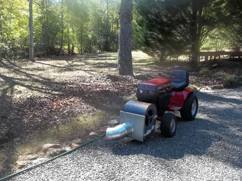

953 nut 69,825 #2 Posted November 14, 2020 Not a walk behind but I mounted a blower from a heat/AC unit to a mule drive. 3 7 Share this post Link to post Share on other sites
ebinmaine 80,957 #3 Posted November 15, 2020 16 hours ago, 953 nut said: Not a walk behind but I mounted a blower from a heat/AC unit to a mule drive. Can you rotate that pipe or is it a one way air flow? Share this post Link to post Share on other sites

8ntruck 9,348 #5 Posted November 15, 2020 On 11/14/2020 at 5:49 PM, 953 nut said: Not a walk behind but I mounted a blower from a heat/AC unit to a mule drive. Adding a reducer section to the outlet end of the elbow would increase the air velocity out of the blower. Share this post Link to post Share on other sites
953 nut 69,825 #6 Posted November 16, 2020 7 hours ago, ebinmaine said: Can you rotate that pipe or is it a one way air flow? I could if needed but I make one pass up the driveway and another pass down and the driveway is cleared. 6 minutes ago, 8ntruck said: Adding a reducer section to the outlet end of the elbow would increase the air velocity out of the blower. That was my first go round bup the added volume far outperforms greater velocity. 2 Share this post Link to post Share on other sites
cschannuth 3,821 #7 Posted November 16, 2020 On 11/14/2020 at 5:49 PM, 953 nut said: Not a walk behind but I mounted a blower from a heat/AC unit to a mule drive. Is it just attached to the front hitch? I have the blower but need to fab the mount. Thanks Share this post Link to post Share on other sites
953 nut 69,825 #8 Posted November 16, 2020 6 minutes ago, cschannuth said: Is it just attached to the front hitch? I have the blower but need to fab the mount. Thanks I welded the frame that holds the blower to an old mule drive. 1 1 Share this post Link to post Share on other sites
