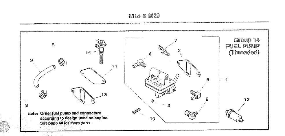

Billyboy 2 #1 Posted November 14, 2020 Hi All from the UK, following years of starting problems with both my 418c and 520h I am going to bite the bullet and fit Facet low pressure electric fuel pumps to both. I have read up the subject on these excellent forums and am grateful for the sage advice therein particularly about correctly wiring and using a relay and various fuses. A couple of questions however. Firstly, on the 418c with a Kohler 18 Magnum twin. I have changed the original fuel pump a couple of times and it has failed again. When I reroute the fuel pipe what should I do to the open pipe connections on the old diaphragm pump which will remain in situ? The arm in the old pump is driven internally by a rotating shaft and is presumably splash oiled. So I assume that, should the diaphragm ever split, oil could find its way out of the pump unions unless they are blocked off? Any advice from anyone who has done that would be gratefully received. On the 520h Onan I'm not sure what drives the pump but I think it is vacuum with a pipe behind it when it is removed. Again is it recommended to just simply block off the vacuum pipe or with that potentially cause all sorts of pressure and breather issues in the engine? Any advice gratefully received, thanks. Share this post Link to post Share on other sites
squonk 46,835 #2 Posted November 14, 2020 I have left them on with no issues but I would rather plate the opening with a gasket. Share this post Link to post Share on other sites
Billyboy 2 #3 Posted November 14, 2020 Thanks Mike, did you block off the holes where the original fuel lines connected to? Share this post Link to post Share on other sites
pfrederi 20,657 #4 Posted November 14, 2020 You can make your own cover plate and reuse the gasket in there now or buy a cover plate # 240282 Share this post Link to post Share on other sites
Bill D 2,877 #5 Posted November 14, 2020 I would replace the pump on the Kohler with a Briggs vacuum pump P/N 808656. Make a blank off plate and gasket and tap a hole for a 1/8" pipe thread and install a hose barb fitting. Find a spot to mount the pump on the engine. Consider doing the same for the 520 if the OEM pump is failing. The 520 would be easier to convert to an electric pump. Power could be supplied to the pump from the positive terminal on the coil. The pump would shut down if the engine is shut down by the safety switches. This is harder to do on the 418 since it has a magneto ignition. If the engine is shut down by the safety switches the pump would still be running which could be dangerous. I have had good luck converting two Kohler M12's to vacuum impulse pumps using the Briggs pump. Bill Share this post Link to post Share on other sites

wallfish 20,031 #8 Posted November 15, 2020 Most of the time the fuel pumps fail because the check valves inside fail to check the flow and allow fuel flow in both directions. Removing the pump and covering with a plate is probably the right way to do it but I just add the new electric pump into the fuel line between the tank and the old pump and leave the old pump in place. No issues. Share this post Link to post Share on other sites
peter lena 9,899 #9 Posted November 15, 2020 agree with above on the pump swap, I also used a Kohler blocking plate , also used the CARBOLE MICRO ELECTRIC FUEL PUMP , found it a much better quality unit as compared to the first pump I tried , a very solid secure mount is vital for zero noise. also went over to fuel rated clear lines . pete Share this post Link to post Share on other sites
