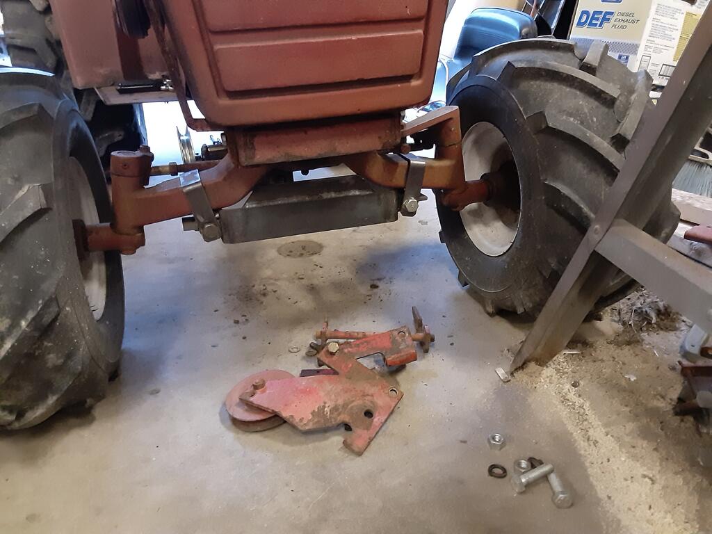

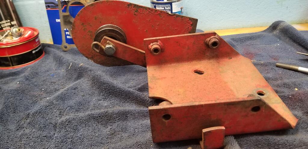

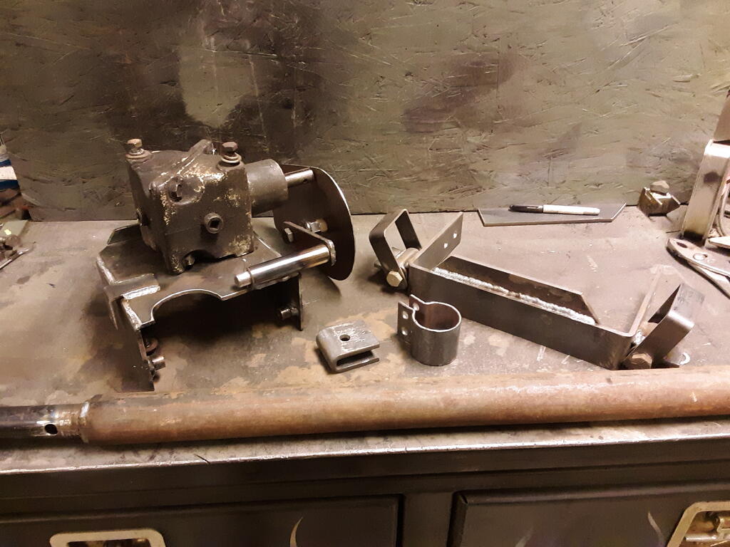

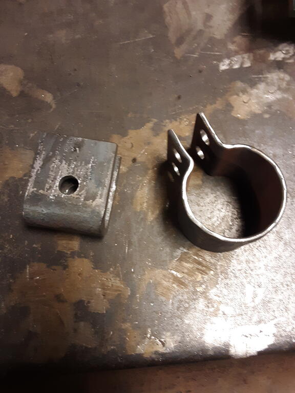

Oldskool 6,678 #51 Posted February 10, 2021 Here is what I have so far. 3 1 Share this post Link to post Share on other sites
Oldskool 6,678 #52 Posted February 10, 2021 @gt14rider I think the only pieces to make now are a few pins and the mount with the rubber that attaches to the hitch. I dont have any measurements for that do you? I have 2 of the 3 pieces made. Share this post Link to post Share on other sites

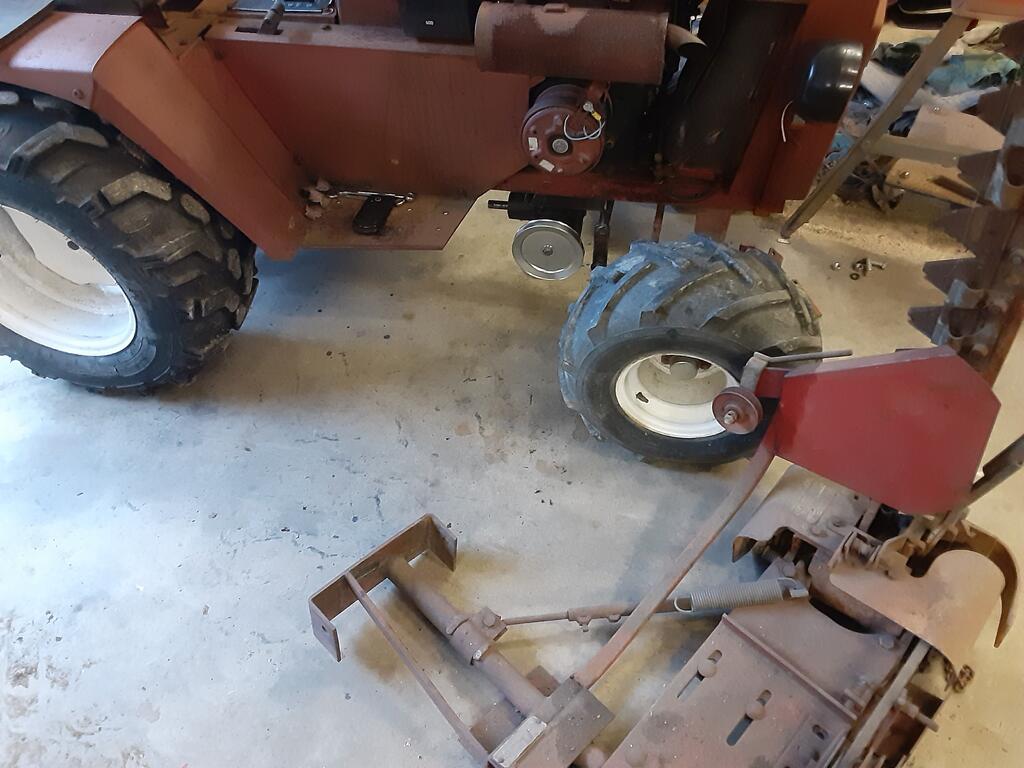

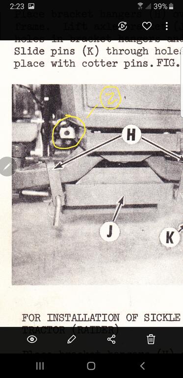

Oldskool 6,678 #60 Posted February 12, 2021 Just now, gt14rider said: The pulley should be in the front so should have clearance, Oh ok. That's good. Thanks. Is there a second hole in that belt gaurd? It looks like there is in this pic. Share this post Link to post Share on other sites

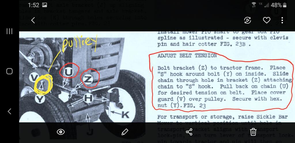

gt14rider 1,281 #62 Posted February 12, 2021 Chain (U) hooks to s hook then to frame . Should have plenty of room Share this post Link to post Share on other sites
Oldskool 6,678 #63 Posted February 12, 2021 1 hour ago, ebinmaine said: Mike what exactly are you looking for? I'll check my parts boxes from the auction. A 2.5" 1/2 bore v grooved idler with integrated bearing. 1 Share this post Link to post Share on other sites
Oldskool 6,678 #64 Posted February 12, 2021 1 hour ago, gt14rider said: Chain (U) hooks to s hook then to frame . Should have plenty of room Thats the tension on that belt? Huh. Is there a spring Im not seeing? Share this post Link to post Share on other sites
gt14rider 1,281 #65 Posted February 12, 2021 (edited) I have not got this far, have not mounted mine yet. But yes, maybe a spring, or eye bolt? Edited February 12, 2021 by gt14rider 1 Share this post Link to post Share on other sites

gt14rider 1,281 #67 Posted February 13, 2021 Pic of belt tension, looks like parts cam in (L) parts bag Share this post Link to post Share on other sites

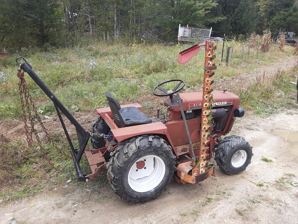

Oldskool 6,678 #68 Posted February 13, 2021 I have the mower under the tractor now. I hope to mount it this weekend 3 Share this post Link to post Share on other sites

Oldskool 6,678 #73 Posted October 2, 2021 I think it's happening guys. It's been a while, but not stopping till I'm mowing. 1 1 Share this post Link to post Share on other sites
Oldskool 6,678 #74 Posted October 3, 2021 It's on. It's working. Some fine tuning and a sharpening and it should be good to go. 20211003_152617.mp4 3 Share this post Link to post Share on other sites
