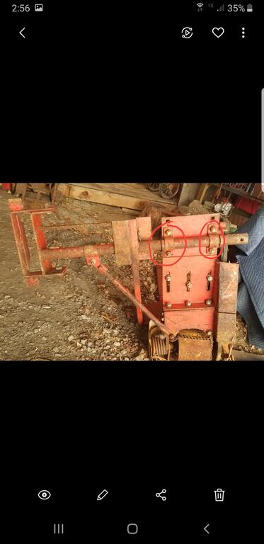

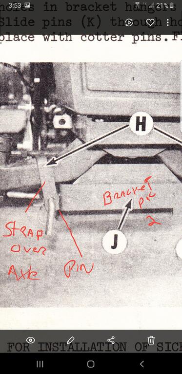

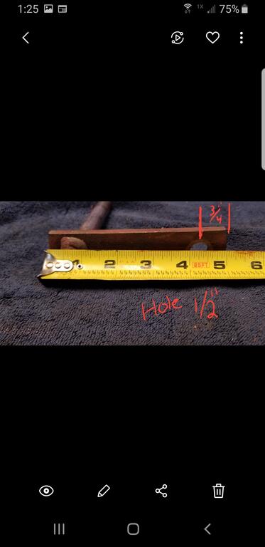

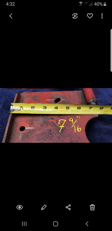

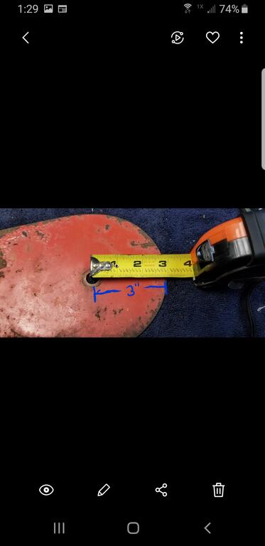

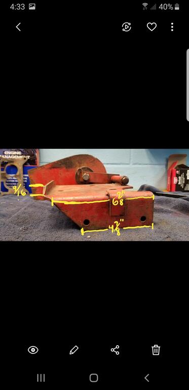

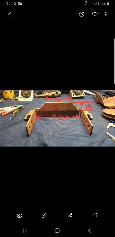

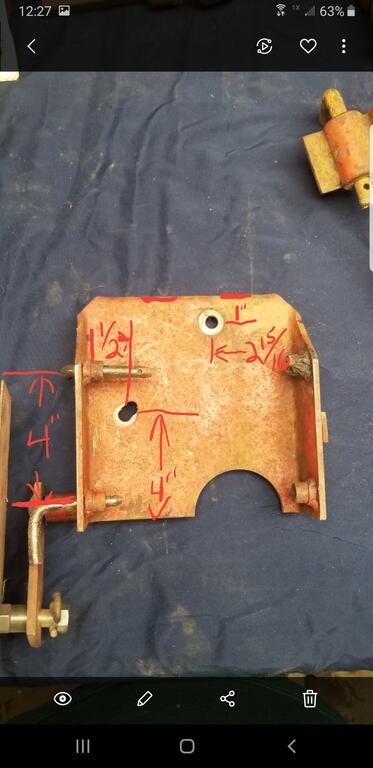

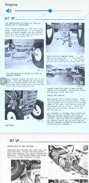

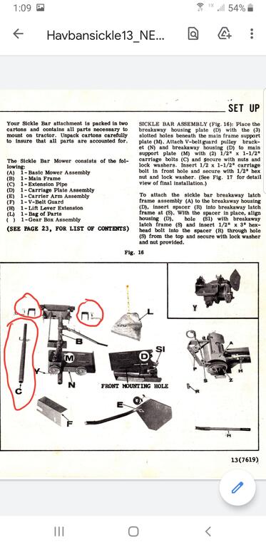

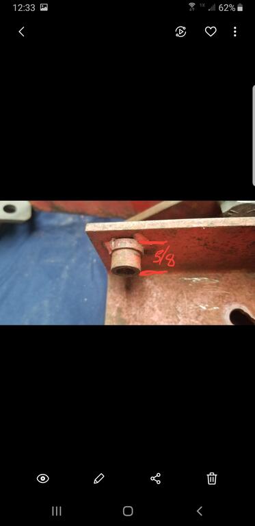

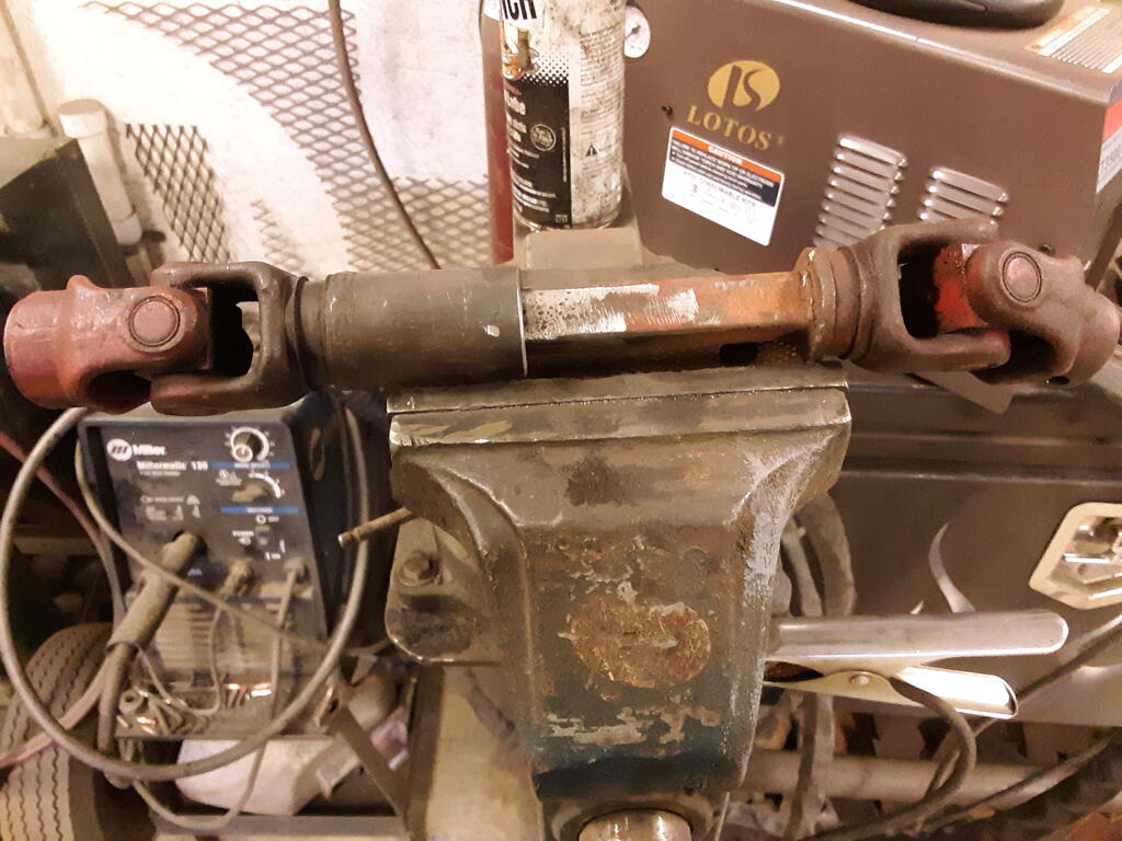

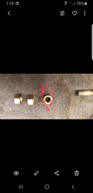

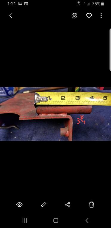

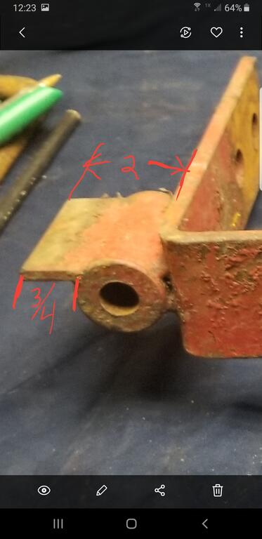

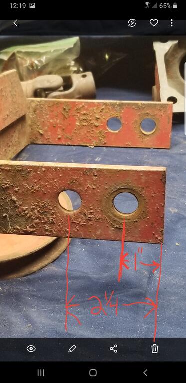

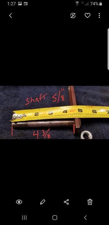

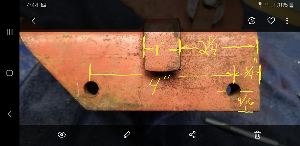

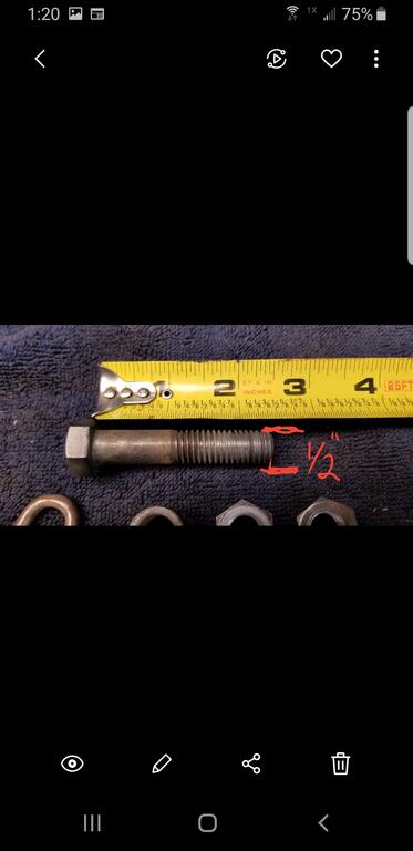

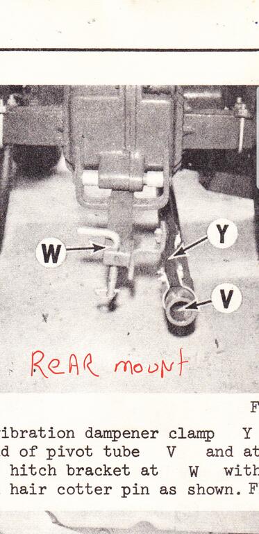

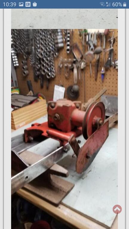

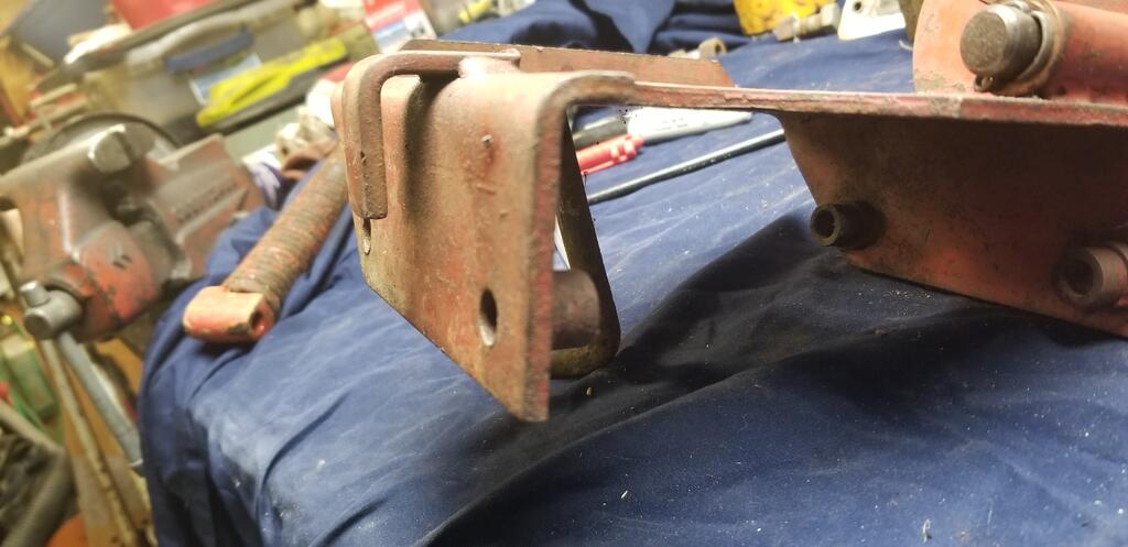

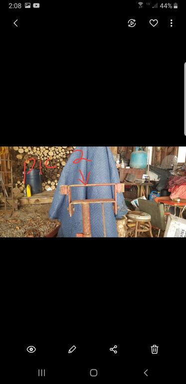

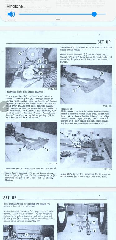

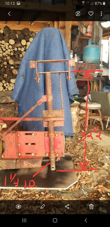

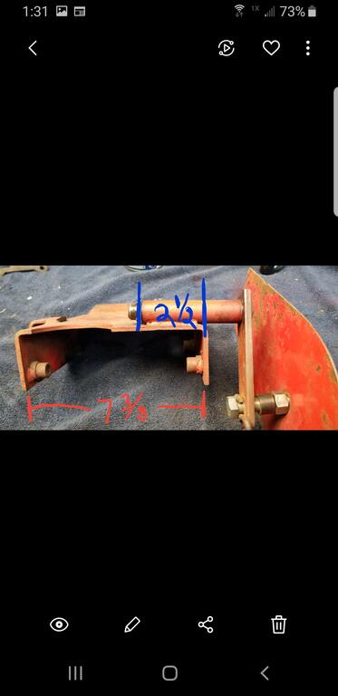

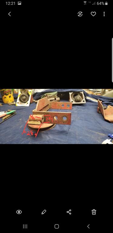

gt14rider 1,281 #27 Posted December 18, 2020 Here's some , the gear box plate uses atach-o-matic holes in frame. More to come. Rear (pipe) mount attached to rear hitch, mine is missing , but I think Aldon may have got dimensions. In one of his posts, can't find it right now. 3 Share this post Link to post Share on other sites
Oldskool 6,678 #28 Posted December 18, 2020 What parts is pic 2-6? Share this post Link to post Share on other sites

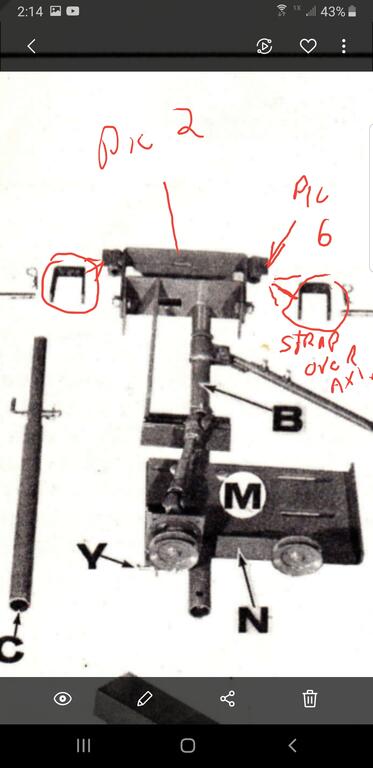

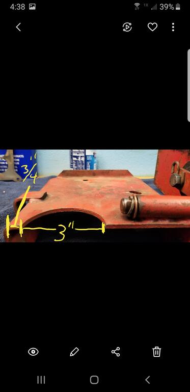

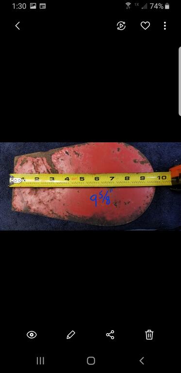

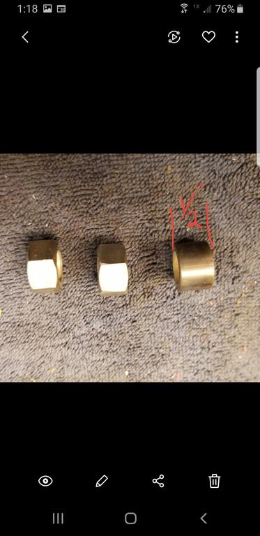

gt14rider 1,281 #29 Posted December 18, 2020 Still looking for the two axel straps, hooks over front axel and pins to bracket on sickle bar, (pics 5 and 6 above) Share this post Link to post Share on other sites
Oldskool 6,678 #31 Posted December 18, 2020 Oooh I got it now. It's making sense to me now. This is a big help for sure Share this post Link to post Share on other sites
gt14rider 1,281 #32 Posted December 18, 2020 (edited) Here's rear mount. I have never had this mounted but appears to just hang under tractor, front hangs on pin and rear is rubber mounted. Loosen these bolts to aline bracket (pic 2 )with axle Edited December 18, 2020 by gt14rider 1 Share this post Link to post Share on other sites
Oldskool 6,678 #33 Posted December 18, 2020 So it only mounts to the tractor with 3 pins? Share this post Link to post Share on other sites
gt14rider 1,281 #34 Posted December 18, 2020 Once mounted, adjust main body ,then tighten bolts 1 Share this post Link to post Share on other sites

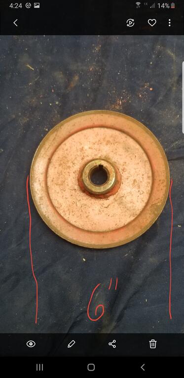

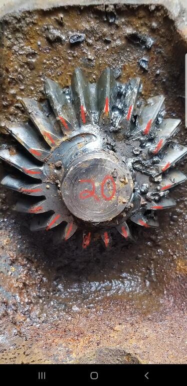

Oldskool 6,678 #35 Posted December 18, 2020 Money is getting tight this time of year for me. That being said. I have a right angle gearbox I was thinking of using for now. Do you have an idea of what the overall ratio of the original box is and pulley size? Share this post Link to post Share on other sites

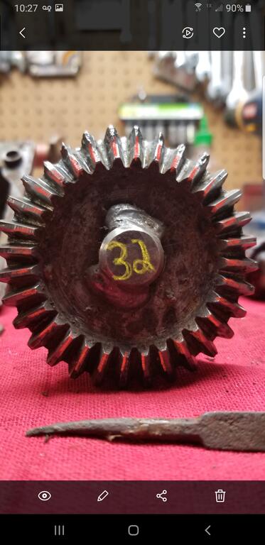

gt14rider 1,281 #36 Posted December 18, 2020 Pully 6in, 32 tooth gear (drive shaft side ) and a 20 tooth gear (pulley side). 2 Share this post Link to post Share on other sites
gt14rider 1,281 #37 Posted December 18, 2020 (edited) Gear box is 0.6 : 1 ratio Edited December 18, 2020 by gt14rider 1 Share this post Link to post Share on other sites

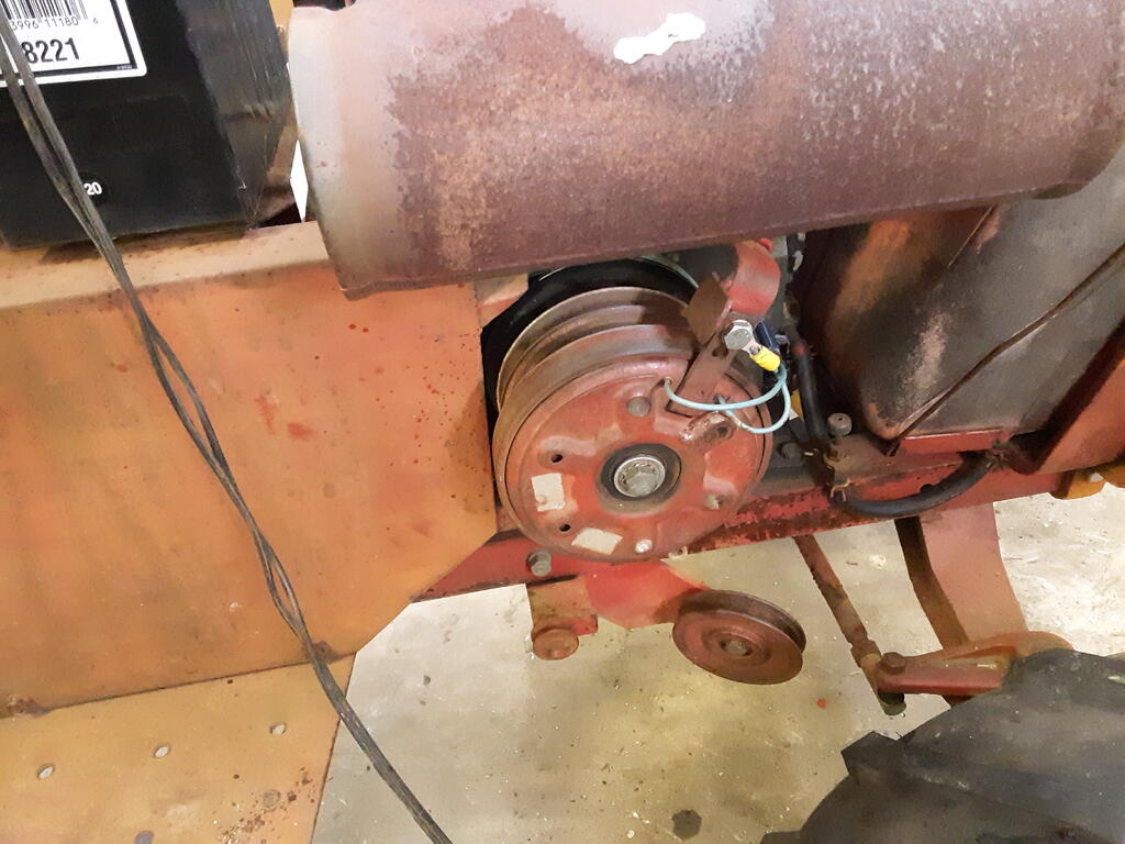

Oldskool 6,678 #39 Posted February 8, 2021 First: part of getting ready for the sickle bar mower. I put the electric clutch on that I repaired and repotted. Second: Freeing up the rusted slip shaft. 1 Share this post Link to post Share on other sites

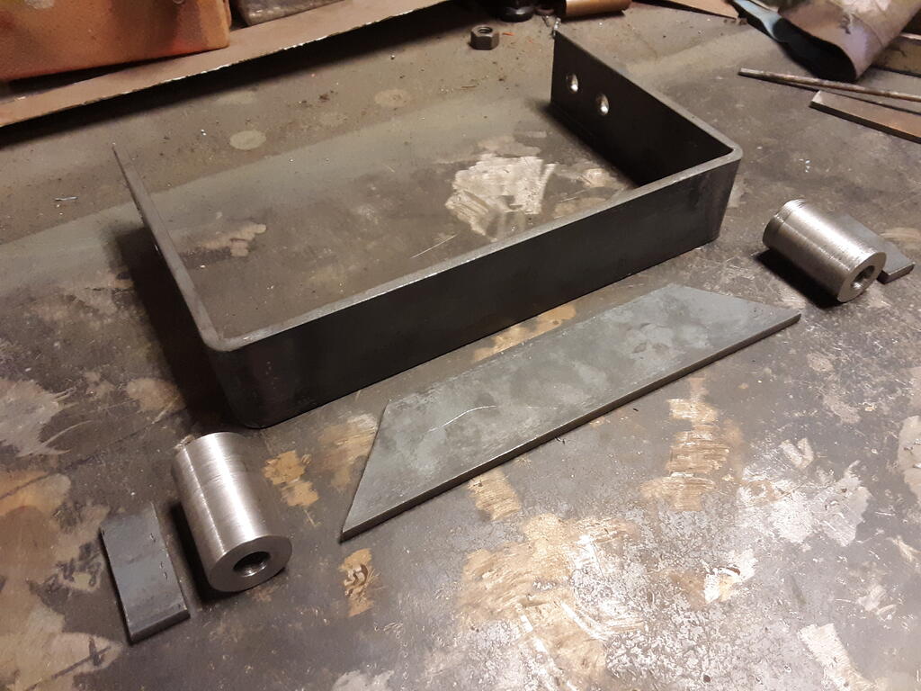

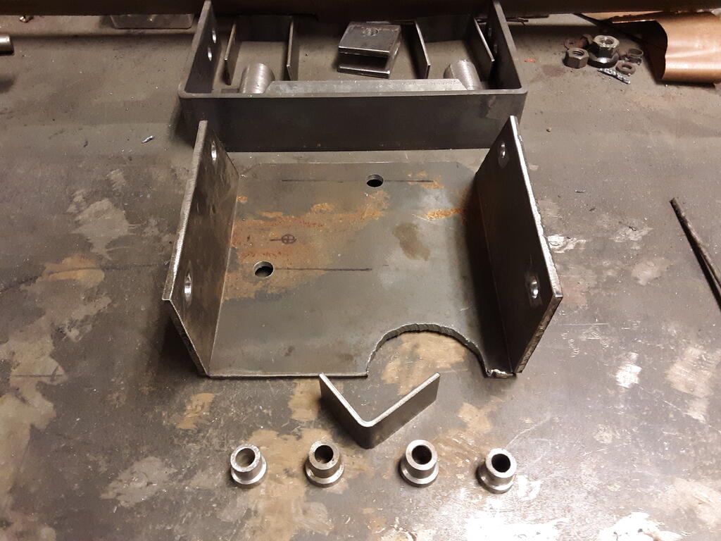

Oldskool 6,678 #40 Posted February 9, 2021 The individual pieces for the front mount are made. 2 Share this post Link to post Share on other sites
Oldskool 6,678 #41 Posted February 9, 2021 More of the mounting brackets. Share this post Link to post Share on other sites

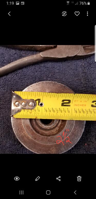

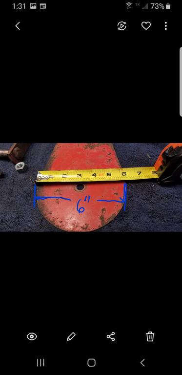

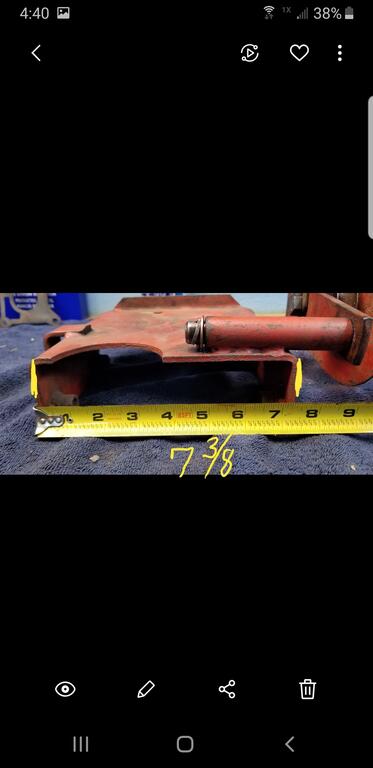

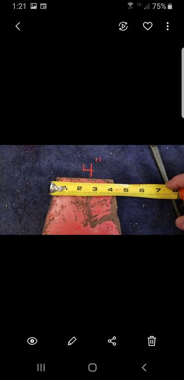

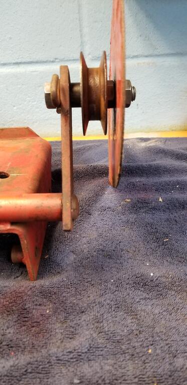

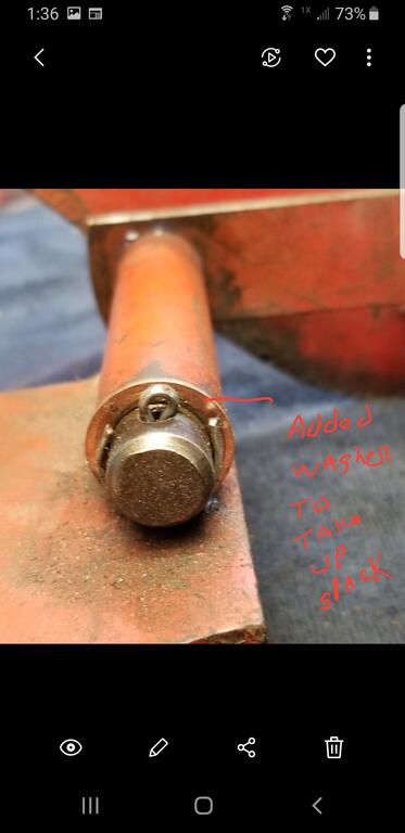

Oldskool 6,678 #42 Posted February 9, 2021 @gt14rider I hate to ask, but I need more measurements for the ider pivot/bracket. Idler size and the gaurd. Like what is in this pic. Share this post Link to post Share on other sites
gt14rider 1,281 #43 Posted February 10, 2021 I'll try and get some measurements and pics, in the morning 3 Share this post Link to post Share on other sites
Oldskool 6,678 #44 Posted February 10, 2021 4 minutes ago, gt14rider said: I'll try and get some measurements and pics, in the morning Awesome thank you Share this post Link to post Share on other sites
gt14rider 1,281 #45 Posted February 10, 2021 Here some pics, let me know if you need more. 2 2 Share this post Link to post Share on other sites
Oldskool 6,678 #46 Posted February 10, 2021 Thanks @gt14rider That will keep me busy for a bit. I really appreciate you taking the time to do this. Share this post Link to post Share on other sites

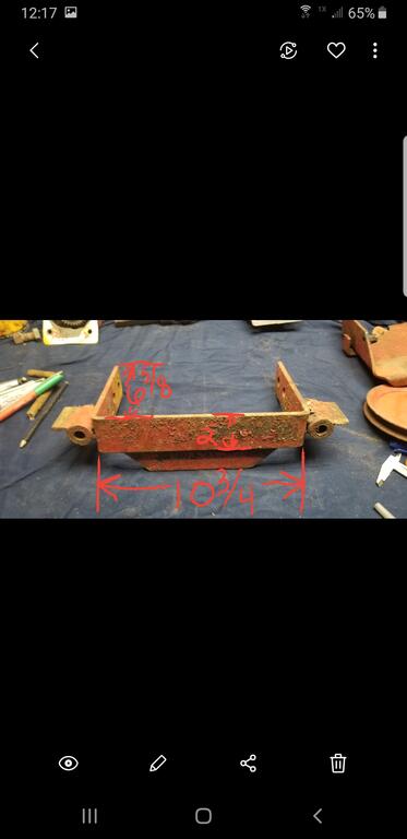

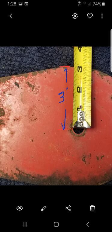

Oldskool 6,678 #48 Posted February 10, 2021 I think my measurements might be off. I think I made my gearbox bracket an inch short somehow. What is the over all length of that bracket? Share this post Link to post Share on other sites
gt14rider 1,281 #49 Posted February 10, 2021 Here's some more pics 1 Share this post Link to post Share on other sites
Oldskool 6,678 #50 Posted February 10, 2021 @gt14rider thanks again. I'll have this all mounted fairly soon at this rate. 1 Share this post Link to post Share on other sites
