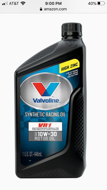

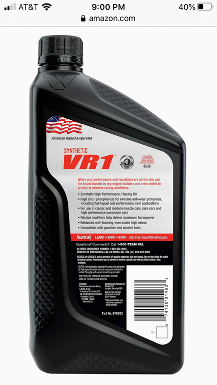

tom2p 2,394 #17 Posted November 15, 2020 Valvoline VR1 Racing oil - both the conventional and synthetic blend - have a higher amount of ZDDP (zinc, phosphorus, etc) ( VR1 is also available in 20w50 ) Advance Auto parts near me has this oil in stock I've been tempted to use this oil - but recently been using 5w30 Quaker State Ultimate Durability (full synthetic) after using Mobil 1 almost exclusively since the late 1980's ( back then few if any motor oils were at the level of the original Mobil 1 ) Quaker State Ultimate Durability has tested well and is around $19 for a 5 quart container at Walmart 1 Share this post Link to post Share on other sites
lynnmor 8,844 #18 Posted November 15, 2020 17 minutes ago, tom2p said: this was especially true back in the day with multi-grade conventional oil - after extended use apparently not as much an issue now with synthetic oils - if it still is an issue Can you direct me to a full synthetic 10W-30 that is not rated SN? Share this post Link to post Share on other sites
tom2p 2,394 #19 Posted November 15, 2020 (edited) 24 minutes ago, lynnmor said: Can you direct me to a full synthetic 10W-30 that is not rated SN? good question few - if any - probably exist ? (unfortunately) possibly Valvoline VR1 synthetic ? (not sure of the API certification - see pictures below) or possibly small engine or racing oil from Amsoil ... or Lucas ? Edited November 15, 2020 by tom2p 1 Share this post Link to post Share on other sites
Greentored 3,220 #20 Posted November 17, 2020 On 11/14/2020 at 9:04 PM, tom2p said: good question few - if any - probably exist ? (unfortunately) possibly Valvoline VR1 synthetic ? (not sure of the API certification - see pictures below) or possibly small engine or racing oil from Amsoil ... or Lucas ? Just happened to have a couple cases in the shop as its what I run in my 66 olds (650hp big block chevy). Says "exceeds API service SL and all proceeding". Aside from the synthetic in the 66, if its a flat tappet cam and/or an older engine, VR1 non synthetic goes in every single one, from my customers classic vehicles to my own, including the '53 Harley and the Horses. When it comes to 90% of engines out there, the following applies: Pick your favorite oil, keep it full, keep it changed, you'll be fine. 3 1 Share this post Link to post Share on other sites

oilwell1415 563 #23 Posted November 17, 2020 On 11/14/2020 at 7:40 PM, lynnmor said: Can you direct me to a full synthetic 10W-30 that is not rated SN? Be careful with that. Just because it isn't rated SN doesn't mean is isn't formulated to that spec. Some of the best oils available aren't rated because the company doesn't want to go to the expense of getting a low volume oil certified. The only reason Amsoil bothers to certify any of their oils is so they can be used in new vehicles without causing warranty problems. Instead of looking at the rating, or lack of, look at the additive package and intended use of the oil. 7 hours ago, Greentored said: When it comes to 90% of engines out there, the following applies: Pick your favorite oil, keep it full, keep it changed, you'll be fine. ^^^^That's exactly right. I may even up the percentage. Oils are so good today that it really doesn't matter as long as you use a viscosity that can be splashed, slung, pumped, etc. to the places it needs to be. As for what I use, my old truck that I drive every day rolled over 498k miles on my way to work this morning. It gets the cheapest 20w50 I can find for it. That's typically Castrol GTX lately, but sometimes I find other things. All of our other vehicles get Amsoil Signature Series. My new F-150 gets it in 5w20. The Jeep, SS and Lightning get 5w30. Our SeaDoo gets Amsoil Injector 2 stroke oil. My Continental IO-470 gets AeroShell 100W straight 50 weight, which I mention here only because I think it would make a great tractor oil in a lighter viscosity. I plan to do Amsoil in my WH as well. 1 Share this post Link to post Share on other sites
