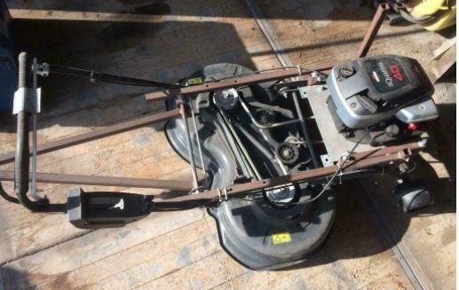

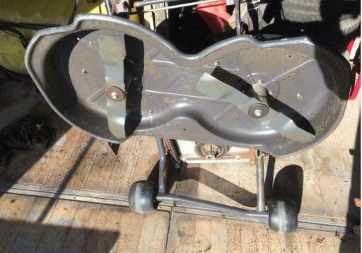

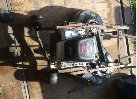

Maxwell-8 4,371 #8 Posted December 23, 2020 Someone in the neighbourhood got this for sale: Cheaply made, universal Ment to be dragged behind a wheel horse or ATV He is asking 800$, but you can slap this together for almost nothing 1 Share this post Link to post Share on other sites
Jhook 849 #9 Posted December 24, 2020 10 hours ago, Maxwell-8 said: Someone in the neighbourhood got this for sale: Cheaply made, universal Ment to be dragged behind a wheel horse or ATV He is asking 800$, but you can slap this together for almost nothing I would not pay 800 pennies for that monstrosity 1 Share this post Link to post Share on other sites
