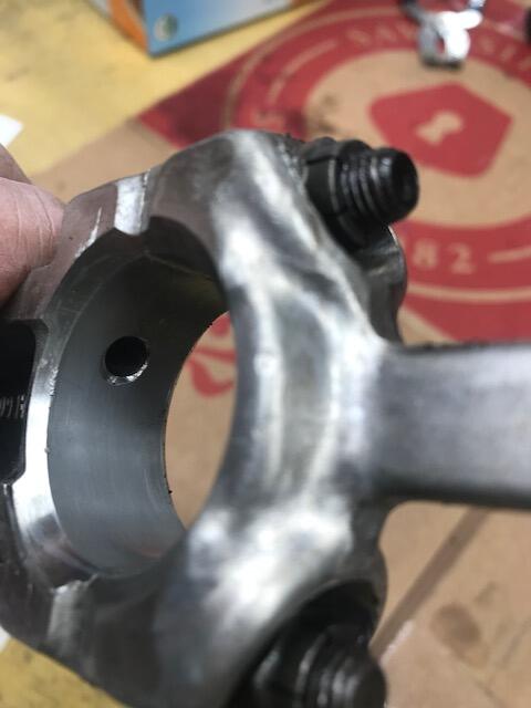

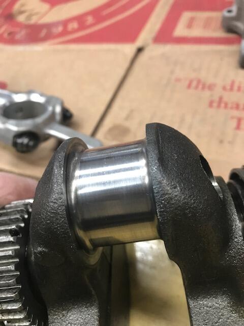

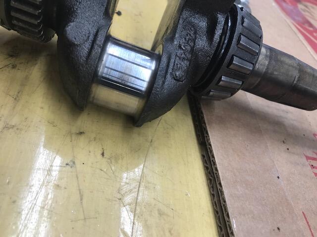

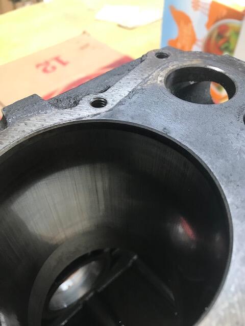

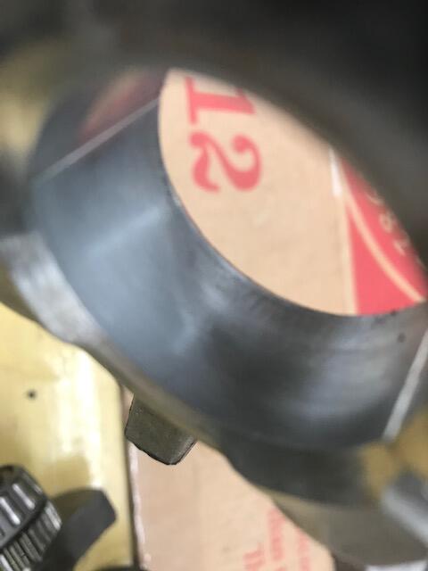

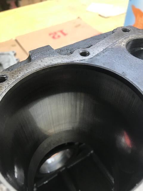

wmsue 6 #1 Posted November 12, 2020 My Charger Nine developed a slight knock a year ago and I've finally got the time to take it apart. It is an HH-100 Short block that I installed in the early 80's. It has never been apart before. I shut it down as soon as I heard the knock and haven't started it since. The oil was good with no metal filings anywhere. The engine has served me well over the years by plowing snow for me and all the neighbors. It has worked hard. Haven't used it to mow because the deck rotted out and I bought a 310-8 in about 1986 to use for mowing. Is there another engine that will bolt up and allow the hood to close? I will not be using it to cut grass, only to plow snow and haul a cart around. I do like electric start though. Is that the best route because I understand that parts for these old engines can be hard to find. If rebuilding is a better option, here are some of the specs I took after tear down. Piston measures 3.270 Bore measures 3.320 (3.312 is factory spec) I cannot feel a ridge at the top of the bore. There is discoloration (honing at the bottom of the bore, but no ridge either. end gap clearance is .049 top - .045 middle - .049 bottom Conn Rod - 1.375 Crank - 1.370 (spec is 1.3750 - 1.3755 Photos of the bore, crank, and rod are attached. I don't mind spending a few hundred to get it running again if that is the best route. Am I looking at a .010 oversize piston and rings? Can I get away with a std. connecting rod? Can I even find an oversize if I would need to get the crank reground? What would you do if you were in my situation? Thanks Bill Share this post Link to post Share on other sites
