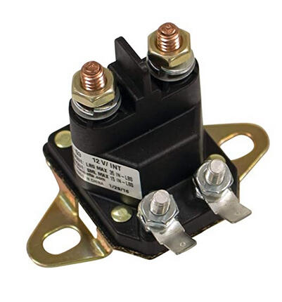

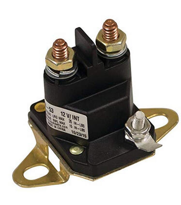

jsp_333 294 #1 Posted November 11, 2020 I have a 414-8 and the starter went a couple weeks back. I replaced the solenoid for good measure. Had the starter motor rebuilt by a local shop. When I turn on the engine the pinion in the starter motor spins but won't extend to engage the flywheel. Pinion work as it should (comes extending out) on the bench when I picked it up. They actually showed me. Brought it home and installed it and no go. Really baffled at this point and obviously in need of some help. Share this post Link to post Share on other sites

jsp_333 294 #6 Posted November 12, 2020 I'm inclined to go down the bad electrical connection. Bad ground. I've eliminated battery by bypassing that with a battery charger connected directly to the battery cables. The starter worked correctly on the bench at the rebuild shop. Could the solenoid be the problem even though it's brand new. It came with a second electrical lead at the bottom. I ran a ground wire from that to the frame of the tractor. It won't work (spin the starter motor) otherwise. Because the solenoid is just a relay I didn't worry about it too much Share this post Link to post Share on other sites
