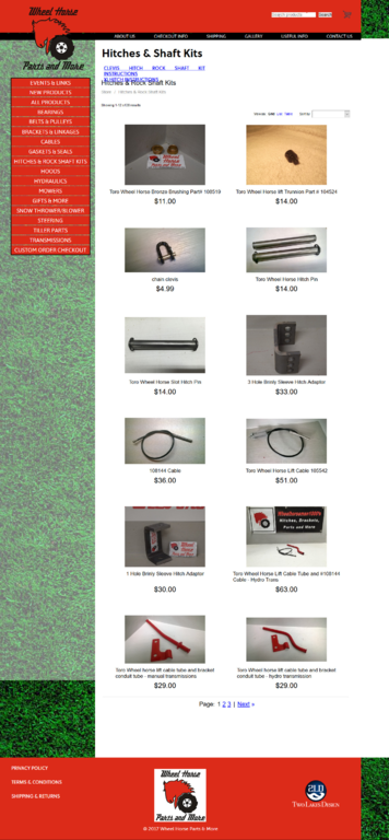

Lee1977 7,805 #4 Posted November 11, 2020 Check out " Wheel Horses Parts and More " down in the venders section. 1 Share this post Link to post Share on other sites
