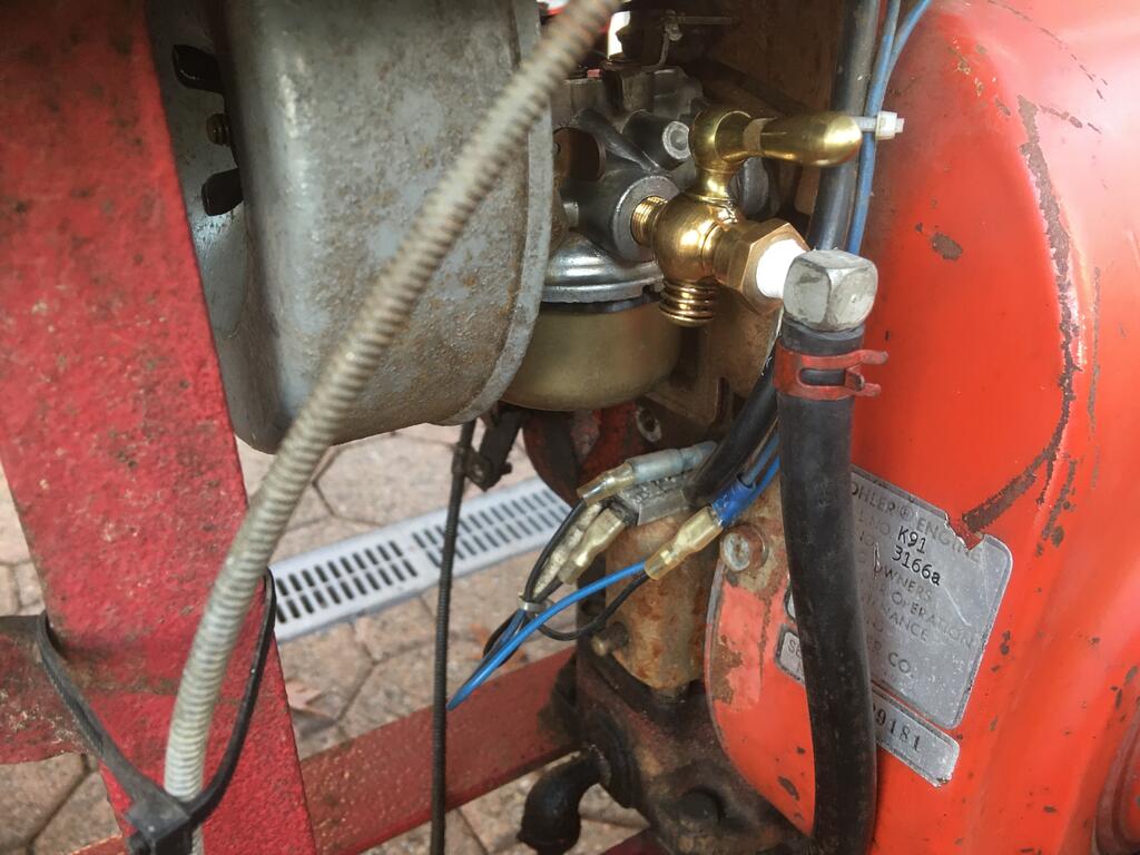

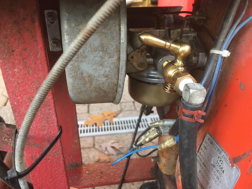

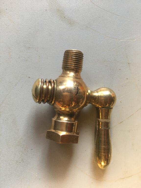

formariz 12,381 #1 Posted November 10, 2020 I found these awesome looking valves with the correct threads for carburetors and fuel tanks. They seem to be made for labs perhaps gas valves. Tried one in a RJ and so far no leaks seems to work for fuel. They look awesome and are easy to operate. At $2.00 each I may found a lifetime supply. 3 4 1 Share this post Link to post Share on other sites

squonk 48,339 #7 Posted November 10, 2020 Keep an eye on that. Whatever seals it may not be compatible with gas. May take a while to leak. Or worse yet may swell up and when the lever is moved REALLY LEAK! Share this post Link to post Share on other sites
formariz 12,381 #8 Posted November 10, 2020 48 minutes ago, squonk said: Keep an eye on that. Whatever seals it may not be compatible with gas. May take a while to leak. Or worse yet may swell up and when the lever is moved REALLY LEAK! Yes I am keeping an eye closely on it. They seem to be made entirely of brass. I don’t see anything else in them . I am going to take one apart tonight. 1 Share this post Link to post Share on other sites

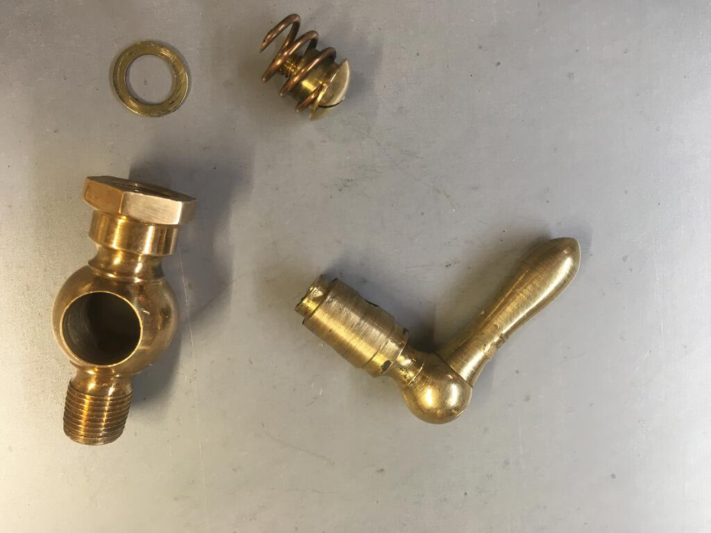

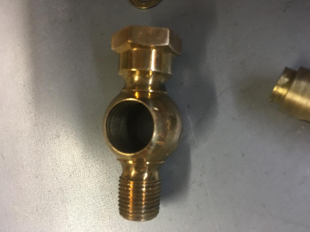

formariz 12,381 #10 Posted November 11, 2020 (edited) So I have taken one valve apart. It is entirely made of brass. There are no components to deteriorate from exposure to fuel. Male and female parts are precisely machined and are tapered therefor getting a tighter fit when screw it tightened . Edited November 11, 2020 by formariz 2 3 Share this post Link to post Share on other sites
