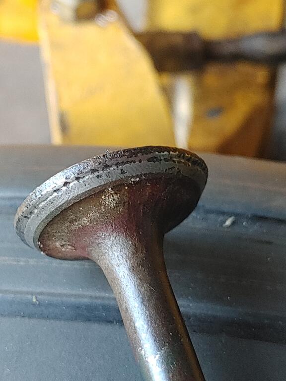

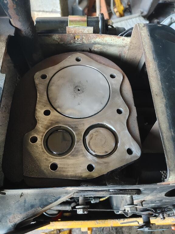

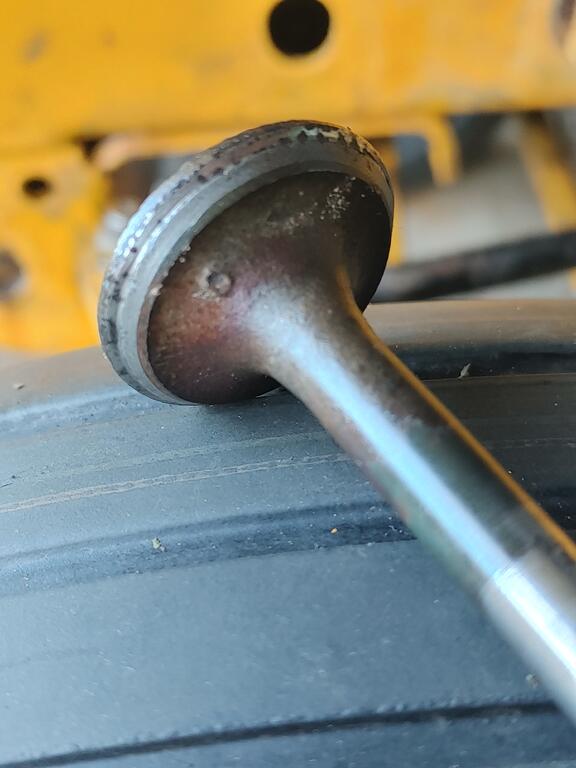

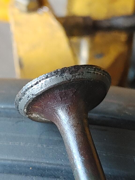

WVHillbilly520H 10,378 #10 Posted November 11, 2020 Burnt valve pics below... They are videos on youtube that show you how to check and adjust the valves lash... Head gasket will have black/dark spots on the inner sealing ring where if its leaking, the piston shouldn't rock within the bore. 2 Share this post Link to post Share on other sites

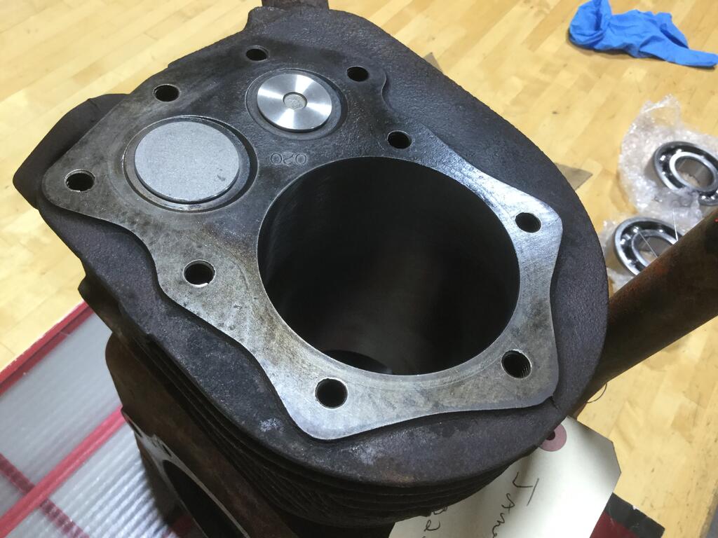

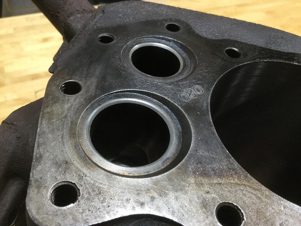

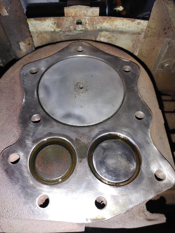

richmondred01 2,333 #11 Posted November 11, 2020 (edited) In the end you want it to look like this. You should try to find someone in your area with experience working on these engines. It may be a bit of a challenge because I’m finding no shops that work on the old flatheads. That knowledge is fading. Look in the member section and see if there a member close by that may at least oversee what you are doing. Most important is finding a quality machinist. Edited November 11, 2020 by richmondred01 1 Share this post Link to post Share on other sites

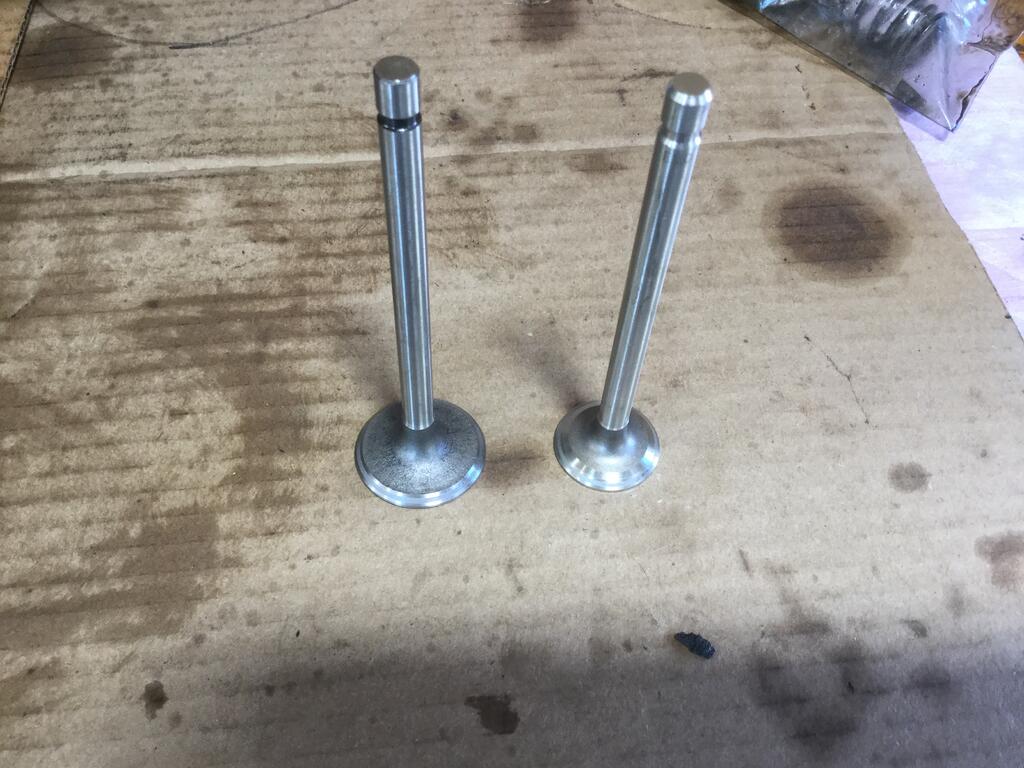

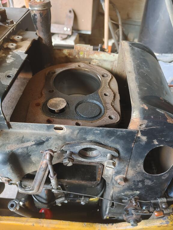

WVHillbilly520H 10,378 #13 Posted November 11, 2020 (edited) After cleaning finding another valve and a little hand lapping the "seal" on my valves is back, they held light (10w) oil for 24 hours... Crazy that a 12hp issue was brought up as I was working on this 12hp Cub. Edited November 11, 2020 by WVHillbilly520H 2 Share this post Link to post Share on other sites

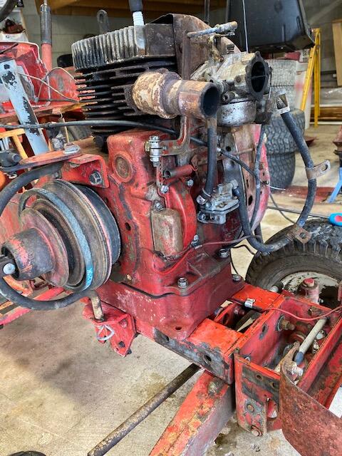

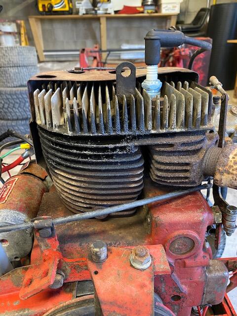

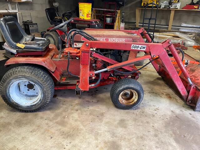

bo dawg 565 #14 Posted November 11, 2020 Heres what I'm looking at. I plan on popping off the head cover this weekend hopefully. More than likely wont go as far as you guys would, Im not gonna spend the money on a mechanic/machine shop. I didnt pay much for the this 120 and the Bronco 14 I took in. I was just interested in the loader this 120 had on it. So if it isnt an easy fix I'll just sell it or scrap it. Bad thing is this motor runs and starts great, just smokes like a freight train. But since I really have never tore into an engine I thought it might be a good donor to learn something. Share this post Link to post Share on other sites
WVHillbilly520H 10,378 #15 Posted November 11, 2020 @bo dawg, second picture definitely looks like a leaking head gasket and if the rings are worn or a valve is burnt like mine above it can pull oil up the valve stem or past the rings and into the combustion chamber then on out the head gasket as well the exhaust... But it really isn't that hard to check the valve lash and once the head is off the valve face/seat condition can be checked with a mirror and light. 1 Share this post Link to post Share on other sites
