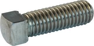

953 nut 70,354 #4 Posted November 8, 2020 9 hours ago, Ronnie Gray said: bolt on the woodfurd key supposed to hold the hub from moving in and out? Be sure that you are using a setscrew with a cupped end rather than a bolt. Share this post Link to post Share on other sites

gwest_ca-(File Mod) 12,535 #6 Posted November 8, 2020 From the 1978-79 service manual Rear wheel hub set screw torque 28-32 Ft. Lb. or 39-45 Nm What I do is retorque after a 1/2 hour of use, 1 hour of use and so on until I am confident everything is seated in. Just snug up the locknut because anything more tends to pull the set screw back out. Garry 2 Share this post Link to post Share on other sites

daveoman1966 3,884 #8 Posted November 8, 2020 Don't thighten the 'set screw' too much...it may snap off, then you're really 'screwed'. Don't ask how I know this... Share this post Link to post Share on other sites
