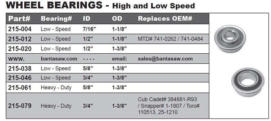

gwest_ca-(File Mod) 12,535 #4 Posted November 7, 2020 The center tube in a front wheel is usually about 1-1/2" OD and uses a flanged bearing with a 1-3/8" OD. The flange is about 1-1/2" OD. This shows the most popular sizes Garry 1 Share this post Link to post Share on other sites
