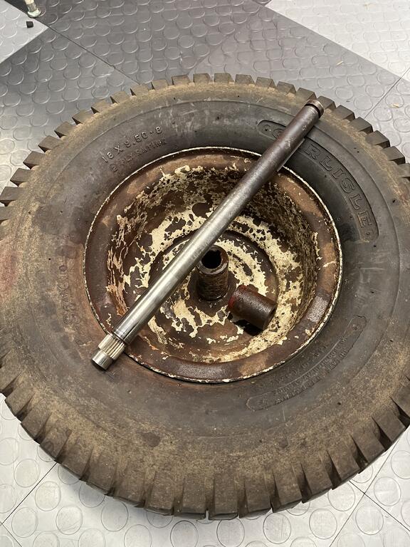

Heatingman 977 #57 Posted September 16, 2022 (edited) 22 hours ago, Alan173 said: For those of you who have done this job (tire removal of 43+ year old tires) and lived to tell your grandkids a serious ‘tip of the hat’ to you! Wow! Just braking the seal of probably 43 years of rust, dry rot and fix-a-flat which apparently in just the right combination is the strongest molecular bond known to humankind...nearly did me in. I swear the rear tires are looking back at me and laughing. Maybe there is a small machine at the local mower shop for this? Any/all tips are appreciated. Wait till you do the back tires. You’ll want to take a nap afterwards. I wound up using the 12 ton press on mine. Edited September 16, 2022 by Heatingman 3 2 Share this post Link to post Share on other sites

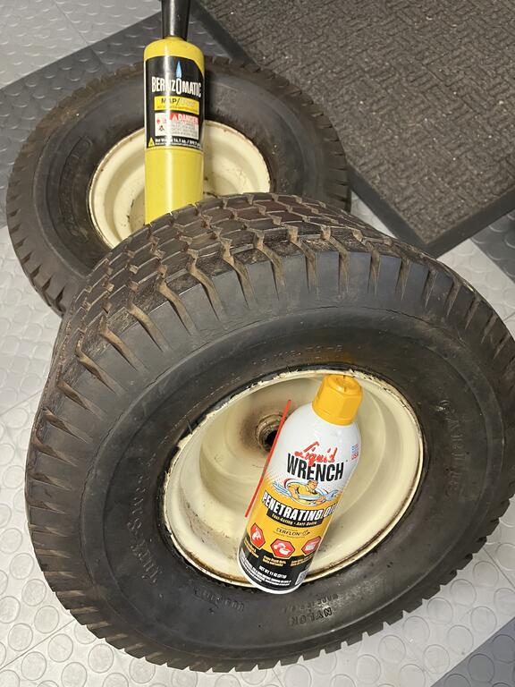

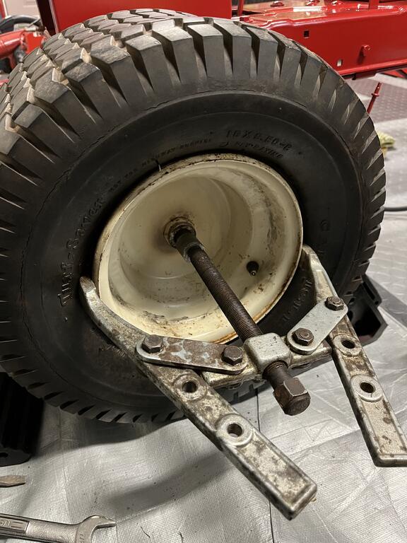

Alan173 321 #58 Posted September 22, 2022 (edited) I think I have finally run into what must be the Achilles Heal of the B-111 tractors. The rear wheels! Mine are rusted in place to the half shafts of the transmission. They don't budge. Any tips or tricks appreciated for this problem? All my wheel pullers didn't make them budge either...even after serious persuasion. Soaking them in penetrating oil to no avail but will keep trying. The only solution seems like disassembly of the factory sealed transmission (BLAH!!!!!!!), pull out and disassemble the limited slip differential....take out the planetary gear set and then finally take the half shafts out. Any guidance or thoughts on this? I knew the rear wheels where laughing at me when I struggled with the front wheels. I had no idea it was this sinister.... * Update: one half shaft failed at the e-clip and came out with the rim. Took forever but I was finally able to get the shaft out of the rim. The other rim is still stuck on the half shaft in the transmission. It looks like I’ll have to pull the transmission with one wheel on. Oh boy…. Edited September 22, 2022 by Alan173 2 Share this post Link to post Share on other sites
ebinmaine 80,713 #59 Posted September 22, 2022 I've never tackled one of those transmissions and I've never tried to remove the wheels themselves directly from an axle shaft. Everything I've gotten into has been the regular unidrive with the hubs on the axles. Hence, take my inclination with a grain of salt. There are situations in our overall existence where we try to take a shortcut and then we realize that the shortcut turned into the loooong-cut. It's distinctly possible that whatever the lube is in that transmission should be cleaned out and replaced anyway. If you have access to a press, and you can get the bare shaft out of the bare wheel using that method, it's likely worth your time to disassemble that transmission. 1 1 Share this post Link to post Share on other sites

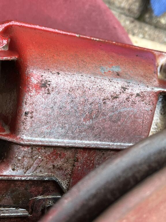

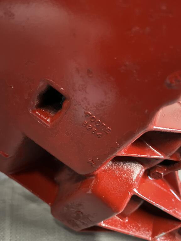

Alan173 321 #60 Posted September 23, 2022 (edited) At least it is identified. Foote 4000-5 transmission. If you look close you can see the original marking… Edited September 23, 2022 by Alan173 2 Share this post Link to post Share on other sites

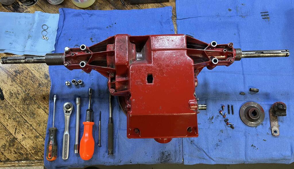

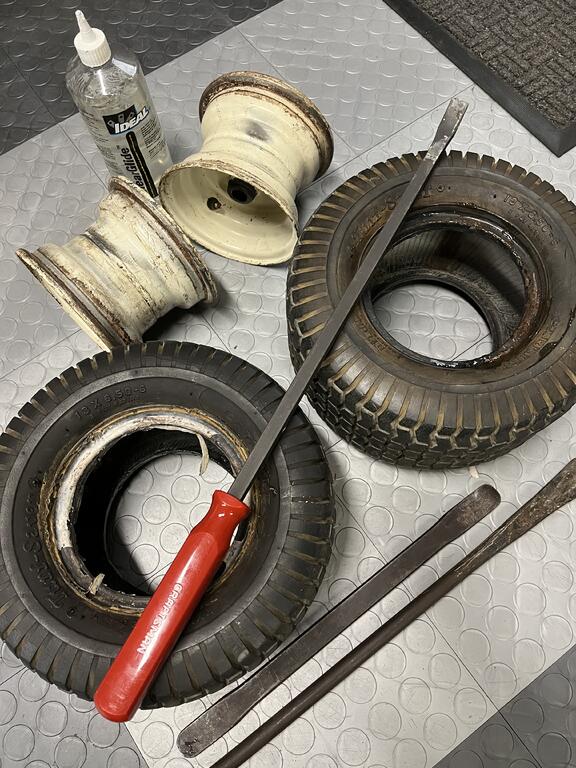

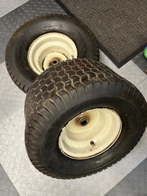

Alan173 321 #61 Posted September 26, 2022 (edited) Transmission disassembled. Wheel/differential and half shaft finally removed. Ok…maybe shingling a roof wasn’t so bad….😉. Transmission so far is in decent shape as I continue the inspection. Faced off one of the bevel gears on my mill, replaced a few snap rings, added a few shims…still going through it. I present two rear tires/rims and some friends that helped: Edited September 26, 2022 by Alan173 1 1 Share this post Link to post Share on other sites
Heatingman 977 #62 Posted September 26, 2022 Holy cow, thats one heck of a tire removal. Nice work. 3 Share this post Link to post Share on other sites

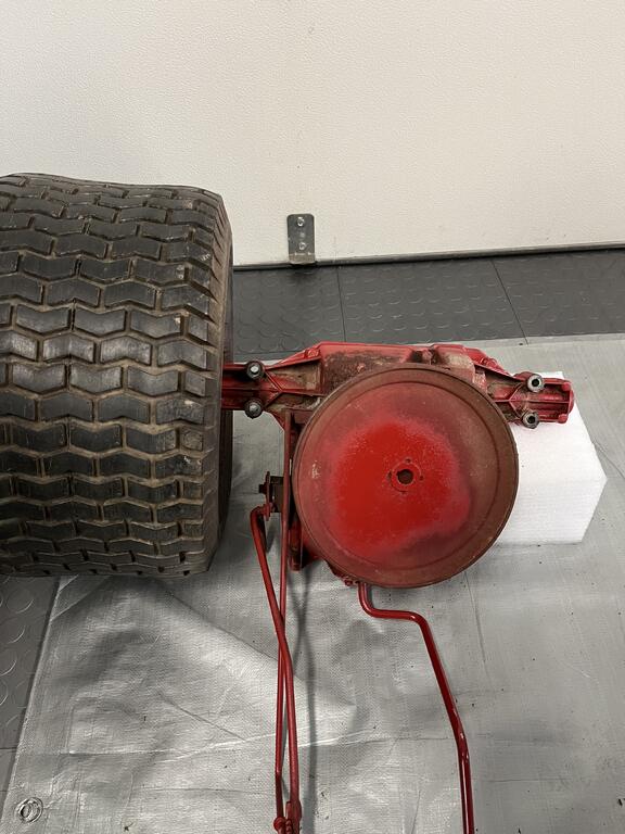

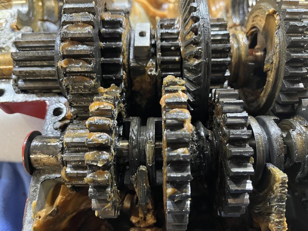

Alan173 321 #64 Posted September 27, 2022 (edited) Transmission back together with TWO half shafts in place…sans the stuck wheel. Much better. 🤞 it still works as it did before. I had to remove every spec of grease from the bevel gears before the differential assembly would drop back into place….then re-grease. That order was very important. Edited September 27, 2022 by Alan173 6 Share this post Link to post Share on other sites

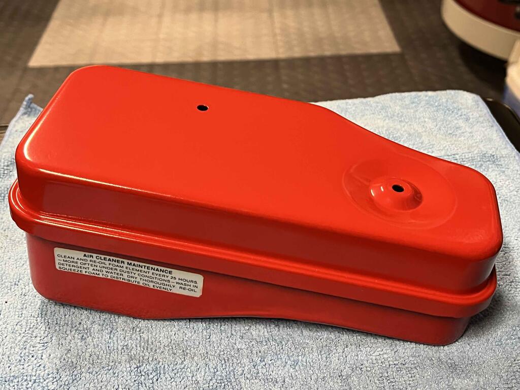

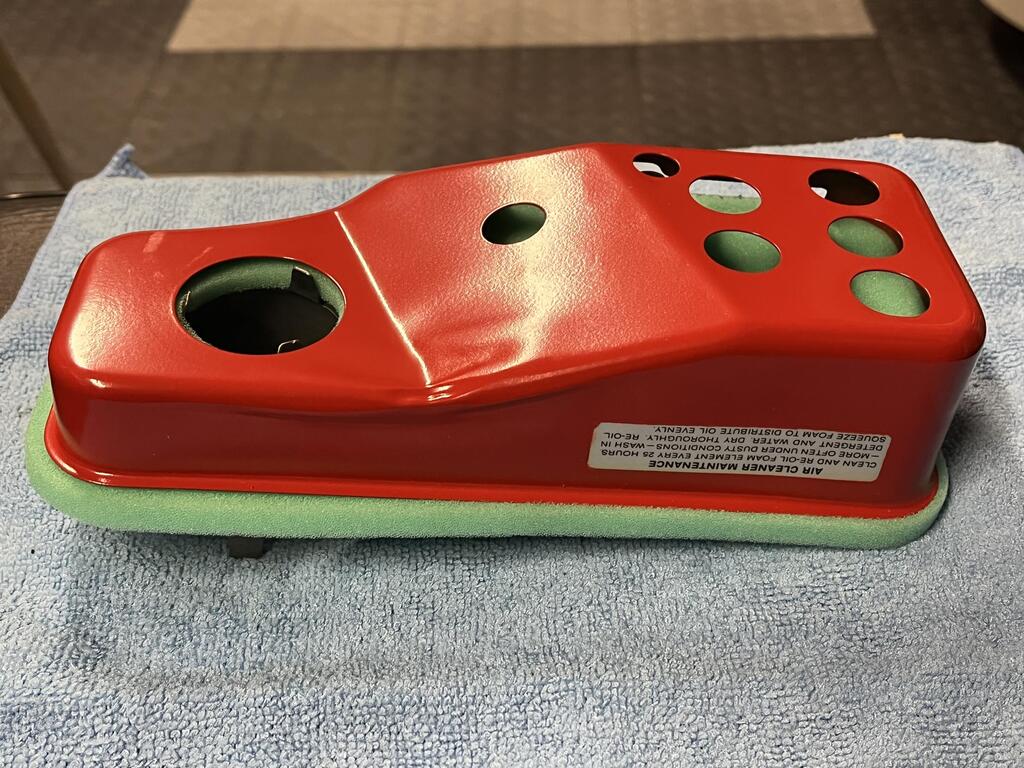

Alan173 321 #65 Posted September 28, 2022 (edited) Some days…you just put in the new air filter and put the freshly painted cover on. Ok…looks good…done for the day… Edited September 28, 2022 by Alan173 1 2 Share this post Link to post Share on other sites
ebinmaine 80,713 #66 Posted September 28, 2022 2 minutes ago, Alan173 said: Some days…you just put in the new air filter and put the freshly painted cover on. Ok…looks good…done for the day… No need to rush. 2 Share this post Link to post Share on other sites

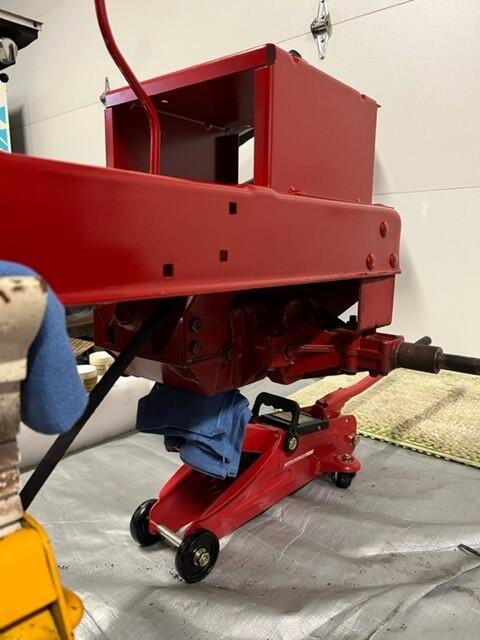

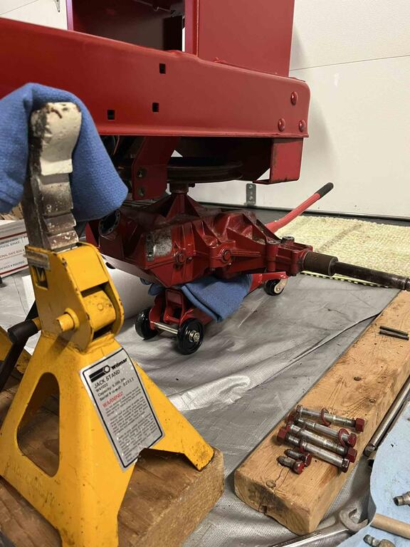

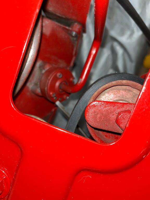

Alan173 321 #67 Posted October 4, 2022 Transmission going in…. 2 4 Share this post Link to post Share on other sites
Heatingman 977 #68 Posted October 5, 2022 I see some rust on that diff mount bracket. No better time to take care of that then now. looking really good. 4 Share this post Link to post Share on other sites

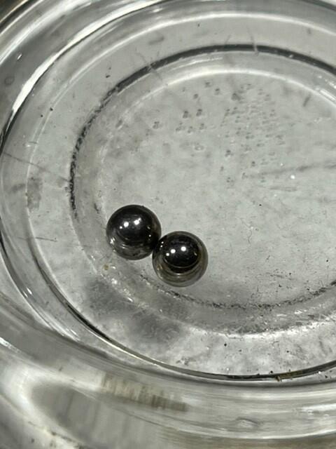

Alan173 321 #69 Posted October 5, 2022 (edited) I'll give that diff mount bracket some love as I go. Just trying to get the major tasks done while the weather is still decent. Painting the rims in short order. One thing I learned with this transmission is cleaning up the shifter lever and the associated detent ball bearings/springs is key. The transmission wasn't shifting quite right after re-assembly and was now having trouble holding a gear position. Be sure to clean out the set screws and detent balls for the shifter....and then adjust them properly with the two set screws. I can imagine after years of service these detent balls (and detents) get worn/out of round and make shifting difficult or show up as the transmission missing a gear. They are 3/16" (0.1875") so be sure to check them. With them all cleaned up, re-greased it seems to shift much more crisp now. **Note - the set screws are 100% accessible with everything assembled and can be adjusted as needed. Picture added with screw driver pointing to both set screw locations (blurry) Edited October 5, 2022 by Alan173 2 Share this post Link to post Share on other sites

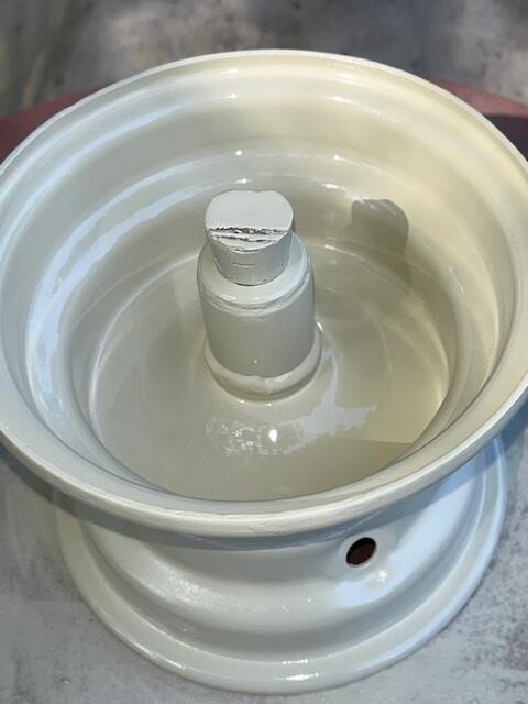

Alan173 321 #70 Posted October 5, 2022 Finally had a chance to paint the rims today. It was a long time getting there...and one of the last warm days of the season to spray outside. 3 2 Share this post Link to post Share on other sites
