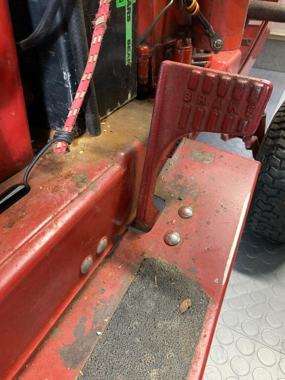

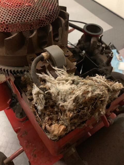

Alan173 321 #2 Posted November 6, 2020 (edited) Here it is.....pulled out of storage and in the front 'work garage'. Upon quick inspection...she looks pretty good! But of course...as we all know...critters make homes in the craziest places! Eeeeeek!!! Edited November 6, 2020 by Alan173 3 3 Share this post Link to post Share on other sites

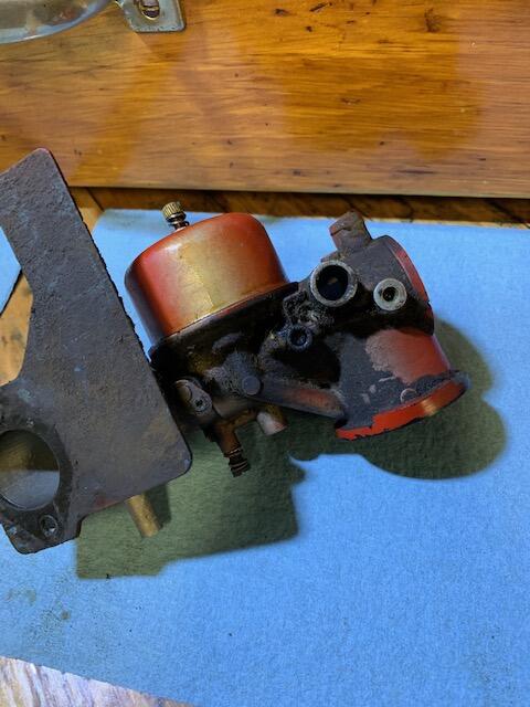

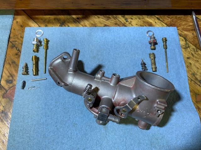

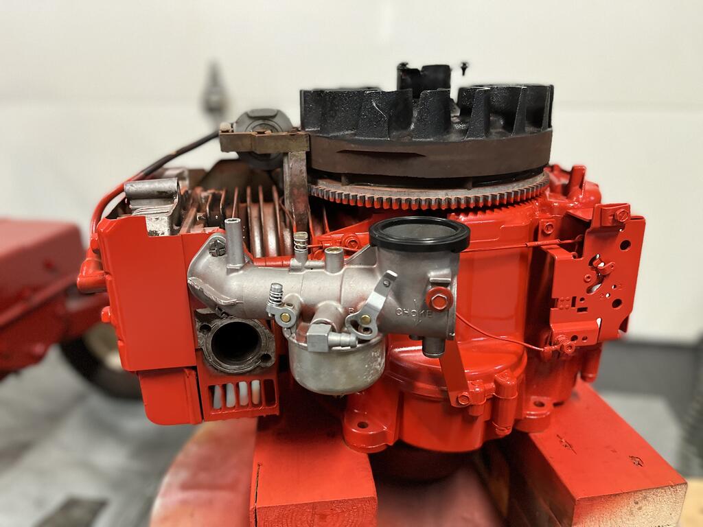

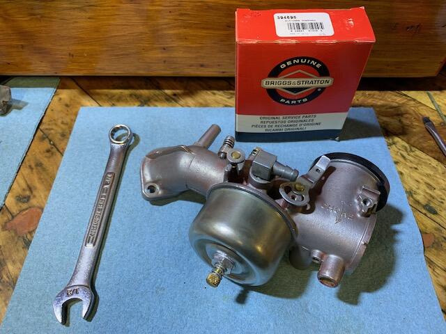

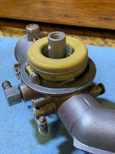

Alan173 321 #3 Posted November 6, 2020 (edited) New battery installed and the electrical system tested perfect. When I originally purchased it I cleaned the carb and it always ran great. Now....the original 1979 gaskets and carb could no longer do their job. So I picked up an original rebuild kit # 394698 to match my original 1979 11HP B&S engine (Model 252707). I quickly learned all the on-line kits contain 'most' of the parts you need. A trip to the local mower place and a little luck...I finally was able to get a complete kit with the original air cleaner gasket AND the nozzle! And yes...I can't stand painted carbs...maybe it is just me...but I hate painted over gaskets too! The ugly.... Edited November 6, 2020 by Alan173 2 4 Share this post Link to post Share on other sites
Alan173 321 #4 Posted November 6, 2020 OK - more picture overload. Well...this now looks much better! The one picture shows all the internals I replaced. Carb was in great shape...should be good for another 41 years! 1 10 2 Share this post Link to post Share on other sites

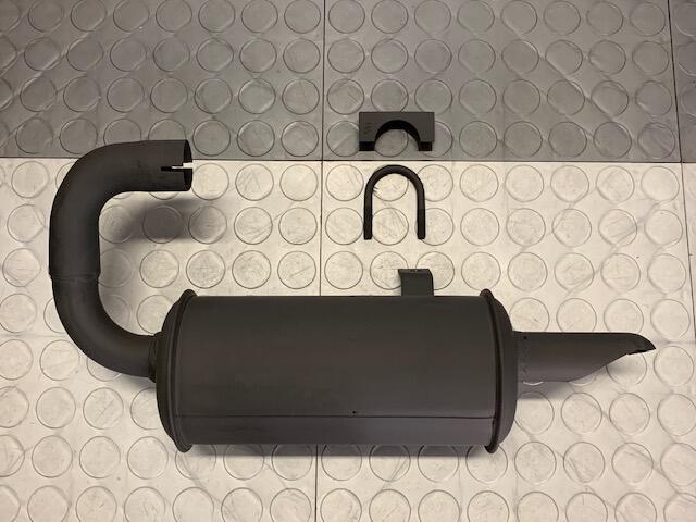

Alan173 321 #6 Posted November 7, 2020 Some days you only get a few things done. I took the muffler off today...and as many of you know this can be a job in itself! Looks great - was still the original Nelson Muffler...and if you look real close you can see the 1978 date stamp. Wire wheeled and 3 coats of black hot paint... 4 5 Share this post Link to post Share on other sites
Alan173 321 #7 Posted November 9, 2020 Here is the after on the muffler...moving forward when I can scratch out some free time... 1 4 Share this post Link to post Share on other sites

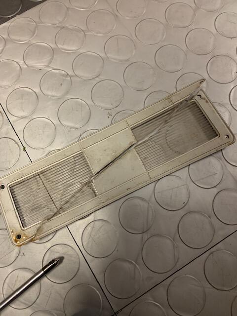

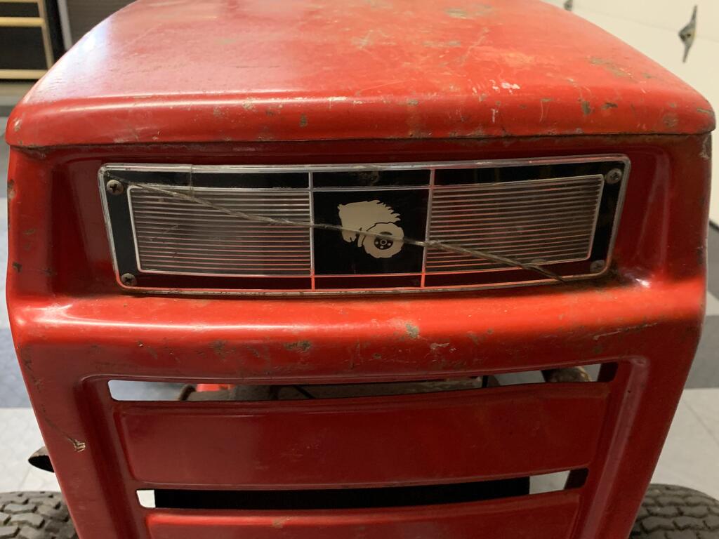

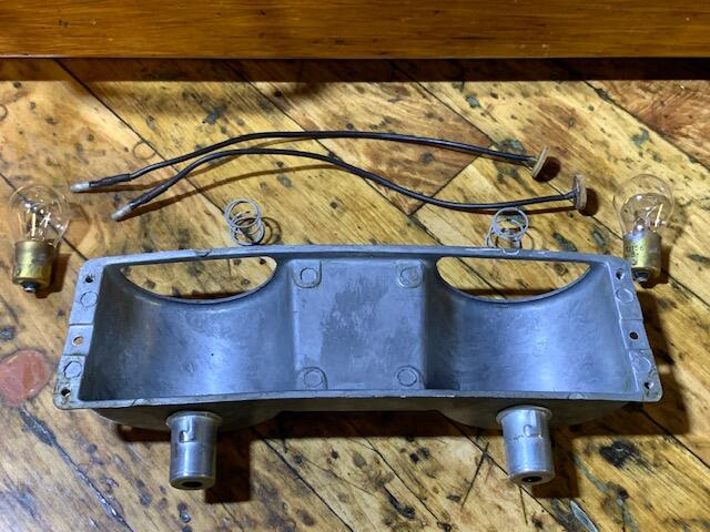

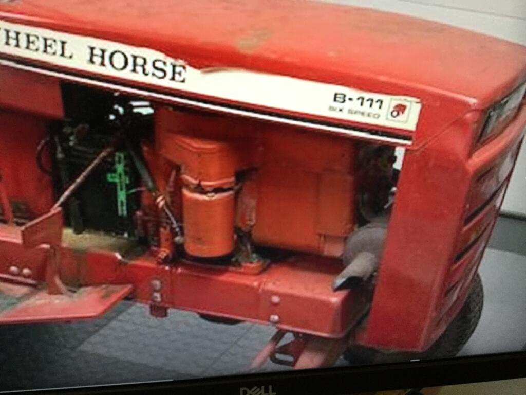

Alan173 321 #8 Posted November 9, 2020 (edited) Always fun when you receive 'PRESENTS' in the mail! . This is the closest I could find to my original 1978/1979 head light lens. Appears to be NOS...with the back side decal. My original is all molded as a single piece...and if anyone has a really nice one to donate to the restoration...I'm ready for you to contact me. But this one I just picked up sure beats 'cracked into two pieces'. Also the screw holes line up PERFECTLY - so that is nice. Drilled out the rivets for the head light assembly and started cleaning everything up. The original bullet connectors and micarta inserts are still in great shape! Edited November 9, 2020 by Alan173 3 5 Share this post Link to post Share on other sites

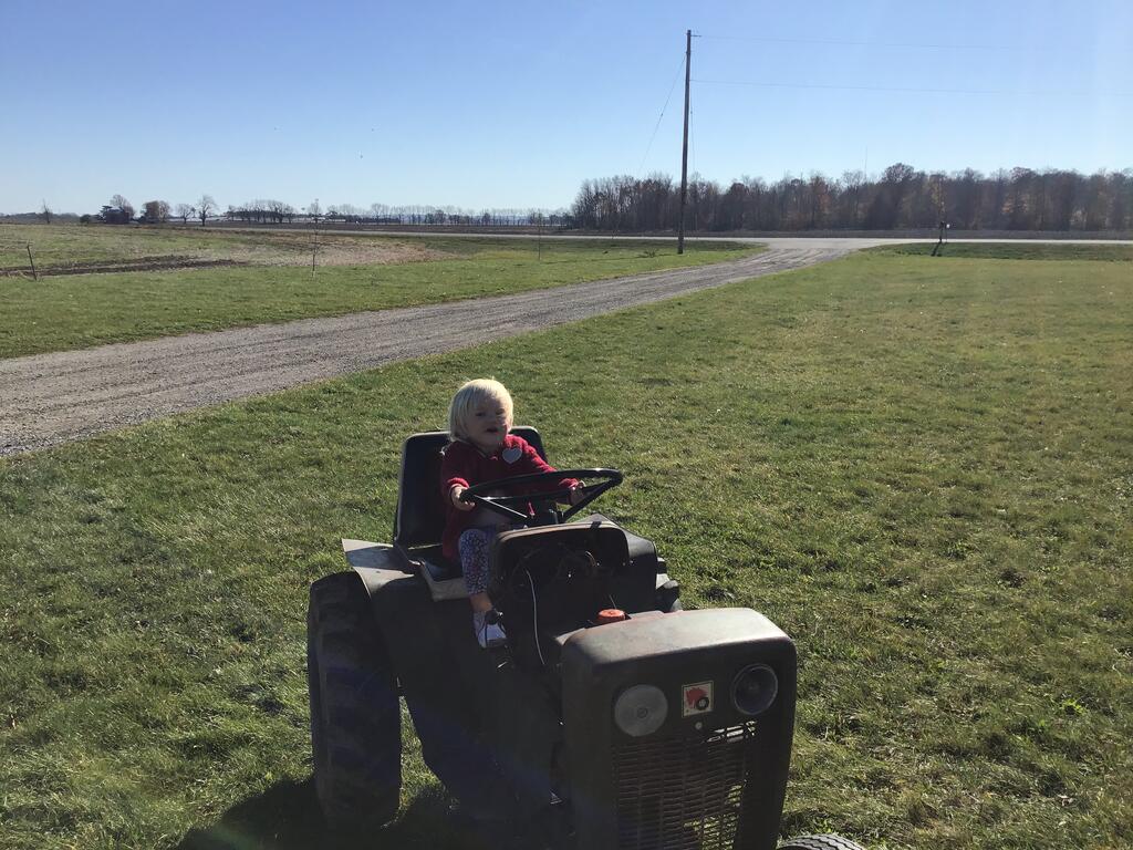

Pullstart 70,445 #9 Posted November 11, 2020 fellow Michigander @Alan173! These old things sure make kids smile, huh? 3 2 Share this post Link to post Share on other sites
Alan173 321 #10 Posted November 13, 2020 (edited) On 11/11/2020 at 3:31 PM, pullstart said: fellow Michigander @Alan173! These old things sure make kids smile, huh? You BET!!! Wonderful picture! Michigan proud. My daughter's smile when her Dad first let her take a drive by herself on the B-111 was priceless! I'm sure that felt like a 'REAL tractor'. Good times for sure.... Edited November 13, 2020 by Alan173 1 1 Share this post Link to post Share on other sites

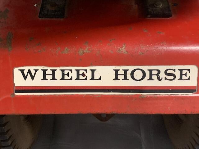

Alan173 321 #11 Posted November 13, 2020 (edited) I know I'm putting the 'cart before the wheel horse'...bah-da-BUM...but I just received my decal set and the sand blaster hasn't even hit my parts yet! I worked with Terry at REDOYOURHORSE.COM...https://www.redoyourhorse.com/...and he was a GREAT guy to work with! Terry took the time to send me his cell number and we swapped pictures back and forth as to exactly what I needed. It couldn't have been a better experience! I certainly appreciate anyone taking the time to create 'restoration items' for anyone jumping down this rabbit hole. Edited November 13, 2020 by Alan173 5 Share this post Link to post Share on other sites

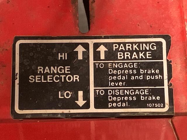

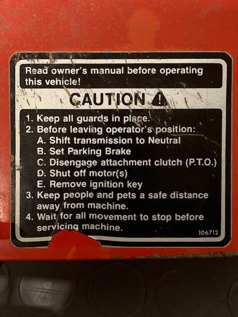

Alan173 321 #12 Posted November 13, 2020 Here are the original decals if anyone ever needed to know what came from the factory for a 1978/1979 B-111 SIX SPEED... 5 Share this post Link to post Share on other sites

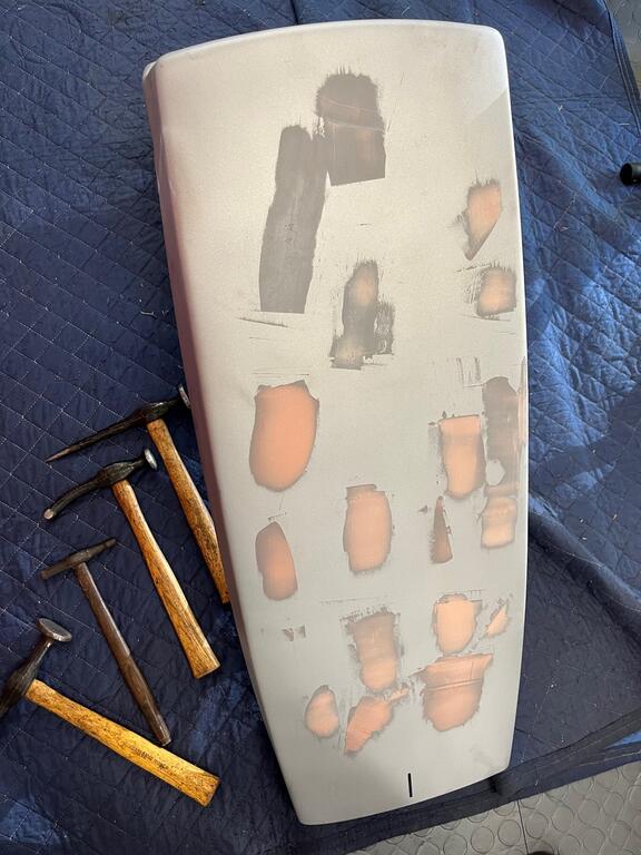

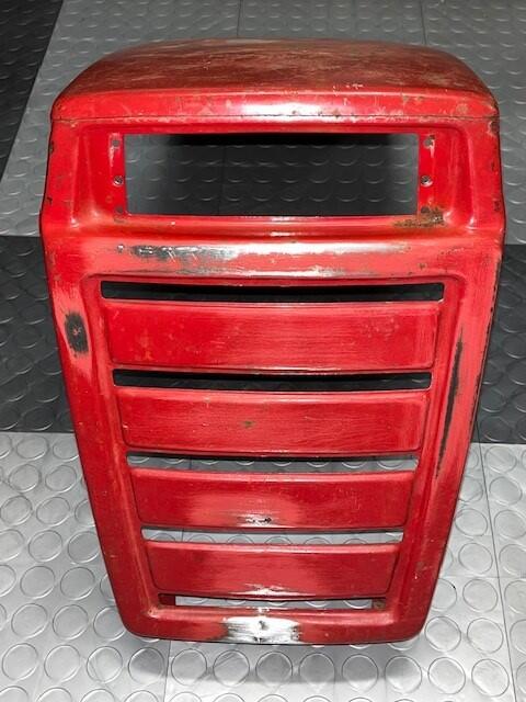

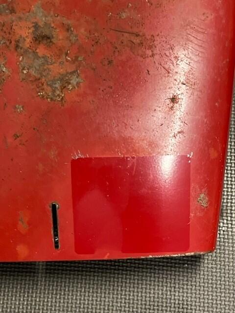

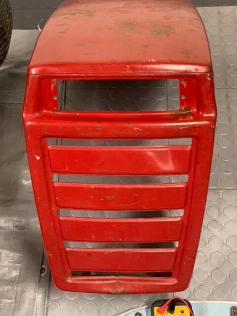

Alan173 321 #14 Posted July 24, 2022 Finally back to getting some work done after recovering (50%) from a nasty knee injury. Hood bumped out...decals removed. Will blast next, bondo/prime/paint. Will start removing more parts..... 2 5 Share this post Link to post Share on other sites

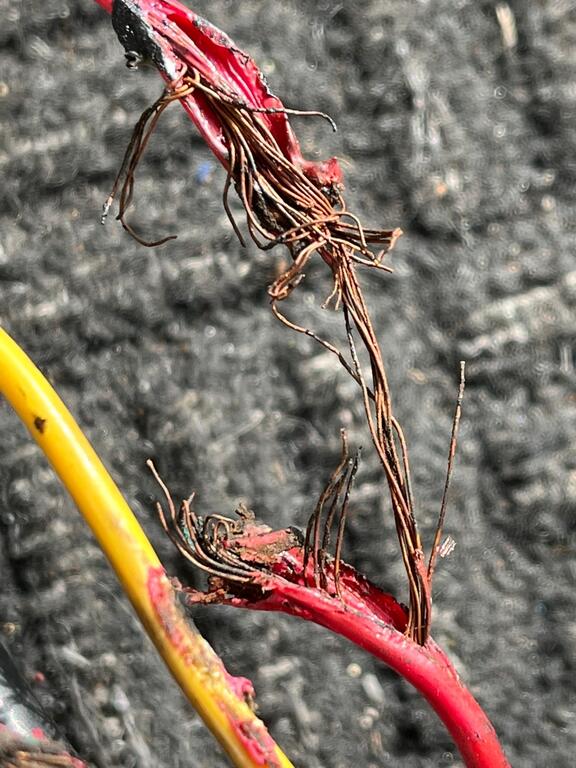

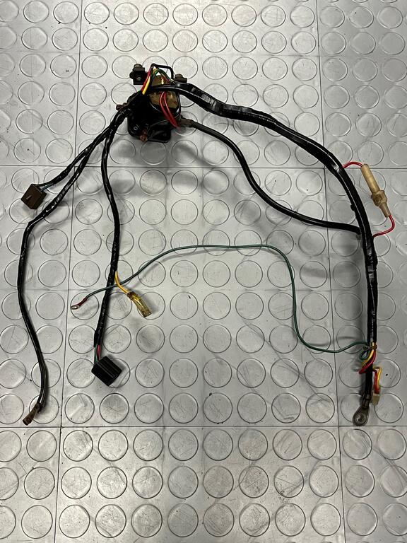

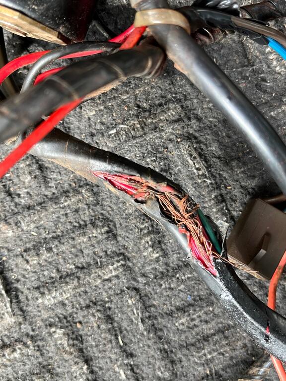

Alan173 321 #15 Posted August 15, 2022 It is always a good idea to test and unwrap/inspect a 40+ year old harness. Here is what I found with mine! Literally hanging on by a few strands. How it worked all these years is beyond me. After a quick re-wire/repair/restoration I'm good to go! 3 6 Share this post Link to post Share on other sites
ebinmaine 79,503 #16 Posted August 15, 2022 Excellent catch there! 1 Share this post Link to post Share on other sites

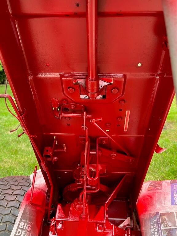

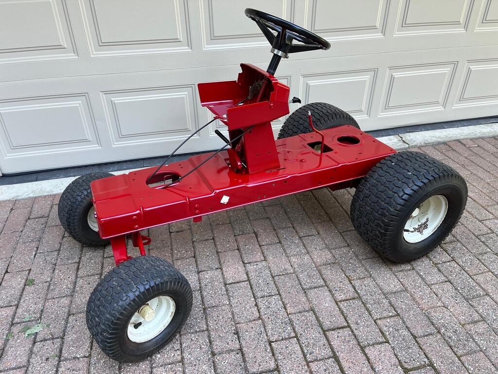

Alan173 321 #17 Posted August 16, 2022 Power washed the undercarriage....degreased....sanded and painted. Saved a little on the disassembly work but not making show perfect. Top side with a spray bomb as well. On to the engine rebuild and then paint. 1 7 Share this post Link to post Share on other sites

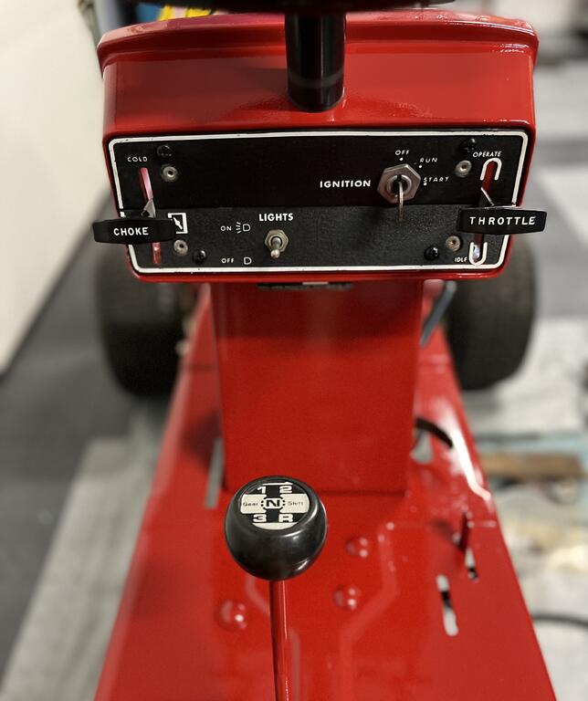

Alan173 321 #19 Posted August 19, 2022 Slowly moving forward…some improved dashboard detail. Original shifter decal still looks pretty good… 2 3 Share this post Link to post Share on other sites

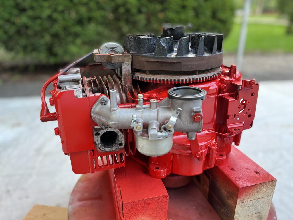

Alan173 321 #20 Posted August 19, 2022 (edited) Engine paint - Dupli-Color 1605 Ford Red Engine Enamel. I like the original orange/red Briggs paint and tried to emulate the same contrast to the original Wheel Horse red. It all depends on the lighting…and fluorescent verse natural light almost makes it look like two different engines! Very happy with the results. Here is my original paint red-ish-orange engine in fluorescent lighting: Edited August 19, 2022 by Alan173 1 5 Share this post Link to post Share on other sites

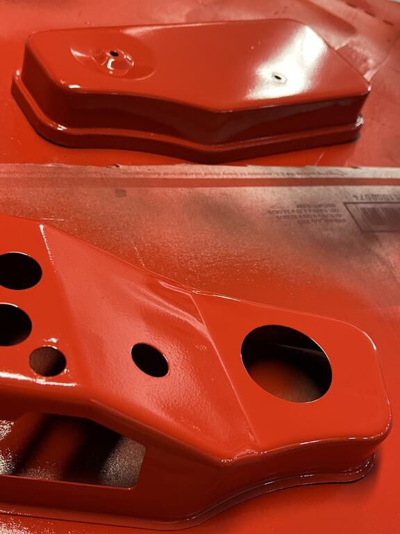

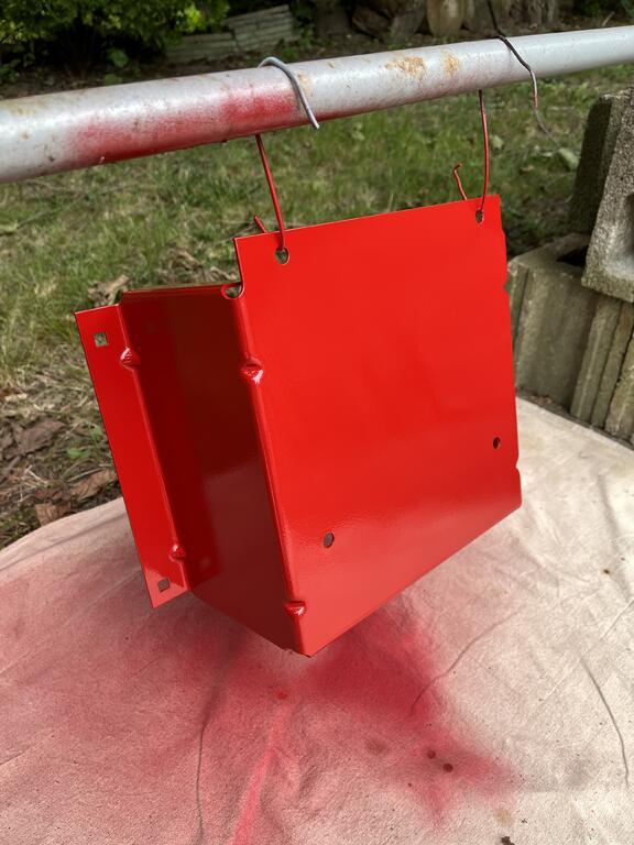

Alan173 321 #22 Posted September 7, 2022 More paint work. Worked out all of the last dents in the hood. Bondo applied to the areas with more significant pitting… 1 3 Share this post Link to post Share on other sites
Alan173 321 #23 Posted September 7, 2022 Additional photos: 3 4 Share this post Link to post Share on other sites
