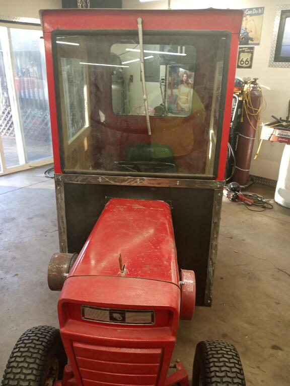

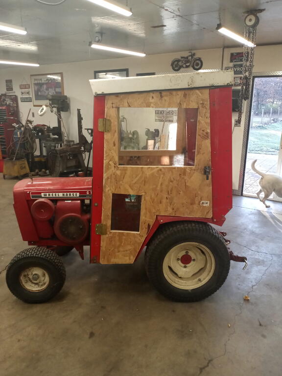

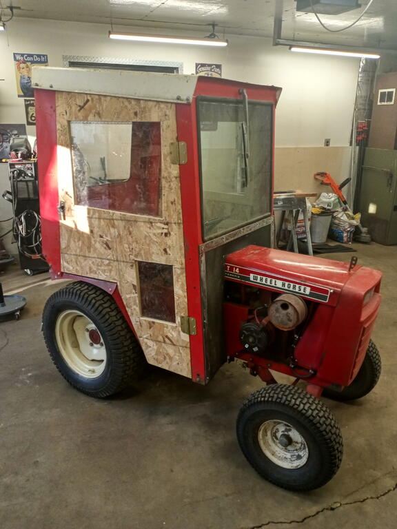

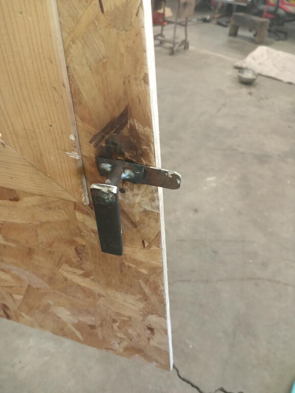

mr biggs 187 #1 Posted November 5, 2020 Made some lead way on the cab today , got the doors on, the Windows cut out & trimmed ,also I had to make some homemade door handles everything's turning out good .... So I'm excited about trying her out sometime this winter! few more things to go need some paint and wire in my lights and heater and should be ready to take on old man winter 4 9 Share this post Link to post Share on other sites

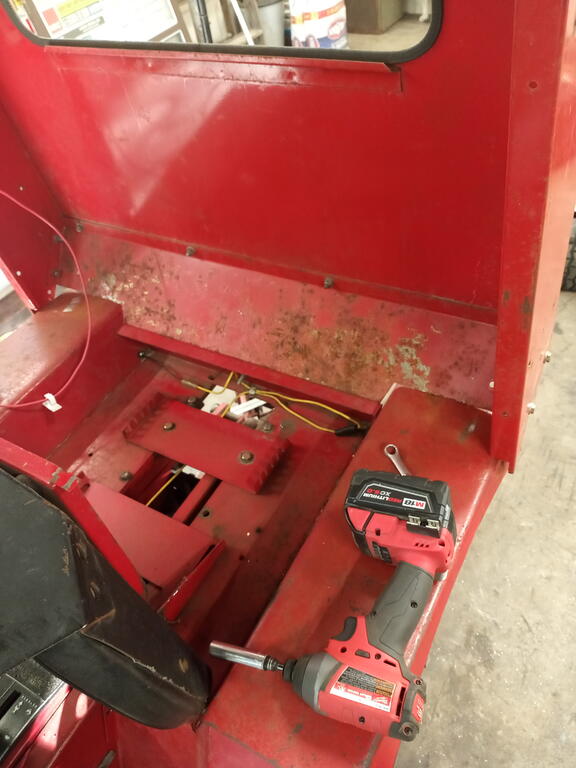

mr biggs 187 #2 Posted November 5, 2020 Few more pics 3 4 Share this post Link to post Share on other sites

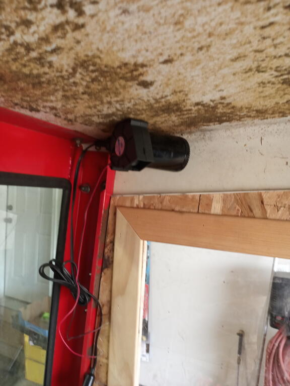

jeremi3210 758 #3 Posted November 5, 2020 (edited) Looks nice! What you gonna use for a heater? I just take a flexible dryer vent and take some of the air off the engine to heat my cabs. Edited November 5, 2020 by jeremi3210 4 Share this post Link to post Share on other sites
Pullstart 71,329 #4 Posted November 5, 2020 I this whole piece custom? I don’t recognize the hard back or front, but then again I’ve never had a cab. 1 Share this post Link to post Share on other sites

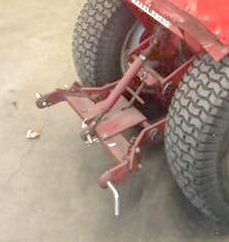

Alex175 785 #5 Posted November 5, 2020 A bit off topic, but I have a question about the 3 point hitch, is that an adapter to make it a cat 1 size, or something else entirely? Never seen one quite like that but I like it. 1 Share this post Link to post Share on other sites

mr biggs 187 #8 Posted November 5, 2020 3 hours ago, jeremi3210 said: Looks nice! What you gonna use for a heater? I just take a flexible dryer vent and take some of the air off the engine to heat my cabs. I have a 12 volt hair dryer hooked up to a heater hose with fan 🤭 1 2 1 Share this post Link to post Share on other sites
mr biggs 187 #11 Posted November 5, 2020 3 hours ago, pullstart said: I this whole piece custom? I don’t recognize the hard back or front, but then again I’ve never had a cab. No actually it's a cab off of a snapper 1655 it's actually a pretty cool looking little tractor , and it's the same width as the Wheel horse gt14 pretty rare to find a cab with a snapper but I made it work 5 1 Share this post Link to post Share on other sites

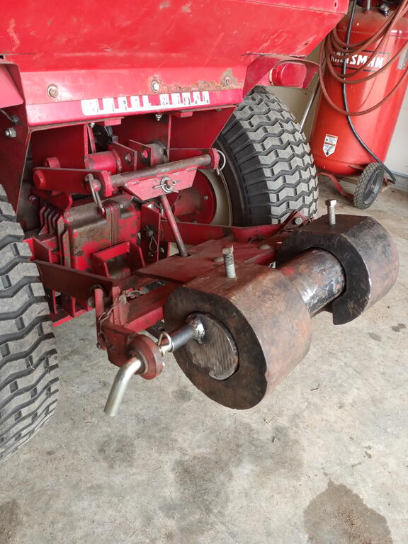

Herder 2,356 #14 Posted November 6, 2020 20 hours ago, mr biggs said: Ok like what ? Could you provide some details and pics of the 3 point hitch and drawbar. The drawbar it self is rather unusual, I've never seen one of that style. Is it specific to an attachment that you have? Thanks. 1 Share this post Link to post Share on other sites

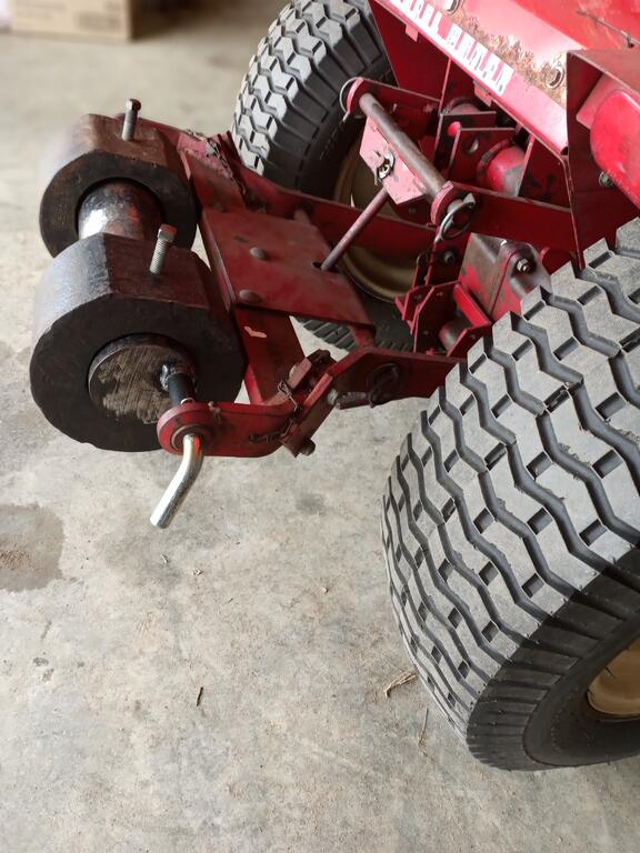

mr biggs 187 #15 Posted November 7, 2020 Few pictures of my three-point hitch and the new weight bracket I made to hold a 60 style simplicity factory counter weights 1 Share this post Link to post Share on other sites
mr biggs 187 #17 Posted November 7, 2020 Snow cab and a few pics of the 12 volt hair dryer and computer fan hook up , to heat my cab LOL 1 2 Share this post Link to post Share on other sites
