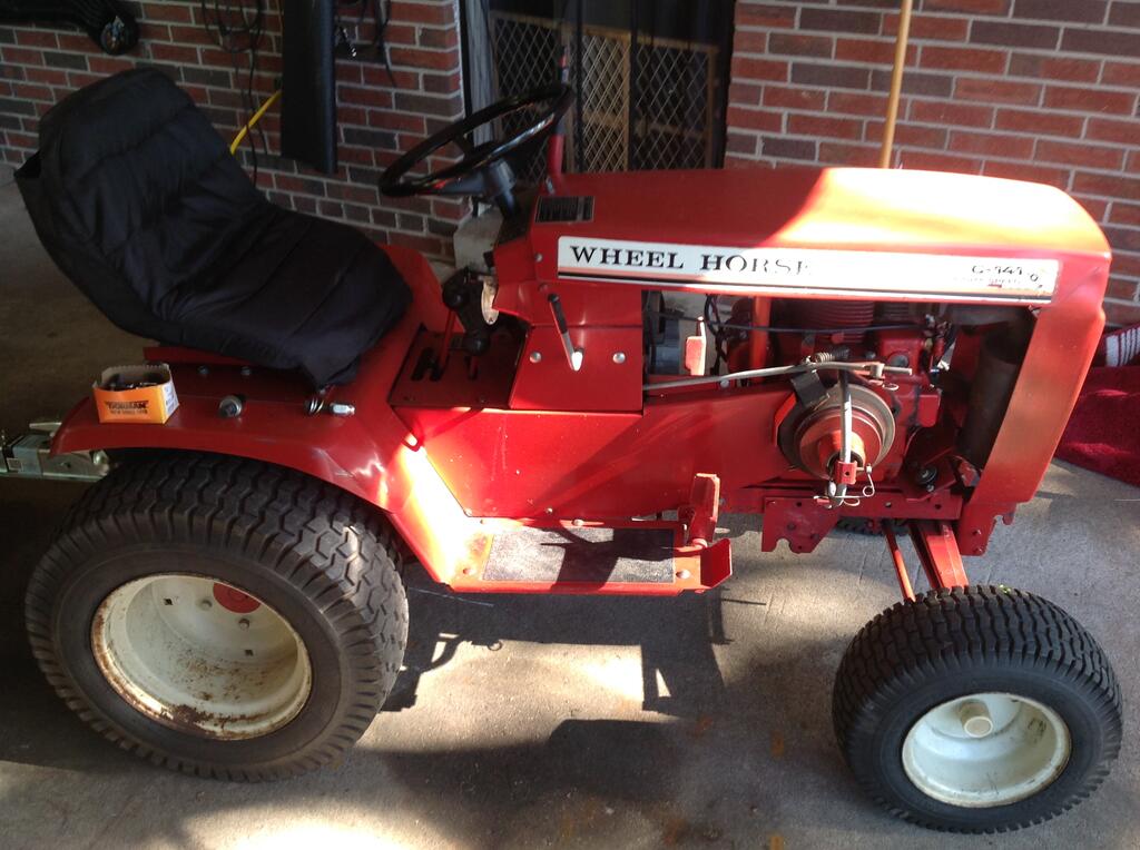

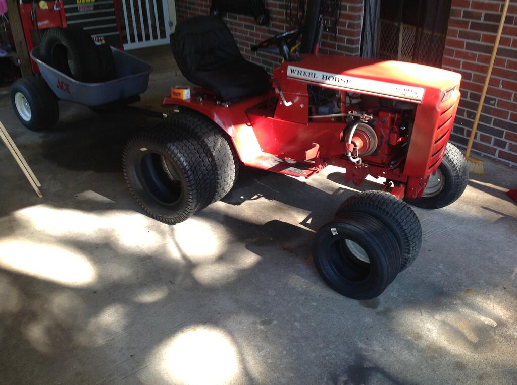

scWHhauler 96 #1 Posted November 5, 2020 Hay all got some new tires and wheel studs for the landing gear 😀On the 141. What do think should I leave the wheels as they are that matches the patina or sand blast them and paint. Also where can I get the tie rods that have the heim joints. 1 Share this post Link to post Share on other sites
mr biggs 187 #2 Posted November 5, 2020 They look a little smaller 🕵️♀️I'm the exact opposite go bigger or go home !! but something new for the old girl is always good thing , 👍 5 1 Share this post Link to post Share on other sites
Sparky-(Admin) 26,694 #3 Posted November 5, 2020 Me personally....I would paint the rims almond/linen beige 2 1 Share this post Link to post Share on other sites
oldredrider 2,554 #5 Posted November 5, 2020 You have the solid rear wheels. Paint them up and show em off. 2 Share this post Link to post Share on other sites

ohiofarmer 3,529 #7 Posted November 5, 2020 Those wheels would be easy to paint because of being solid. first, jack up the tractor and use the engine to spin the wheel. Sand her down starting with 100 grit or so, spot prime with rustoleum red primer. Let the air out of the tire and force those super thin grocery bags between the rim and the tire. Now the fun begins. Use the engine again to spin the wheel and spray on a coat of primer [sanding optional] , and then apply paint. The solid wheel makes it easy because no spray is gonna get through. I spin paint all my wheels and it is super fast and easy. I just use a transmission/wheel/tire from a MTD piece of junk stood on its side and comfortably paint while standing 2 1 Share this post Link to post Share on other sites
