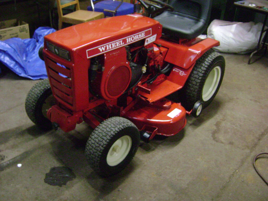

ohiofarmer 3,529 #1 Posted November 5, 2020 (edited) Well, she is only half way home. the funny thing about this one is she went unnoticed for a month or so with no takers. I did not find a tag on it except a tower patch c-160 and side generic WHEELHORSE decals. She is barn kept 8 speed, no big leaks no rusty paint , and we tested the beast and it cranked and had compression. the owner had it at his dad's because Dad did not want a zero turn. Just one of those things where the guy could not figure out why she won't start.and dropped the price when it did not sell, It has a RD42 completely rust free . I am leaning toward a clutch safety start circuit since i found a broken wire. My buddy and i hauled it only part way home as he was busy, so we will seemore tomorrow. i have been waiting forever for one like this. i thought that this year was a complete bust for finding tractors, but some nice ones found me. Edited November 5, 2020 by ohiofarmer 10 8 1 Share this post Link to post Share on other sites

ebinmaine 81,155 #3 Posted November 5, 2020 No hood ornament so it should be a '76 or '77. VERY nice find!! Share this post Link to post Share on other sites

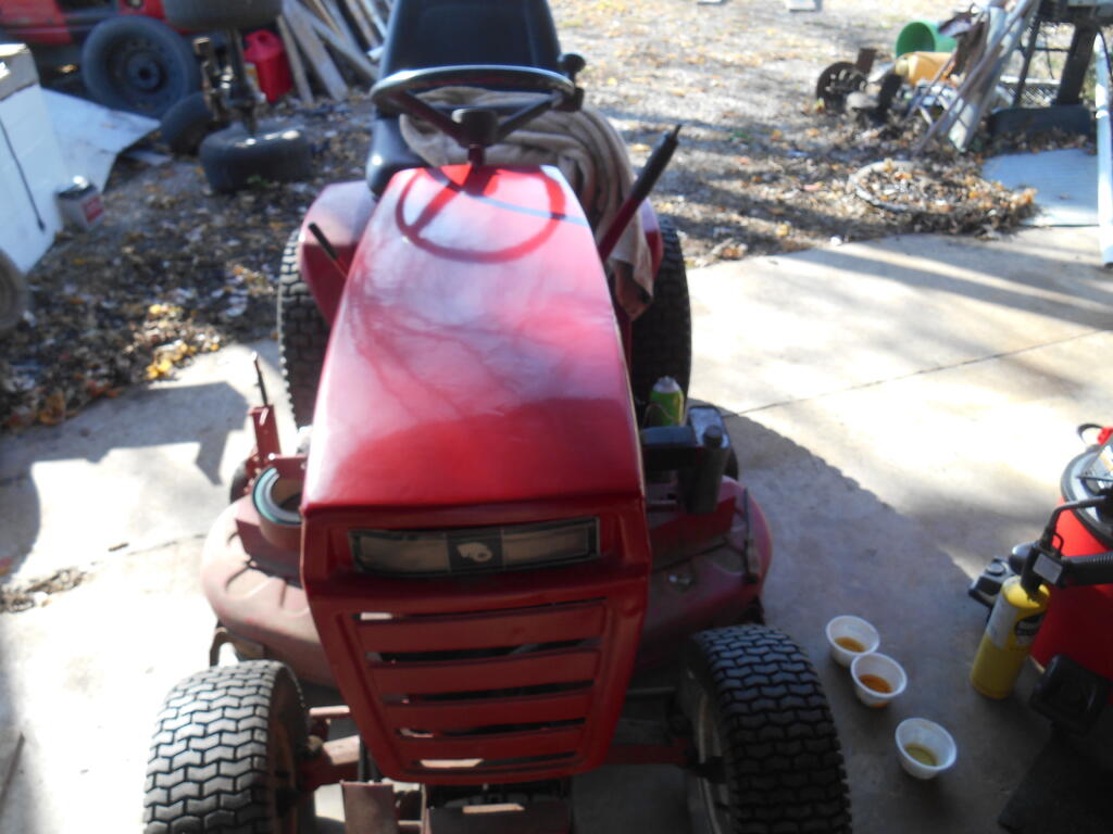

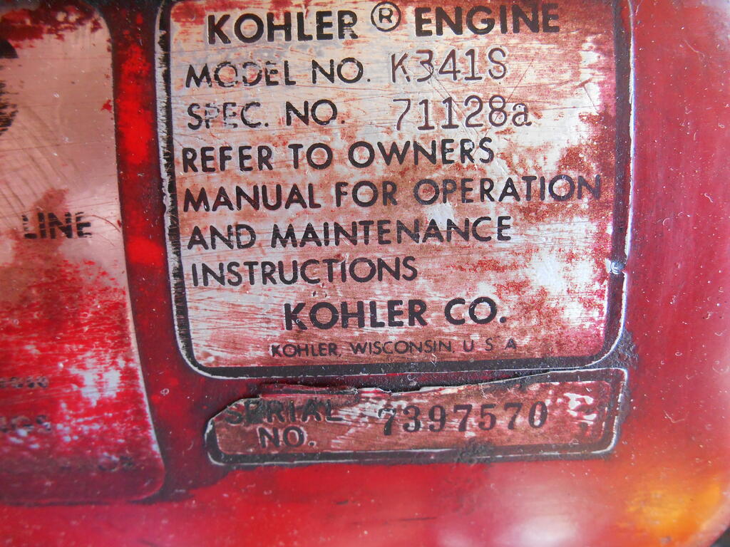

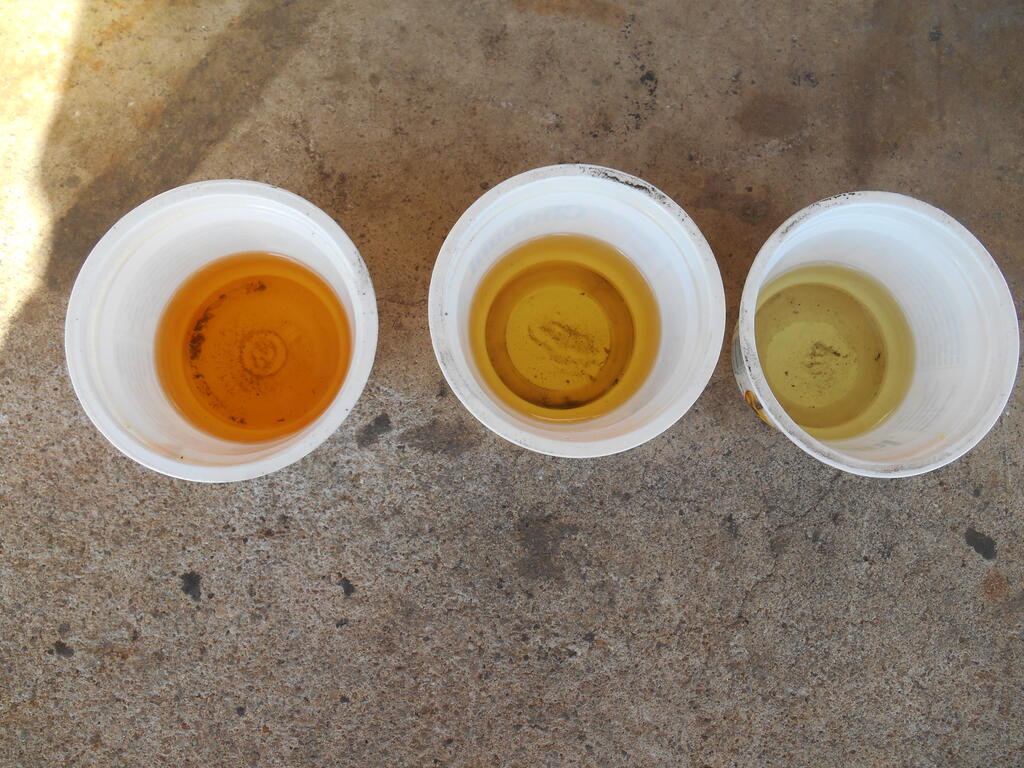

ohiofarmer 3,529 #17 Posted November 8, 2020 Well, guys it is not as simple as adding gas and fire it up, look at these three gas cups. i removed the tank, and the cup on the left is what was there. Darker than morning pee and did not smell as good. The other cups are rinsing the tank, but still that black dirty stuff is present. Just nasty. The fuel line is very dirty and may need replaced. i got some info on the engine. I carefully rubbed through the paint overspray with Scotchbrite [does anyone ever use masking tape?] and here it is. 2 Share this post Link to post Share on other sites

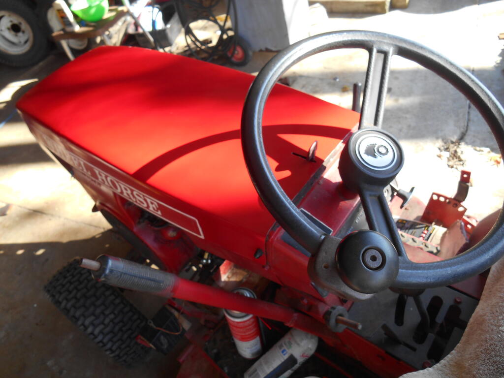

ohiofarmer 3,529 #18 Posted November 8, 2020 i had a few minutes to spend on the hood. the paint on this tractor is faded some, but is thick enough to work with. i started with a bit of Marvel, but there was some imbedded dirt and stains. I got out some 1000 grit paper and sort of sanded it, Marvel and all, then decided to just water sand it a bit more. The color came back and most of the paint inclusions are gone. After the initial sanding, the paint feels smooth as butter. I have a DA polisher, so i hit it with that, but my polishing compound has very little cut. There is some reflecting gloss present. i don't know jut how much i should polish the paint anyway for the fact that it looks sort of marble- like. i think that they sanded the hood and blotches of paint may have remained and telegraphed through. The overlying paint is in too good of shape to just oil it down for a patina look,because there is really no patina I have no desire to strip it down, because it is a worker. Anyway, I have it to a nice smooth semi-gloss and if i polish it much more, all the flaws will pop out and show. The second picture shows the reflectance properties, as the tree branches can be seen The wiring is a bit cobbled at this point. the PO fed the hot leads off the energized side of the solenoid. The light switch feeds the ignition coil. There is a push button starter. And also I found that the condenser was wired to the wrong side of the coil, so the points would not even produce a signal It all works out , however. this machine would have sold in a hurry in running condition. As it was, the owner said he had only one call from a collector and no one came and looked. He first asked 500 and then lowered it to three fifty.. When you see a nice tractor like this for that price in the ad , it is time to jump right at it. I told him i would be there at whatever time he chose and everything worked out. Anyway, she might be running this afternoon, with a temporary gas tank that is clean and the wiring sorted a bit 5 2 Share this post Link to post Share on other sites
ebinmaine 81,155 #19 Posted November 8, 2020 2 hours ago, ohiofarmer said: The fuel line is very dirty and may need replaced One of the things that we as a group need to put on our baseline beginning repair and maintenance list is Replace the fuel line. Don't think about it. Don't look at more than to diagnose as you are. Just take it off the tractor. Between PO lack of maintenance and the damages ethanol does it just NEEDS to be done. I've seen ethanol start eating black rubber line in less than 2 years. That C160 looks great! An excellent find. Once you put a few hours on it you'll be more and more impressed. There's a thread in Electrical that shows all the wiring diagrams you'll need. Nice schematic diagrams for several different tractors. 1 1 1 Share this post Link to post Share on other sites

clueless 3,440 #21 Posted November 8, 2020 Did you drop the cab bowl and clean it good? From the looks of the stuff in the bottom of the cups with gas some of that can be in the bowl. If you don't clean out the bowl when you do start it it will suck up any of those small particles into your jets . 2 Share this post Link to post Share on other sites
c-series don 12,656 #22 Posted November 8, 2020 I’m with Eric on replacing the fuel line. A few years ago I bought an entire roll/spool of fuel line and a double male brass barbed fitting. For the 78 and newer tractors I disconnect the line at the fuel pump, connect the new line with the old with the barbed fitting then cut the line at the tank. It is then relatively easy to pull the new line through while pulling the old one out. I cut the line at the tank and then slit the old line on the tank fitting with a razor blade so as to not disturb the tank fitting to much. Good luck with your beautiful C-160! 3 Share this post Link to post Share on other sites
ohiofarmer 3,529 #23 Posted November 8, 2020 I used the harbor freight fuel line pliers and they work off pretty easy. A tiny slit at the end helps. CS Don, yes i took the carb off and it was a new one he replaced with old rotten fuel, so i just did a clear out with some gasoline soak and air compressor. i will hook up clean fuel and cycle it through new line through the pump, then the carburetor. For now, just gonna hang a mini tank higher than the carb and do some hasty wiring and hope it fires up. I have replaced some fuel lines with clear blue plastic stuff that seems to get hard in a hurry, bought it at a lawn mower shop and that is what they use. what do you guys use and perhaps you could mention where to buy it? I did get three other tractors in the last little while. Two c-145 class and a c-121. I should buy 5 carb kits, fuel filters, a few inner tubes, some head gaskets, and possibly a coil. It is a good problem to have. BTW, i just saw another 161 come up and missing a starter for short money. Mine is a hundred more than that one, but if the engine is OK at all, then worth it. i gotta call my buddy on this one. divorces are expensive 2 Share this post Link to post Share on other sites

Lee1977 7,809 #25 Posted November 11, 2020 I used OxI Clean to clean two rusty metal gas tanks with bad gas, I did both in June or July and had summer heat to help out. It's hard to believe how much old varnish came out. Rinsed out both numbers of times and still had to change fuel filters 4 or 5 times in the next year because of fine rust clogging the filter. In the Wheel horse tank I would use 1/4 cup of Oxi Clean and hot water then give it a day or so to work.. May need to do it twice then rinse several times the plastic tank should come clean. 1 Share this post Link to post Share on other sites
