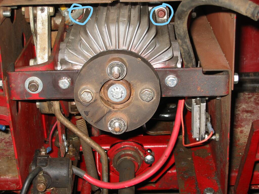

pfrederi 21,176 #9 Posted November 2, 2020 Do you mean the bolts like the ones I circled (two more down low out of site) Note the shallow fins are up on a D series They are down on other models... Share this post Link to post Share on other sites
JSterletD200 0 #10 Posted November 2, 2020 the bolts we are talking are inside. also the 2 D series hydrostat pumps we have are opposite fins than you have.... will try to upload a pic. Share this post Link to post Share on other sites
pfrederi 21,176 #11 Posted November 2, 2020 Interesting on the fins but I suppose it really would not make a difference. Take a look at this thread. Share this post Link to post Share on other sites
