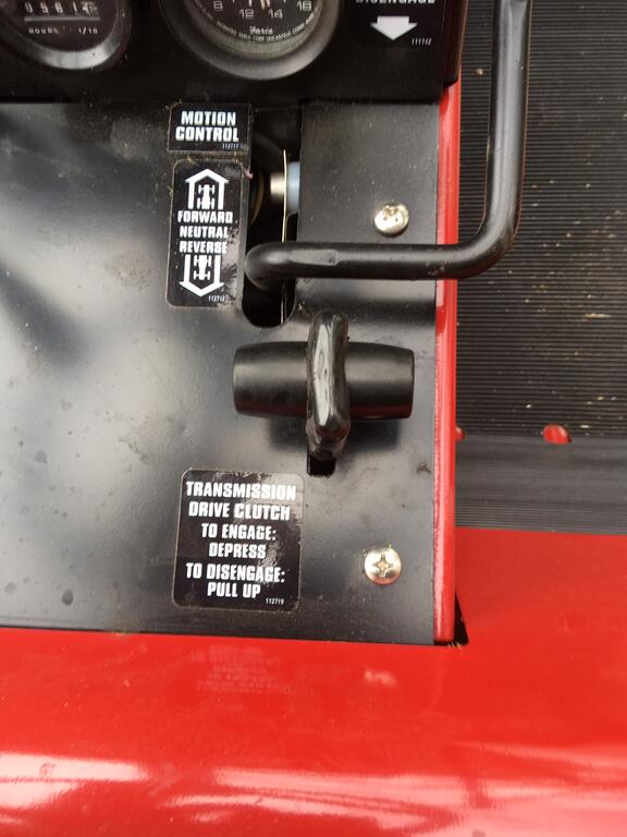

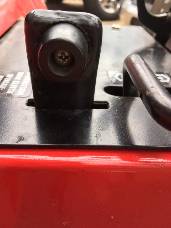

Tgalo 128 #1 Posted November 1, 2020 Well I finally stopped that drive belt release handle on the 418 from rattling with a rubber handle covering.... lol 11 Share this post Link to post Share on other sites
Sparky-(Admin) 25,938 #2 Posted November 1, 2020 Looks like a great fix! Not crude at all Share this post Link to post Share on other sites
daveoman1966 3,884 #3 Posted November 1, 2020 Who said "Creativity is the Mother of Invention"? Share this post Link to post Share on other sites
WheelhorseBob 1,550 #4 Posted November 2, 2020 Damn I’ll have to do that to my C-161. Damn lever drives me nuts! 1 Share this post Link to post Share on other sites
daveoman1966 3,884 #5 Posted November 2, 2020 My old Bronco 14 had the same nerve-racking rattle... Fixed it with a short spring. In the 'UP' position as shown, slight spring tension is all it needs. There is just a little bit more tension when the lever is pushed DOWN...stops rattle either way and the spring doesn't interfer with the motion control lever at all. Share this post Link to post Share on other sites
