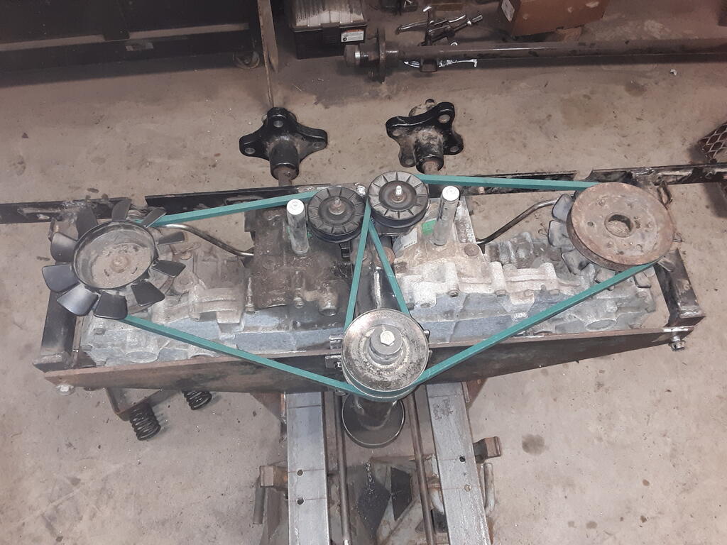

This is my belt routing. Am I better off with a clogged belt or different idler placement?
Lee1977
You don't have enough of the belt around either the drive or driven pulleys
Stormin
Are the idlers fixed or tensioned by springs?
Stormin
That's a good point.
Oldskool
That was my first thought when they started slipping.
Oldskool
The bolts they are on is in a slot for adjustment. Pull tight then tighten bolt
Lee1977
They are also at the wrong place.  Maybe a shorter belt with the idler between the pulleys.
Tractorhead
I think spring loaded been definitively better than just fixed mount idlers
Lee1977
 With a flat idler on the slack side of the driven pulley.
Oldskool
If I remember correctly at the time of putting that together the belts were going to hit bolts bosses on the casing and that's why I went with that configuration. I think it may be a struggle to get it the way it should be.

Handy Don
Judging by the fan blades, the center drive pulley is turning clockwise. Is that right?
If so, then on the right side the tension" side is correct--it is direct between drive and driven pulleys. But on the left, the "tension" is via the idler.
I can't see the interferences, but maybe like this?
You nailed it, but I cant get your diagram to work with the obstacles
Oldskool
1 hour ago, DennisThornton said:
With no video I have to ask.  How slow can the screws drive?  What happens when you go as slow as it will?
It will creep forward till the belt slips on one side then its fighting the other side
DennisThornton
Well then, so both screws aren't cooperating together.  Crap!  I was hoping to simplify this.  Guess it's back to the drivetrain.  Already read several ideas and possible fixes.  Small delay...
8ntruck
So, the seperate hydraulic drives are kind of acting like an open differential.  Sounds like cog belts might help to keep both sides going.
Tractorhead
Could the belt drive on the Jackshaft to the Gearboxes be changed to a Chaindrive instead of Beltfrive?
simplify‘s some things i believe.
That will be the simplest and quickest Way for max. traction on that Transmission.
i see no reason why not, because no Clutchfunction is happen or even wished here.
Edited by Tractorhead
Oldskool
Yes they can. It's something I'm contemplating. I'm running out of time and over budget at this point. I will see what I can scrounge up
