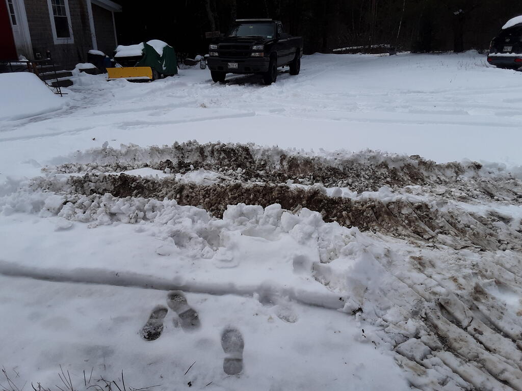

I did manage to make a mess of the driveway
SOMEHOW!  I missed this before replying...
Well, poop!  That does look more like there's more churning than moving.  Might need deeper screw threads.
