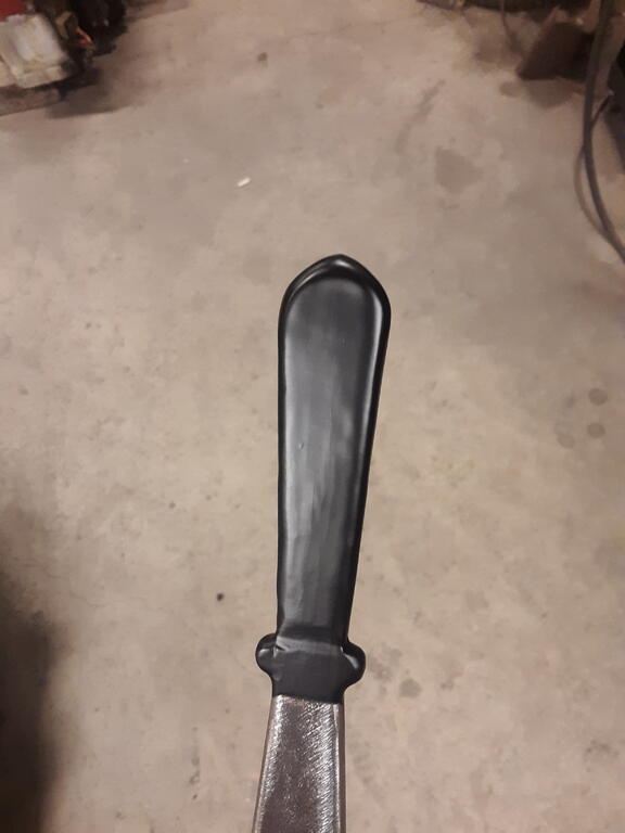

Never really used this tool dip. It seems to be doing ok. It's looking like it will have to be 4 dips to have a decent thickness to it though.
That's not a huge surprise.
I've only seen that stuff after someone else has coated a handle and I remember now thinking it was tad thin but straight and even.
Just keep dippin'.
Once it starts to solidify you can flip it so the drip goes down the handle away from the top. That way you don't end up with a dimple at the top from the drip. The stuff can easily be cut and removed wherever you want at the bottom so don't worry about any dripping down the handle or dipping too far. If you want to add a ridge to the bottom edge so it's not just a flat cut off edge when you're done, use a small rubber band after a few dips to make a ridge and dip once or twice more. Cut off right below the rubber band. Too many dips after placing the band will make it feather and not leave it as defined of and edge.
Not the end of the world if you don't like how it turns out as the whole thing will basically peel right off. It's kinda like liquid shrink tube, it just dries and shrinks but doesn't stick like crazy.
Smells the same as that liquid electrical tape stuff and can be used like shrink tube too.
Oldskool
@wallfish the last couple of dips I did start flipping it right side up to control the tip. That's a neat trick with the rubber band I will definitely remember that. Thanks.
wallfish
You can also roll up the edge of a layer dipped a little further than the first few, then one more dip to seal that up and hold it. That makes a nice ridge too but takes a little practice to get it right.

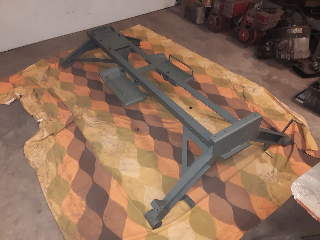

A little progress in the paint dept. It's going slow but moving along. I'm not really sure what this nonsense is about having to go to the grocery store or post office or......Doesnt she know I'm doing something really important 🤣🤣🤣🤣
I like the color!  Looks like there’s plenty of horsepowers in the background too!
Thanks. I like the color much more today then yesterday. Ya there are a few power plants kicking around here. 8 or 12 or so in this bay lol
Oldskool
14 minutes ago, DennisThornton said:
It does take several dips.  I've had some luck with the stuff though.
I put 4 dips on the handles. Now that they are dry I kinda like it. I also used some to fix a torn dampener boot. I put a couple wraps of electrical tape on it. Then brushed some tool dip over it. I like the results for that as well.

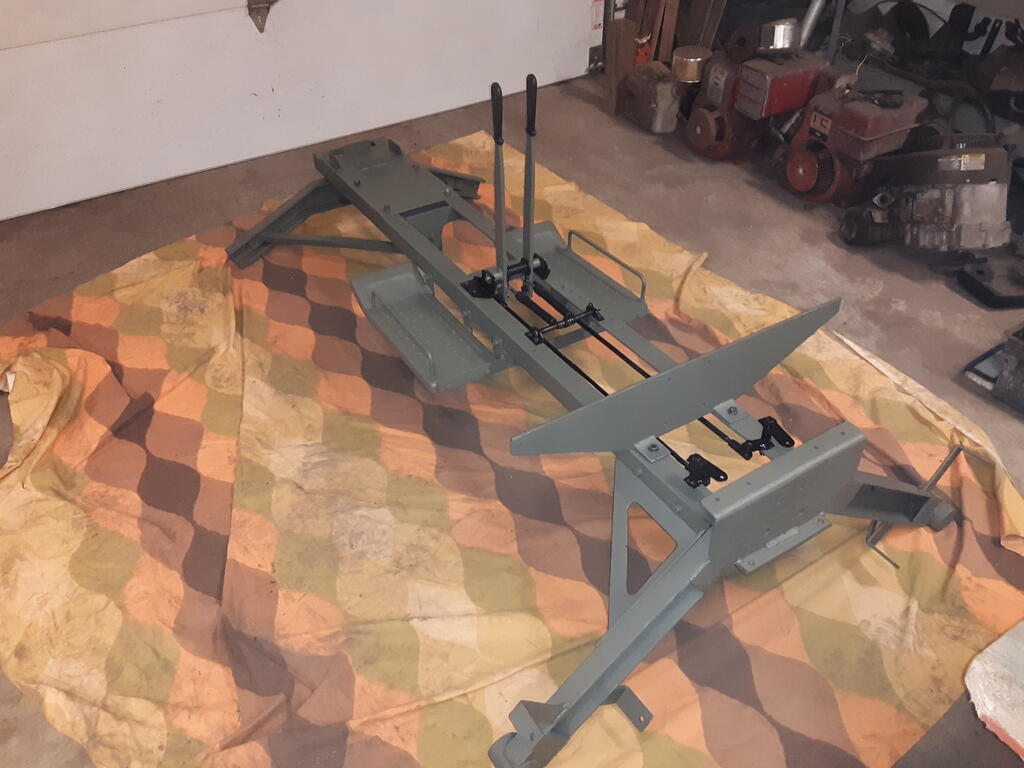

Oldskool
A bit more progress. I think it's a good place to stop for the evening.20210121_170648.jpg.1c44d41dffe82b8a39792b619727747d.jpg
