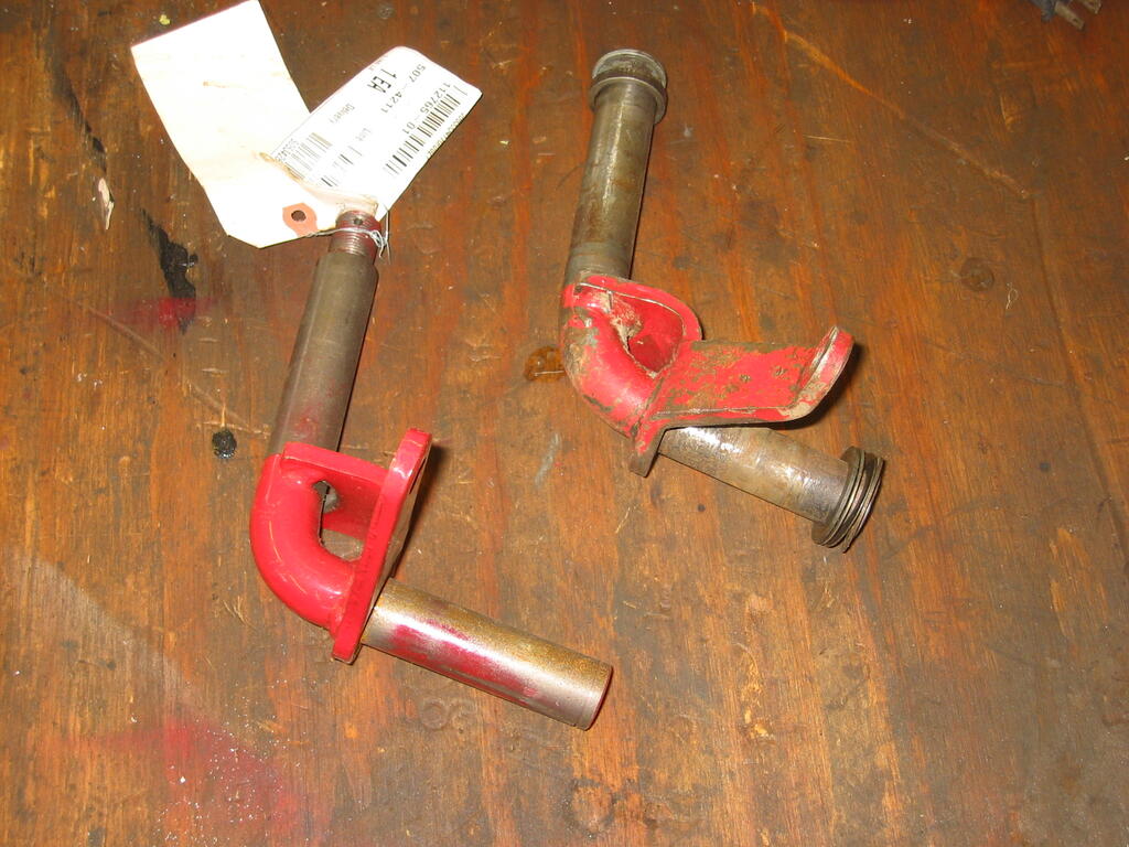

WheelhorseBob 1,550 #1 Posted October 31, 2020 (edited) Ok guys, I recently picked up a NOS D-series front axle assembly. I consists of the axle, 1” spindles and rims with bearings. If I were to put a 520 swept front axle in my 161, I could use the spindles and rims to make the heaviest C series front evah! Thoughts and has anyone done this? If this sounds foolish say so. I’m sure a D-series enthusiast would covet this front end. Edited October 31, 2020 by WheelhorseBob 2 Share this post Link to post Share on other sites

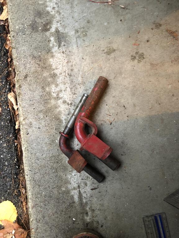

pfrederi 21,312 #4 Posted November 1, 2020 There may be an alignment issue for the tie rods. The D series spindles have a bent tie rod attachment plate, 520s are straight. 1 1 Share this post Link to post Share on other sites
WheelhorseBob 1,550 #5 Posted November 1, 2020 4 hours ago, pfrederi said: There may be an alignment issue for the tie rods. The D series spindles have a bent tie rod attachment plate, 520s are straight. I had considered that. I would make custom length tie rods anyhow. And the tie rod plate on the C161 Is shorter because the stock 3/4" spindles have the upswept tie rod mounts already. Share this post Link to post Share on other sites

WheelhorseBob 1,550 #7 Posted November 1, 2020 Based on comparing my C161 and 520 it looks to me like the D series spindles with a slightly longer set of tie rods would work perfectly with a 520 swept axle. The geometry seems close. IDK, I really don’t need a heavier front on the 161 for my use. Just thinking of a way to use the NOS parts I have.... 1 Share this post Link to post Share on other sites
