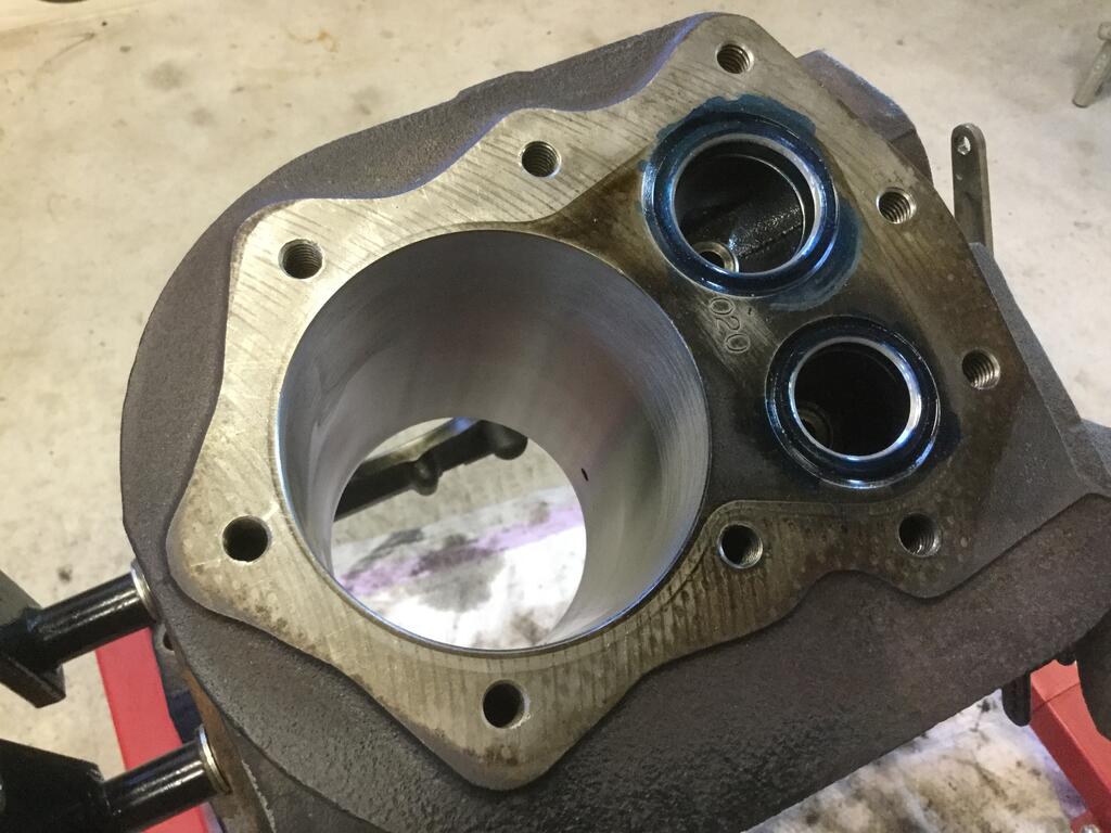

tntatro 181 #1 Posted October 31, 2020 (edited) Hello, I have a K241 that I got a while back. The seller said this one smoked and knocked. I finally got around to taking it apart and the specs do not look real bad but the top of the bore has more wear than the rest. At the top about 1/4" down where the top ring would be at top dead center the bore measures .006" over, about 1/2" down where second ring would be it measures .004" over, at the oil ring it's .003" over. Just below where the rings would be at top dead center of bore it's .002" over. At the middle of the bore it's .0015" over at the very bottom there is not much wear. Worn cylinders I've done in the past were worn more in the middle than the top. Does this cylinder need to be re bored? I know that by the book it does based on the wear limit and out of taper but the wear is different than I've seen from the few other engines that I have done. This engine has a standard bore and the crank pin is standard but a little out of the wear limit. The camshaft and crankshaft end play are in spec so not sure where the knock was coming from. There is no scoring on the crank pin and the valves do not look very worn. I'm guessing someone did the valves and replaced the piston at some point because the piston is just out of spec and well within the wear limits. If the rod looks good with a plasti gauge test then I was hoping to check the rings and put it back together, I'm not sure about the wear on the bore though. Edit: I had to edit the post. Originally I wrote .015" for the measurement in the middle of the bore which was a typing error. I changed it to .0015". Sorry for the confusion. My concern about the bore is the top 3/4" and how it tapers from .003" to .006" in that short section and if that indicates that it really needs to be re bored. The rest of the bore is within the wear limits. Edited November 1, 2020 by tntatro Share this post Link to post Share on other sites
squonk 47,423 #2 Posted October 31, 2020 Bore it. I haven seen a Kohler yet with any run time that didn't need a rebore. Did you check out of round? 2 Share this post Link to post Share on other sites

squonk 47,423 #7 Posted November 1, 2020 With most engines, the maximum wear occurs right below the ridge line with the most amount of material removed in the downward thrust side. Share this post Link to post Share on other sites
tntatro 181 #8 Posted November 1, 2020 3 minutes ago, squonk said: With most engines, the maximum wear occurs right below the ridge line with the most amount of material removed in the downward thrust side. So that is normal wear? I've only done between five to ten K series single cylinder rebuilds and most of them were worn in the middle of the cylinder from front to back.The odd thing about this one is that it gets a tiny bit wider above where the piston ring reaches at the very top 1/4". Share this post Link to post Share on other sites
squonk 47,423 #9 Posted November 1, 2020 The areas 90degrees from the wrist pin wear the most. These are where the piston thrust surfaces contact the cylinder walks Share this post Link to post Share on other sites
lynnmor 8,915 #10 Posted November 1, 2020 Yep, your cylinder is wore out. Make sure that you have a good air filter and change the oil often to prevent this kind of wear. Share this post Link to post Share on other sites
tntatro 181 #11 Posted November 1, 2020 I just checked my notes and the ones with the most wear in the middle of the bore were only the ones with excessive wear. The rest were kind of random. I wonder if this one was run with a blown head gasket or something that caused the top to wear so much. Then someone cleaned it up and put a new piston in maybe. I guess it needs a .010" piston. I was hoping to get it fixed really cheap because I'm just going to sell this one. Share this post Link to post Share on other sites
tntatro 181 #12 Posted November 1, 2020 8 minutes ago, lynnmor said: Yep, your cylinder is wore out. Make sure that you have a good air filter and change the oil often to prevent this kind of wear. Yeah, that makes sense that if it just wasn't well maintained and debris was making it's way in also, then that would cause wear at the top. I was told it came off a Jacobsen Chief. It's in better shape than what I expected though, the last engine I got off the same guy that he said smoked and knocked was way out of spec on the bore, crank pin and the valves were really worn. Share this post Link to post Share on other sites

squonk 47,423 #20 Posted November 1, 2020 Tapered wear is pretty normal on any engine. Share this post Link to post Share on other sites
