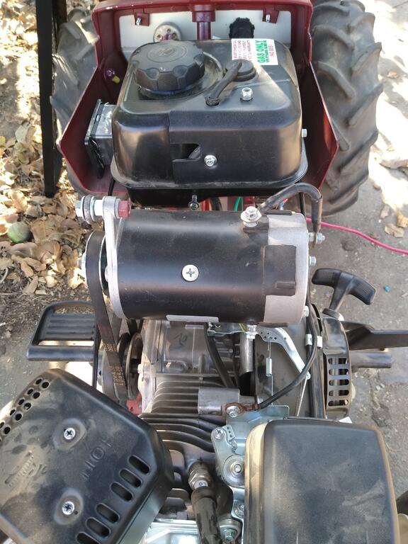

Vurge 158 #2 Posted October 31, 2020 The Predator 212cc tank fits pretty well in the original spot on my 606. Share this post Link to post Share on other sites

Vurge 158 #4 Posted November 1, 2020 Here's what it looks like in my 606. 1 1 Share this post Link to post Share on other sites
haydendavid380 759 #5 Posted November 1, 2020 19 minutes ago, Vurge said: Here's what it looks like in my 606. That fits pretty well Share this post Link to post Share on other sites

sqrlgtr 3,860 #8 Posted November 1, 2020 (edited) 19 hours ago, Vurge said: Here's what it looks like in my 606. would like to see some more pictures of hat S/G set up on that predator......sorry dont want to hijack thread pm me if u want to. Edited November 1, 2020 by sqrlgtr Share this post Link to post Share on other sites
Vurge 158 #9 Posted November 2, 2020 2 hours ago, sqrlgtr said: would like to see some more pictures of hat S/G set up on that predator......sorry dont want to hijack thread pm me if u want to. More info and pic here: Share this post Link to post Share on other sites
