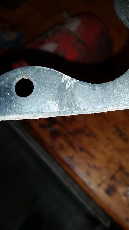

WHX?? 58,236 #7 Posted October 31, 2020 I recently ripped into this 161 that Pullstart give me. Bet ther ain't but 20 hours on this rebuilt motor. Head bolts seemed to come out easy and the gasket had signs. 1 Share this post Link to post Share on other sites

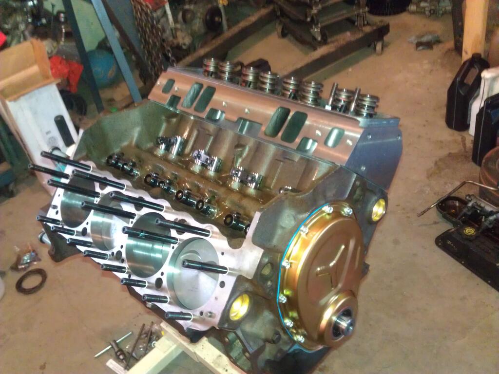

WVHillbilly520H 10,379 #14 Posted October 31, 2020 3 minutes ago, squonk said: Yes I do Do you "descale" and use some type of lubricant? When I built my little SBC, ARP sent their "lube in a tube" for the washers before installing the nuts (I studded my heads) or bolts for a more accurate torque. Share this post Link to post Share on other sites
