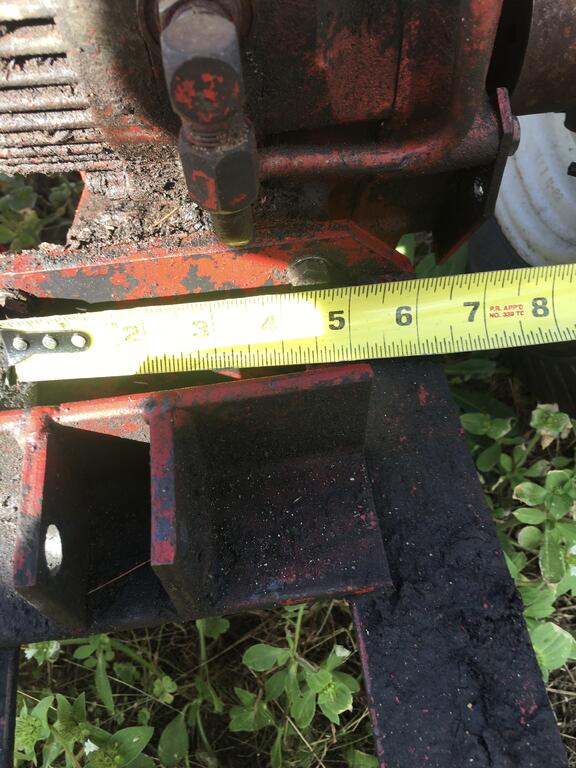

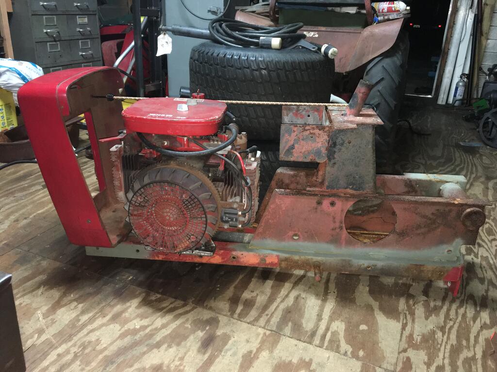

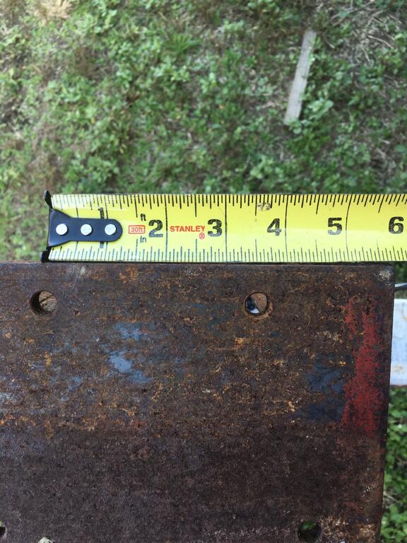

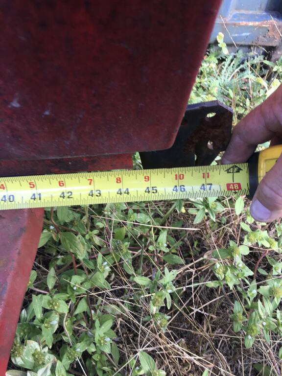

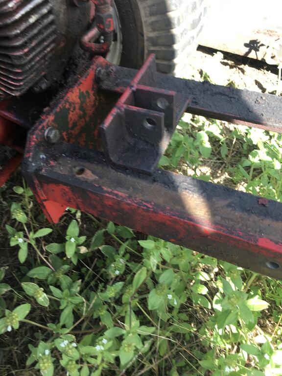

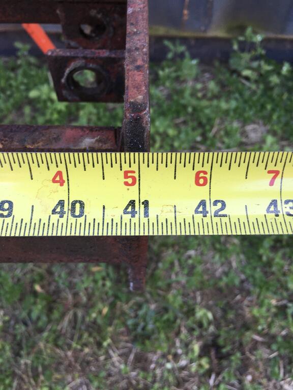

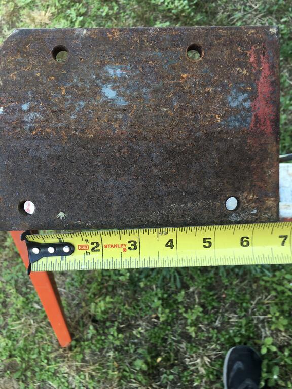

19richie66 17,892 #28 Posted November 8, 2020 Ok, here you go. 953/1054 frame length = 41-1/8” Gt14 frame = 44-1/2” *** The hydraulic cylinder mount on the gt14 frame is above the frame at the rear. 953/1054 hyd cylinder mount is below the frame to the rear. *** The bolt pattern for 953/1054 transaxle is 3-1/2” apart at the top, 5-1/2” apart at the bottom. *** The bolt pattern for the gt14 and all other transaxles is 4-1/2” apart, top and bottom. 3 Share this post Link to post Share on other sites
Pullstart 70,081 #29 Posted November 9, 2020 (edited) Clearly this won’t be a drop in swap! Edited November 9, 2020 by pullstart Photograph Share this post Link to post Share on other sites
ebinmaine 79,106 #30 Posted November 9, 2020 6 hours ago, pullstart said: Clearly this won’t be a drop in swap! This, I know. More room in a C series setup and mines just barely gonna leave enough room to do an oil filter swap. Watch for that on yours. I'm thinking if you get a couple BIG leverage bars it should fit. 1 Share this post Link to post Share on other sites
19richie66 17,892 #31 Posted November 9, 2020 Nah, don’t do it. Wait ...... did I just say that? I wouldn’t hack it. 2 Share this post Link to post Share on other sites
953 nut 66,514 #32 Posted November 9, 2020 8 hours ago, pullstart said: this won’t be a drop in swap! Don't think the extra 3" from a GT-14 frame and hood will do it. May need a bigger shoe horn. 1 Share this post Link to post Share on other sites
ebinmaine 79,106 #33 Posted November 9, 2020 12 minutes ago, 953 nut said: Don't think the extra 3" from a GT-14 frame and hood will do it. May need a bigger shoe horn. You figure about an 8-ft crowbar would work? Share this post Link to post Share on other sites
Pullstart 70,081 #34 Posted November 9, 2020 36 minutes ago, 19richie66 said: Nah, don’t do it. Wait ...... did I just say that? I wouldn’t hack it. I can’t hack this one up, but there are more that wouldn’t mind a grinder and a welder! 1 Share this post Link to post Share on other sites

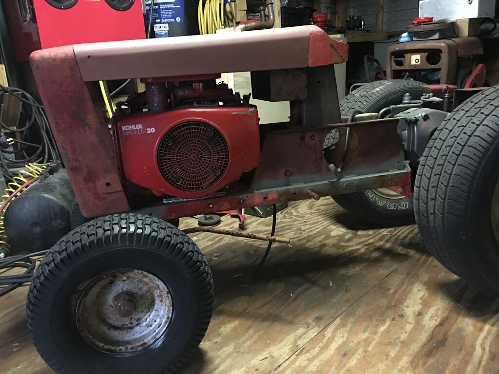

19richie66 17,892 #35 Posted November 9, 2020 2 hours ago, 953 nut said: Don't think the extra 3" from a GT-14 frame and hood will do it. May need a bigger shoe horn. The M20 just barely fits with the gt14 frame. You would need a frame and hood stretch. 3 1 Share this post Link to post Share on other sites
