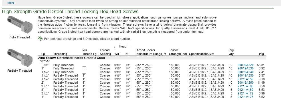

Achto 31,537 #6 Posted October 27, 2020 53 minutes ago, tallen4392 said: Does anyone know if I can swap out the front wheel spindles on my c-81 to the type that has the bolt and washer holding the wheel on instead of the c clip and what model might work. ...THANKS Yes the older spindles will work. As another option, you could drill & tap the ones that you have. used a 3/8 - 16 bolt about 3/4" long. 2 1 Share this post Link to post Share on other sites
