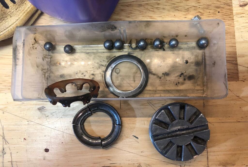

3WHDave 60 #3 Posted October 26, 2020 Thanks Pacer. I may have miscommunicated, or I'm not understanding the above info, but the bearing race I need is the bottom one which sits inside the adjustment "cap". See picture below. Thanks, Dave Share this post Link to post Share on other sites
pacer 3,181 #4 Posted October 26, 2020 Ouch! I've never had that happen --- there was/is? somebody on the bay that had that and the balls available, might dig around on the bay and see. This Ross steering was used on MANY garden type tractors, JD, cub, Ford, MF. etc so spread your search for other than WH, Maybe just try Ross steering. Share this post Link to post Share on other sites

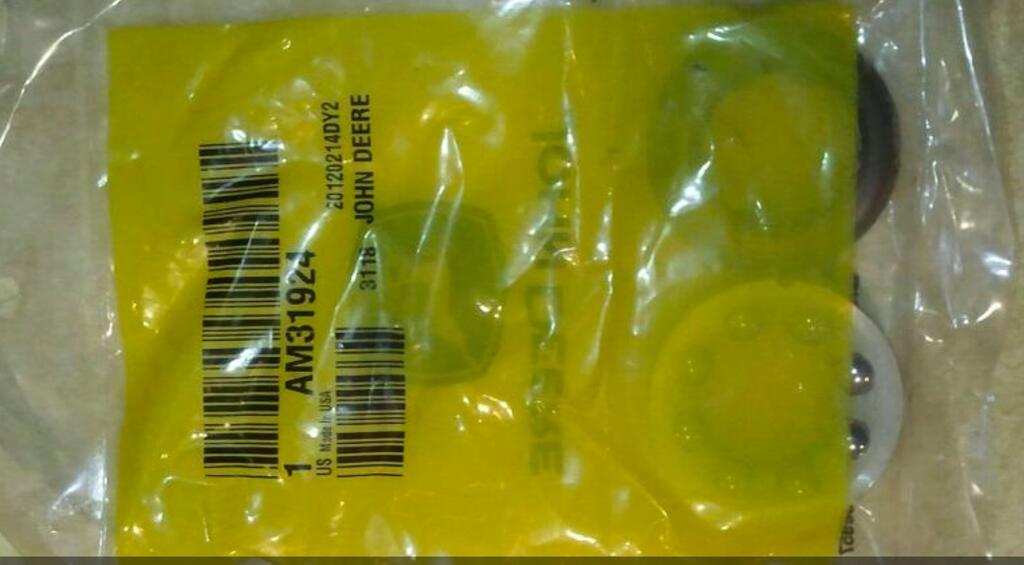

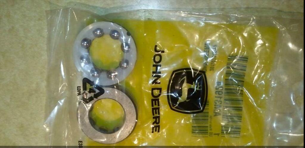

3WHDave 60 #6 Posted October 26, 2020 Pacer, Thank you so much for your time and input. I'm writing to let you know that I discovered that the John Deere Ross bearing kit # AM31924 is a match! I bout one through HamiltonBobs Cubs. they can be reached at (513) 582 8424. I spoke with Matt and I must say, they have great customer service. They are FedEx'ing the parts to me so that I can put the unit back together and regain my garage space for the vehicle that belongs there! I will post a picture of the John Deere package I found on the internet for reference (mine is in the mail). Dave Share this post Link to post Share on other sites
