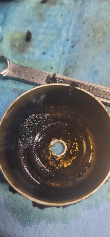

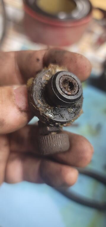

ebinmaine 80,629 #27 Posted October 26, 2020 What's up with the fuel pump? Any pics? Share this post Link to post Share on other sites
AHS 1,698 #28 Posted October 26, 2020 3 hours ago, ebinmaine said: What's up with the fuel pump? Any pics? Mud dobs...on the outlet side. it’s a metal one... the good ones! I don’t want to throw it away....... but here’s a thought just throwing the fuel pump into the gunk carb cleaner?? Share this post Link to post Share on other sites
ebinmaine 80,629 #29 Posted October 26, 2020 50 minutes ago, AHS said: Mud dobs...on the outlet side. it’s a metal one... the good ones! I don’t want to throw it away....... but here’s a thought just throwing the fuel pump into the gunk carb cleaner?? You'll probably be able to just pick that stuff out of there with a unfolded paperclip or something but it would be a lot better to remove it from the fuel pump and clean it out with a small wire brush or q-tip Most likely will be usable once cleaned 1 Share this post Link to post Share on other sites

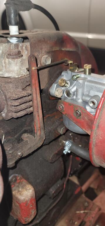

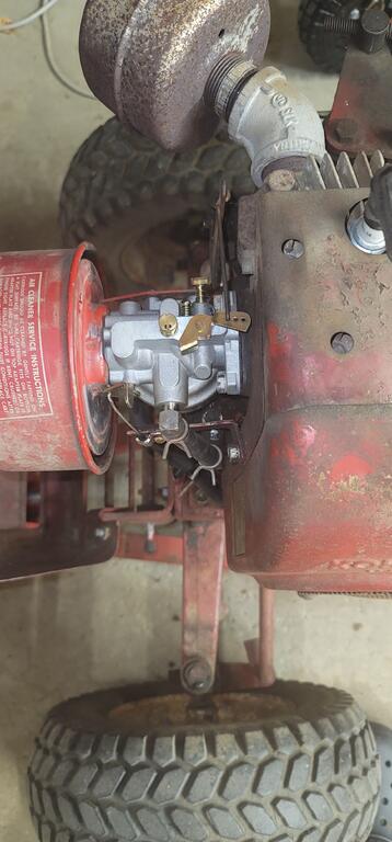

AHS 1,698 #43 Posted November 7, 2020 Ok, I’m ready to install the carb... it came with the carb, the linkage rod in a box. Ok can some one show me, with a picture, what the linkage rod looks like installed on a B80 from the gov rod to the carb? I dunno if I have it right side up or what! Thank you!😀 Share this post Link to post Share on other sites
AHS 1,698 #45 Posted November 7, 2020 Cool! On the carb.. is it on the second hole? @haydendavid380 thank you!!! Share this post Link to post Share on other sites

ebinmaine 80,629 #49 Posted November 8, 2020 10 hours ago, AHS said: Cool! On the carb.. is it on the second hole? @haydendavid380 thank you!!! 10 hours ago, haydendavid380 said: @AHS that's an aftermarket replacement carb and the settings may be different. I can get a couple pics of Patriot Horse once it gets light outside. Share this post Link to post Share on other sites
AHS 1,698 #50 Posted November 8, 2020 @ebinmaine I see that. I was looking for the “shiny” part of the carb up on the holes, to figure out which one it has been in for the past 30 years! Oh, I’ve been eating to ask you guys, the factory switch’s that’s go at the clutch panel and the PTO lever.... I’m looking to keep them. Where can I find them? Share this post Link to post Share on other sites
