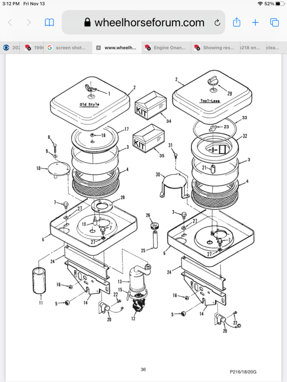

lynnmor 8,842 #24 Posted November 13, 2020 It sounds like you are on the right track, but I am confused about the rubber part. I didn’t know that system was used on the 520s. Onan made some changes about the time yours was built, thus the need for a photo. Share this post Link to post Share on other sites
