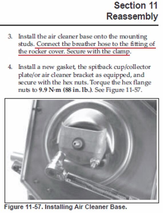

WHwest8597 85 #1 Posted October 23, 2020 I need some guidance on where the breather hose from the head cover goes. I had to reseal my head cover and can't remember where the hose goes from the cover. Share this post Link to post Share on other sites

gwest_ca-(File Mod) 12,149 #3 Posted October 24, 2020 From the service manual will guess this is the hose page 11.17 Garry 1 Share this post Link to post Share on other sites
