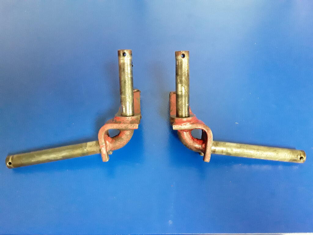

midpack 1,148 #9 Posted October 23, 2020 I have one that came on a C-175 that had z loader on it. Re-enforced bonds on the spindles. Longer shafts for wheels. Wider wheel hubs. I thought about selling/trading it but I ended up putting it on my 417 because wheel weights have to have a larger ID and my 417 is a mower only at this point Share this post Link to post Share on other sites

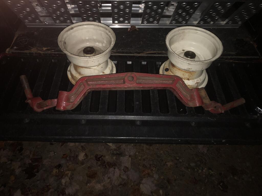

WheelhorseBob 1,550 #12 Posted October 24, 2020 (edited) Well I went and got the “C series HD front end kit”. I knew right away it wasn’t that.... looks to be a new old stock D series front end....what to do with it? Edited October 24, 2020 by WheelhorseBob Share this post Link to post Share on other sites
oliver2-44 11,734 #14 Posted October 24, 2020 I don’t see what’s Heavy Duty. The spindles look to be 3/4” and the wheel bearings look to be 3/4” ID? Share this post Link to post Share on other sites
WheelhorseBob 1,550 #15 Posted October 24, 2020 If you look at the photo I posted, the spindles and wheels are 1”. But again it appears to be from a D series. It is new old stock, appears to have never been on a tractor so maybe it is something someone can use.. Share this post Link to post Share on other sites

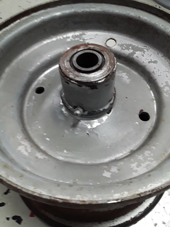

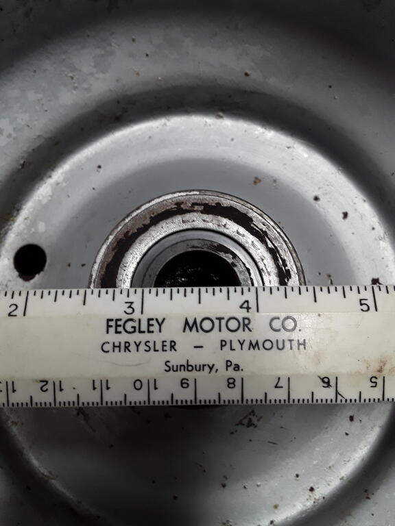

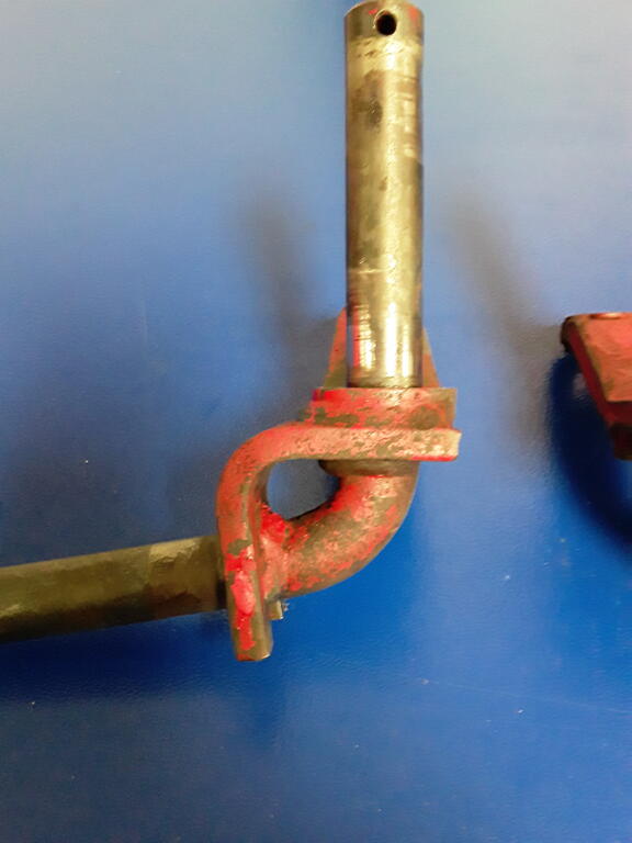

midpack 1,148 #16 Posted October 24, 2020 7 hours ago, oliver2-44 said: I don’t see what’s Heavy Duty. The spindles look to be 3/4” and the wheel bearings look to be 3/4” ID? The bend on the spindle has a reinforcing plate welded on, the shaft where the rim mounts is longer (wider hub on the rims). The wheel bearings are larger OD, with presumably larger balls. The front weights I have don't fit over the hubs. I found out about them when I tried to swap a better rim/tire from the HD front to another machine. Was like WTF?!? Share this post Link to post Share on other sites
wh500special 2,455 #17 Posted October 24, 2020 I haven’t seen reference to the c-series heavy front end kit in a long time. Used to be a common discussion topic 20 years ago. It was a great value and came with two reinforced spindles as shown above and a new set of tires mounted on wheels. I think it was priced cheaper than just buying two tires. It was available for a long time. I’ve seen them with both linen beige and silver painted wheels. Always intended for when a tractor was equipped with a loader. I bet there are still a bunch of these kits on old dealer shelves. The d-series axle kit is interesting too. The 1973 18-automatic and the earliest D’s used 3/4” spindles and front wheels. They were marginal for such a portly machine so were upgraded in ‘74/‘75...don’t remember exactly. The kit you have was the factory retrofit kit to fix the marginal design. I don’t think there was a “recall” for the upgrade, but I am pretty sure I recall the upgrade being free to customers that had a problem. The difference between 3/4” and 1” doesn’t seem like much, but it represents about a 78% boost in load capacity for the front axle and wheels. it isn’t unheard of for front spindles to bend severely and even snap off on the early D’s. I knew of one that broke while mowing when the front wheel of the 18-auto hit a Small rut. Wheel snapped right off cleanly. putting a loader or snow thrower on a 3/4” spindle D is a gamble. I know they have their followers, but I’m not a fan of the D-auto series. They were physically big, but didn’t really bring much to the table in capability compared to the C-series. regardless, you’ve got a neat find there. steve 2 Share this post Link to post Share on other sites

76c12091520h 4,284 #19 Posted October 25, 2020 13 hours ago, midpack said: The bend on the spindle has a reinforcing plate welded on, the shaft where the rim mounts is longer (wider hub on the rims). The wheel bearings are larger OD, with presumably larger balls. The front weights I have don't fit over the hubs. I found out about them when I tried to swap a better rim/tire from the HD front to another machine. Was like WTF?!? The spindles are also reinforced around the holes that the tie rod ends bolt to; commonly worn egg shaped on older tractors, these spindles came off of a 2000 hr unit and show hardly any wear. Share this post Link to post Share on other sites
