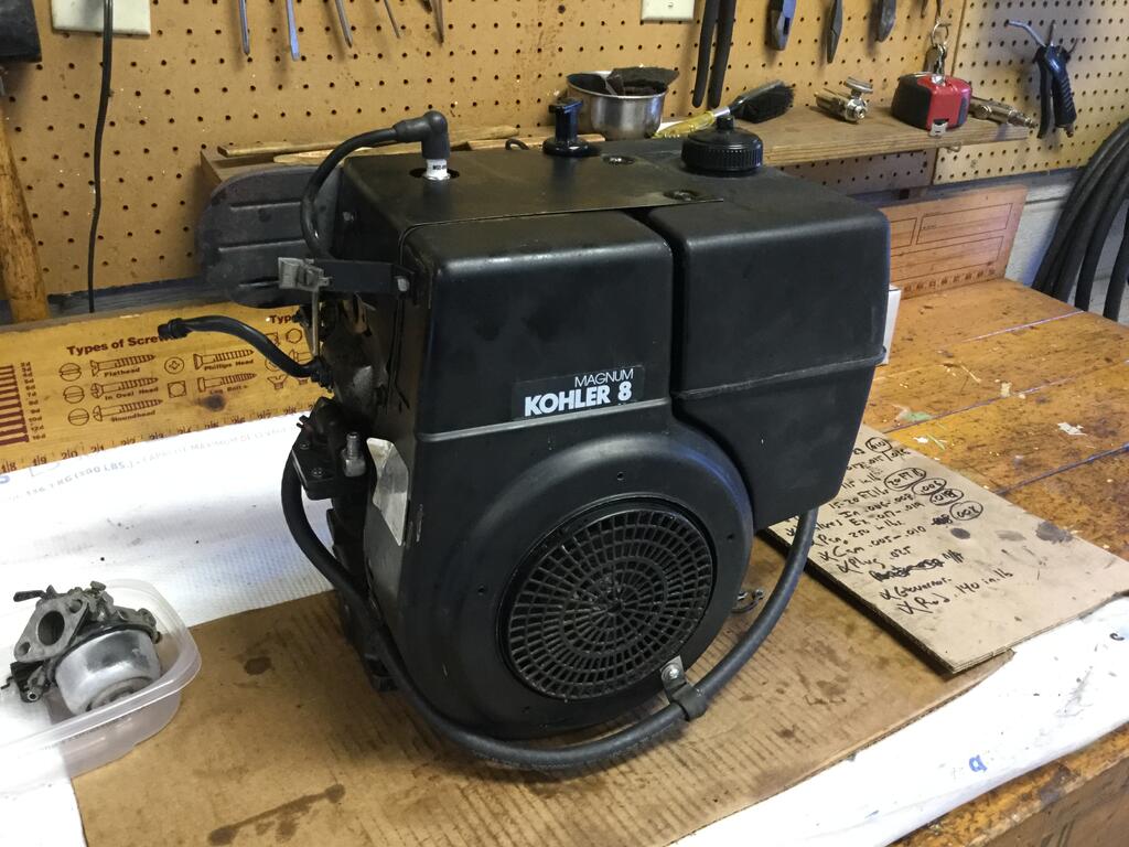

The Tuul Crib 7,354 #4 Posted October 23, 2020 So the motor is a magnum 8 Great little motor. Not bad for 50 bucks! and it has an eight speed! Nice find 1 Share this post Link to post Share on other sites

Jimmy0331 27 #10 Posted October 23, 2020 Your engine looks great by the way. Share this post Link to post Share on other sites
