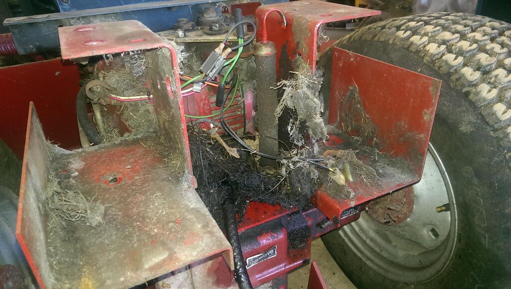

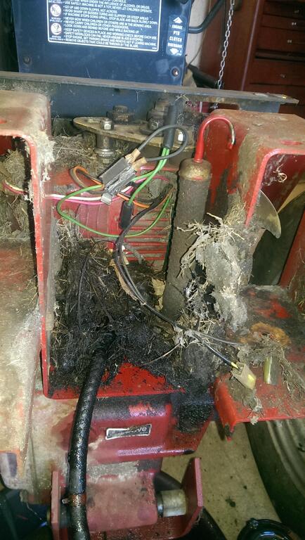

squonk 48,164 #2 Posted October 22, 2020 Sounds like it may be getting tired. Are the trans fins clean? You may need to pull the fender pan and really give it a good cleaning. Use Mobil 1 in the trans and a Napa 1410 filter 2 Share this post Link to post Share on other sites
953 nut 69,560 #3 Posted October 22, 2020 10 hours ago, JohnD said: pulling a load of about 200 pounds of wood on a trailer up a (12 degree?) hill the other day with my C-175 with a KT17 and an Eaton hydrostatic. You never mentioned the throttle position. With a Hydromatic you should be near wide open throttle at all times to have proper cooling and pressure. Oil and filter change would be a good investment and as Mike said, clean the cooling fins and be sure the cooling fan is in good condition. 2 Share this post Link to post Share on other sites

JohnD 145 #6 Posted October 22, 2020 Thanks all. I had the fenders off last week while I was checking for leaks. I have a minor leak at the lift control that leaves me a few drips on the ground the next morning, but nothing that has lowered the trans fluid level. I checked the advancing plate; it looked like it was working properly. I'll check it again. I didn't mention that this tractor does run fast on flat ground (at least it did before I had the fenders off!). Interesting comment about not using a Kohler filter on the transmission... I wonder why the PO did that. This will be a good weekend for a transmission fluid change. The plows probably going on too as they're starting to hint at snow in October. Share this post Link to post Share on other sites
