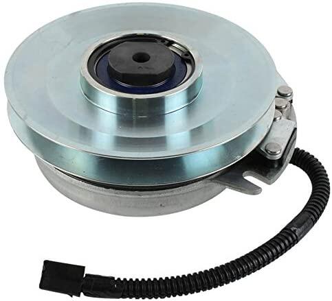

shallowwatersailor 3,221 #20 Posted October 26, 2020 (edited) 15 hours ago, Skins said: When I got in garage a saw that wires were pulled out of connector for electric PTO clutch. Attached wires again at pigtail and saw entire PTO clutch turned and pulled out wires again. Not at clutch itself but at pigtail connector. Was wondering if you know if these electric pto clutches can be fixed or rebuilt or am I looking at a new one. I plan on getting this thing working right no matter what it takes. From what you wrote, it sounds as if your entire PTO assembly is rotating. There is a bracket (if I remember correctly) that is bolted to the engine block. I think that this is a picture of the PTO for your tractor. Edited October 26, 2020 by shallowwatersailor Share this post Link to post Share on other sites

Skins 3 #25 Posted October 27, 2020 8 hours ago, shallowwatersailor said: From what you wrote, it sounds as if your entire PTO assembly is rotating. There is a bracket (if I remember correctly) that is bolted to the engine block. I think that this is a picture of the PTO for your tractor. Thanks for the info. My clutch is aftermarket as it has a date code of 2004 but looks very similar. What I didn't realize at first is that there's a small tab that comes down from the muffler shroud and fits into slot on clutch. Kind of embarrassing that I missed that but I'm learning. Only had it a little over a week. It was kind of an impulse buy, but I have no regrets. I can't believe how solid these tractors are. Makes my newer Cub Cadet seem like a toy. Share this post Link to post Share on other sites
