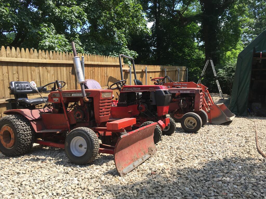

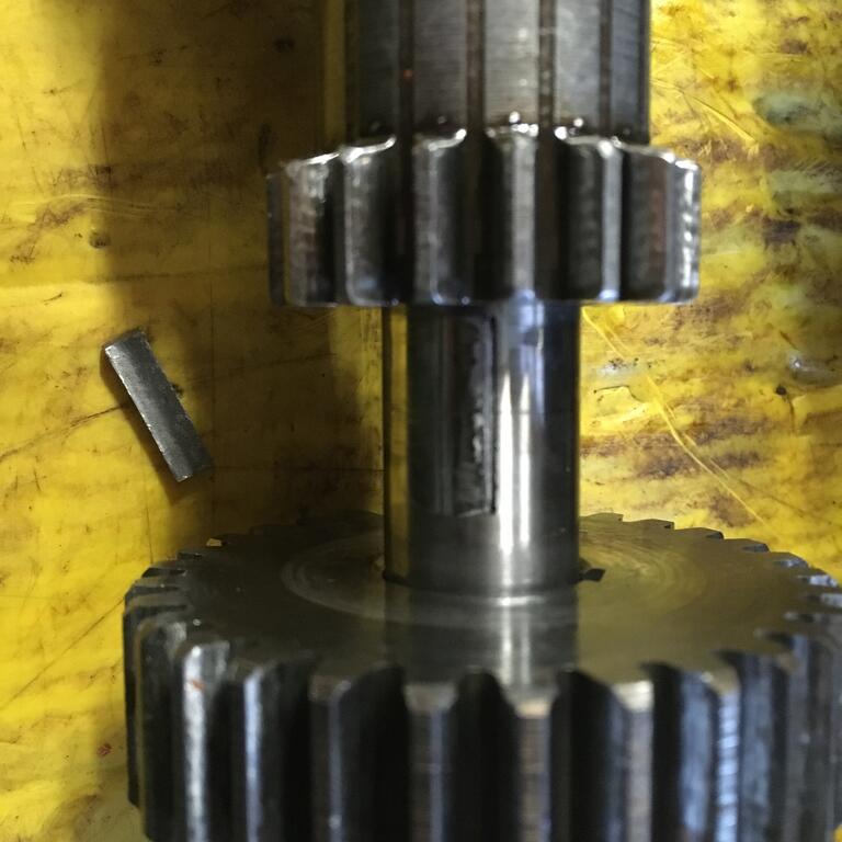

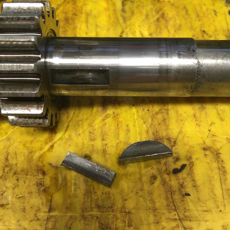

roadkillinct 58 #13 Posted October 21, 2020 Ding Ding Ding Steve is the winner which is appropriate as the tractor's name is Steve the woodruff key was sheared off on the cluster gear shaft as u can see in the pictures.I added a few pics of some of my other toys . The 69 Charger came with a Electro the tires were all flat with some off the rims don't know if the guy gave it a new name or the letters just got worn off eel hor is what I call it. I saved the 16 automatic from the scrap yard someone just dropped if off it's a nice tractor the sheet metal is all straight. It had been sitting for a long time the carb bowel had a hole in it also the exhaust valve was burnt. I ground the valve by putting in my drill press and ground it down with a piece of sand paper stapled to a block of wood even surprised me when I lapped it in very nice mark in the center of the face. Thanks for all the replies 4 4 Share this post Link to post Share on other sites

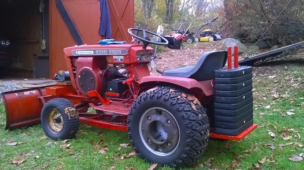

pfrederi 21,007 #15 Posted October 21, 2020 That is a lot of weight on the stern How much...There are limits for even for WH transaxles... Share this post Link to post Share on other sites
ebinmaine 80,116 #16 Posted October 21, 2020 4 minutes ago, pfrederi said: That is a lot of weight on the stern How much...There are limits for even for WH transaxles... Looks like no more than a couple hundred pounds. My own "me" is that and then some.... Share this post Link to post Share on other sites
pfrederi 21,007 #17 Posted October 21, 2020 5 minutes ago, ebinmaine said: Looks like no more than a couple hundred pounds. My own "me" is that and then some.... plus wheel weights and then running into an icy snow pile...something has to give.... 1 Share this post Link to post Share on other sites

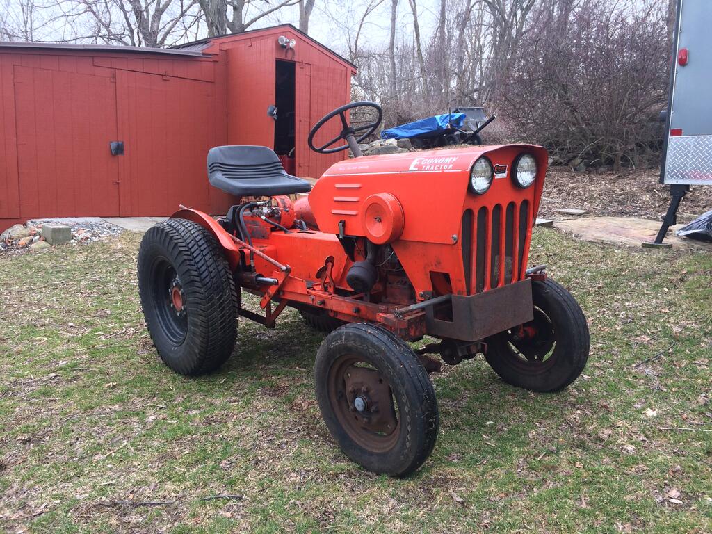

roadkillinct 58 #19 Posted October 22, 2020 If i remember right each one of those weights are 12.5 lbs what u don't see is the tires are filled with RV antifreeze. That tractor will moved the snow ,my driveway is slanted down to the road at a pretty good grade hence all the weight. My neighbor gets a big kick out of the tractor I really have to pay attention because it will climb a pretty good size snow bank and then get hung up. Here's a pic of my Power King that I mentioned before. 2 2 Share this post Link to post Share on other sites
stevasaurus 23,786 #20 Posted October 22, 2020 That is the first time I have seen a key from the cluster gear shaft do that. Out standing that you found it. Share this post Link to post Share on other sites
roadkillinct 58 #21 Posted October 22, 2020 Steve, I have never seen anything like that either, was looking for shavings, pieces or some signs of damage. If u look close at the key it sheared off at a perfect concave shape probably partially caused by spinning around the shaft. I hope this helps others down the road. 2 Share this post Link to post Share on other sites
