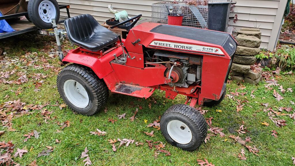

bds1984 1,395 #1 Posted October 21, 2020 I recently picked up a very straight C175 Auto with a gray Series II that runs great. I would like to add an oil filter to it but locating a part number for that piece is like hunting for a snipe. Can one take the oil filter plate from any Magnum twin and use it on a Series II? Share this post Link to post Share on other sites

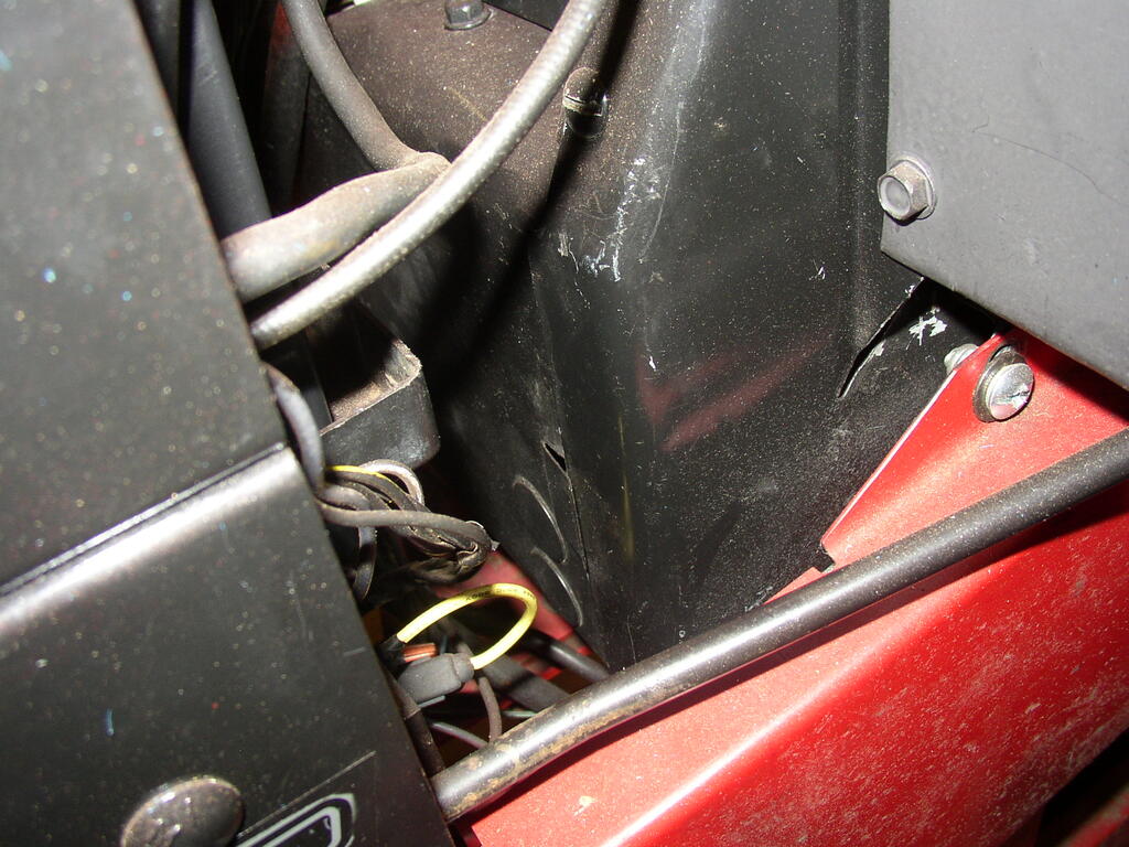

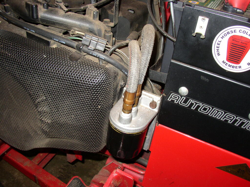

SPINJIM 1,978 #2 Posted October 21, 2020 I knw that the KT17 had pressure lubrication on the Series II, but didn't know it could have a filter, since mine does not. But I see that there are two holes in the sheet metal where a filter can be attached (1st picture). My magnum M18 has a remote filter kit attached through those holes (2nd picture). If you can find that kit from a Toro dealer or on ebay, that might solve your problem. It also has the advantage of allowing better air circulation around that rear cylinder. Good luck. Jim 2 Share this post Link to post Share on other sites
bds1984 1,395 #3 Posted October 21, 2020 I am told that not all KT17 Series II engines have the provisions for adding an oil filter. The engine I have has the removable block-off plate but what I don't know is if the oil filter adapters are the same between the KT series and the Magnums. I can find part numbers for Magnums but not for KTs. I have a remote filter like yours on an M18 powered 520H which is what I'd like, but I don't feel like spending the coin to install one on this engine when I can get an adapter plate for $10. The tins on this KT17 don't cover up access to where the oil filter would be like how your M18 is. Share this post Link to post Share on other sites

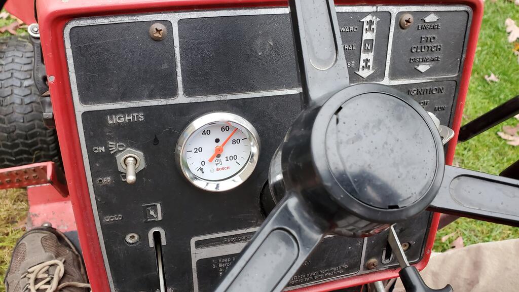

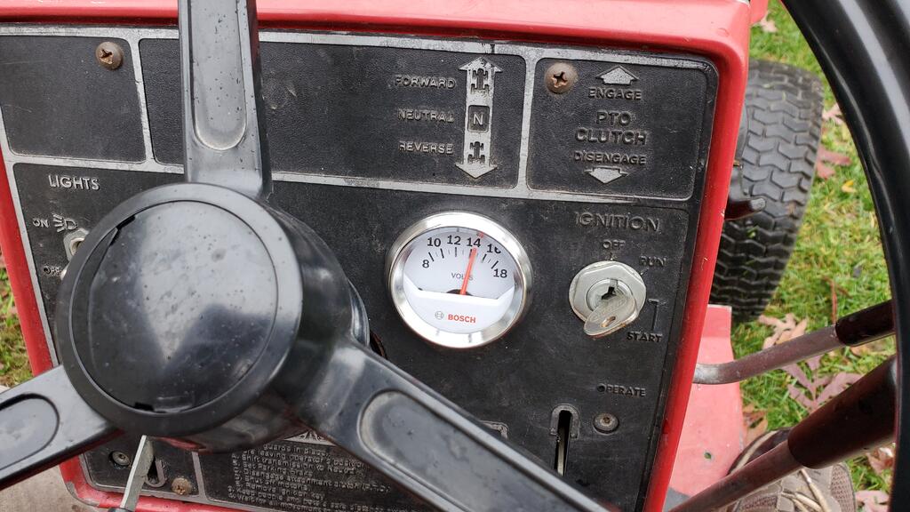

bds1984 1,395 #9 Posted October 23, 2020 Thanks for the link. The manual I was thumbing through must have been published between the original Series I and the one you linked above. I have a filter plate coming that will hopefully be here within the week. In the mean time I serviced out the engine and installed a matching oil pressure and voltage gauges. 70 PSI of pressure on hot 10W30 is pretty darn good. 1 Share this post Link to post Share on other sites
