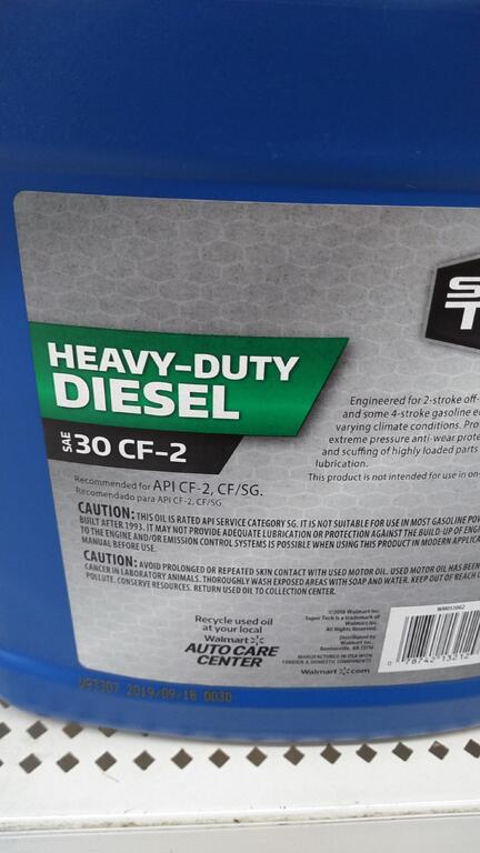

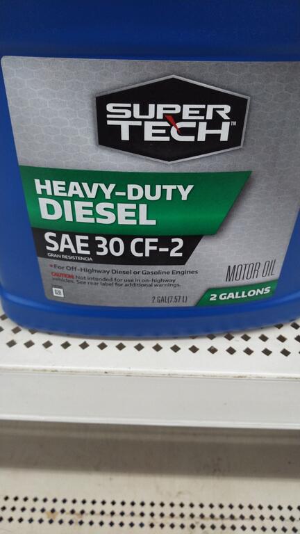

Bill D 2,998 #1 Posted October 21, 2020 I found this oil at Walmart. Cheap and rated SG. Is anyone here using it? I didn't buy it yet. I would like some opinions on it first. Thanks. Bill Share this post Link to post Share on other sites

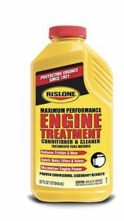

The Tuul Crib 7,354 #6 Posted October 21, 2020 Bought some of this for my truck the other day. I treated my 414 to a couple tablespoonz! 1 1 Share this post Link to post Share on other sites

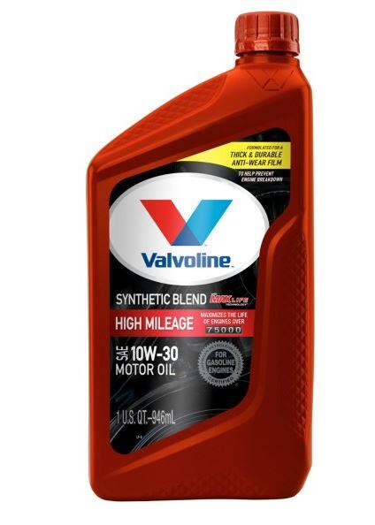

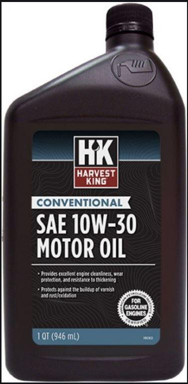

bottjernat1 2,196 #9 Posted October 21, 2020 (edited) You use what works for you. Everyone lives in different environments and uses there equipment in different ways. My late dad was a Pennzoil guy. I use what ever is cheap and works. Currently i live in northeast indiana and i dont use my machine to any where near there intended purposes. I use Rural King oil Harvest king sae 30. I use it in all my old iron horses and deere. Except my 2010 JD x540 I used valvoline max life 10w30 it calls for a high class oil because deere's are snobby you know. . My late dad used sae 30 all year around and we never blew a gasket or had other issues. Dads theory on the old single cylinder engines along with other garden tractor guys around my area also agree. The engine will get just as hot in the winter if not hotter if snow gets up in and around the engine while your working it so just stick with the oil that is thick and will take the abuse. I also have not had any issues due to the oil i use. My big d series i used harvest king sae 10w30. Im thinking next time i may use the max life on the d160. Any Thoughts on using max life in the d160? My question is what is the big diference in oils besides thickness or coating potential? Edited October 21, 2020 by bottjernat1 Share this post Link to post Share on other sites

Bill D 2,998 #14 Posted October 21, 2020 I only asked because I have an M12 with 1300 hours that's burning alot of oil. I thought maybe I would just feed it the cheap stuff until I can scare up the cash for a rebuild. Bill 1 Share this post Link to post Share on other sites
ebinmaine 79,740 #15 Posted October 21, 2020 1 minute ago, Bill D said: I only asked because I have an M12 with 1300 hours that's burning alot of oil. I thought maybe I would just feed it the cheap stuff until I can scare up the cash for a rebuild. Bill Given that particular scenario I would absolutely run inexpensive oil. I've not tried to concentrate on the pictures you posted. Does it by chance list the quantity of zinc or phosphate? I asked that mostly out of curiosity but I would still use that oil... Share this post Link to post Share on other sites
Bill D 2,998 #16 Posted October 21, 2020 (edited) I has the older SG rating. Most small engine oil is SJ rated. It should have plenty of zinc with that designation. It's my understanding that this oil is made by Warren Oil company. Don't know much about them. This M12 still makes good power in spite of how much oil it uses. Edited October 21, 2020 by Bill D 1 Share this post Link to post Share on other sites
ebinmaine 79,740 #17 Posted October 21, 2020 49 minutes ago, Bill D said: I has the older SG rating. Most small engine oil is SJ rated. It should have plenty of zinc with that designation. It's my understanding that this oil is made by Warren Oil company. Don't know much about them. This M12 still makes good power in spite of how much oil it uses. Without posting a link can you give me a rough idea how much that stuff is per court or whatever? I think I'm paying something like $4.50 a quart for Kinetix brand oil which supposedly has the correct amount of zinc.. Share this post Link to post Share on other sites

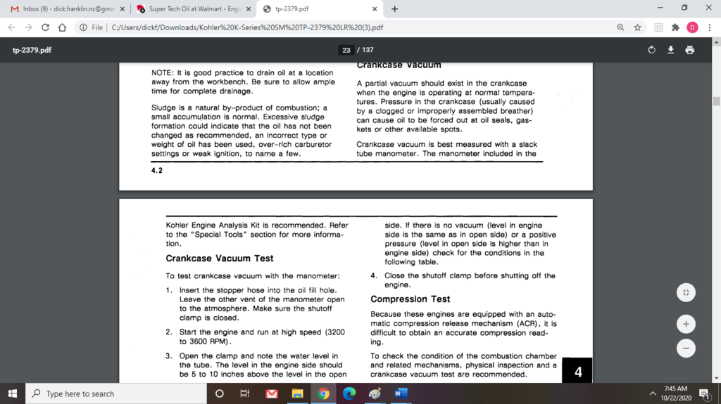

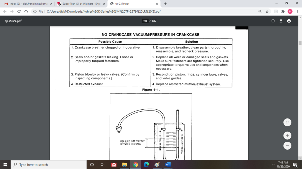

roadapples 6,987 #18 Posted October 21, 2020 Make sure the breather below the carburetor is not clogged. 1 1 Share this post Link to post Share on other sites

Bill D 2,998 #21 Posted October 21, 2020 (edited) I think this product has been discontinued. The stuff I saw on the store shelf is probably the last they had. Edited October 21, 2020 by Bill D Share this post Link to post Share on other sites

953 nut 67,493 #23 Posted October 22, 2020 18 hours ago, roadapples said: Make sure the breather below the carburetor is not clogged. If the crankcase vent is not open the pressure can lead to oil consumption. This information is from the troubleshooting guide of the Kohler Service Manual in our manuals section. 1 1 Share this post Link to post Share on other sites
